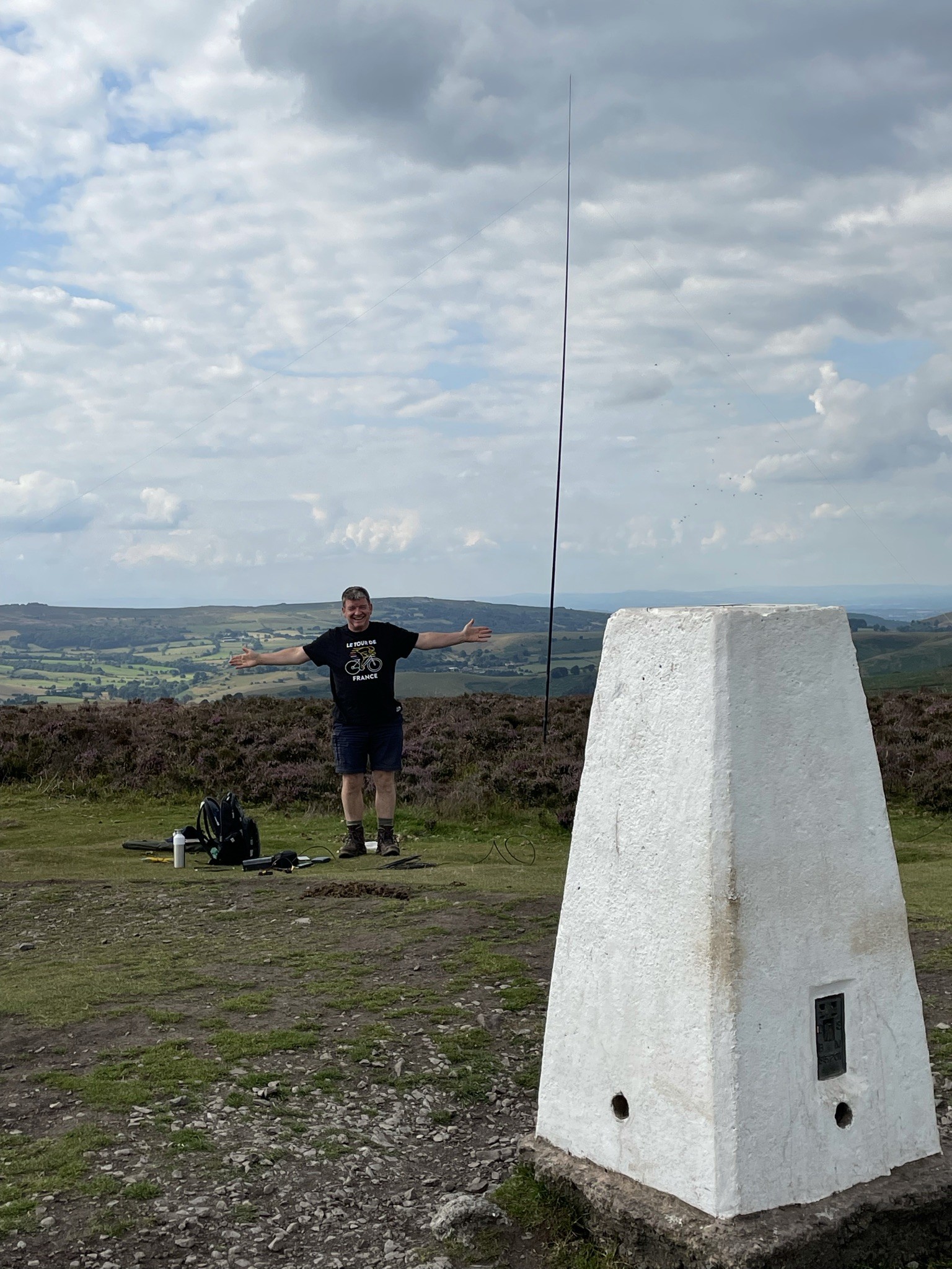

We have just been spending some days with our caravan in Shropshire in the UK, and it seemed an ideal time to try activating a summit.
The summit I chose is G/WB-005 - Pole Bank on the Long Mynd near Church Stretton. The car park is about 0.5km from the summit, and about 40m below. Not such a challenge to get up (I hear you say!), but for a first activation to check out equipment and procedures, it’s enough!
I am using a recently purchased new-to-me KX3, and an EFHW antenna in inverted V format on a 7m pole. I used a carbon fibre stake to support the pole, but this will change in the future to guy lines. I wouldn’t like to have to carry the pole up a big hill, and I suspect it will be difficult to hammer it on more rugged summits.
First challenge was spotting myself. I have been using sotawatch on my desktop computer, and while I had setup and logged into sotawatch on Outd Log on my phone, when I entered the spot details it informed me that the spot was unsuccessful, but without an error message. I then went to sotawatch on firefox on my phone, but had some challenges with the password and username. Eventually I got in, and entered the spot. I then received an error - saying the frequency was invalid and needed to be entered as MHz. This was probably the reason I had failed with outd log in the first place.
After successfully placing the spot, I started making contacts - 5 in quick succession! Thanks guys! After it quietened down, I spent some more time calling CQ, then moved to 40m. I spotted the new frequency (this time on outd log), and made a further 2 QSOs.
So, happy with the first go at activating a summit, and now I will review my equipment and start to activate some of the summits local to my home in North Wales.
