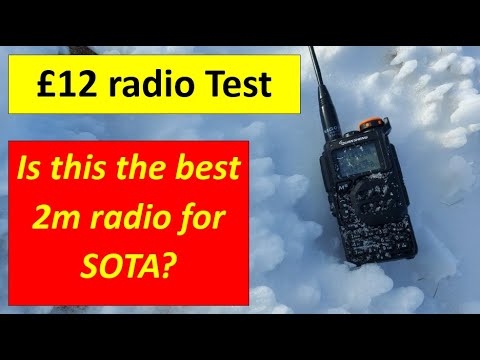

Yes, but to a point. The one I had a play with while parked about 1 mile from Billinge Hill had really bad de-sense and breakthrough especially on a ā€˜proper’ antenna (mobile whip on car). For summits without any other transmitters I think for the price its pretty good as a a lose-able / drop into a crevasses and not care too much radio.
It does require a firmware update to add features such as an S-meter, but I see this ability to add/remove features as a plus.

I can absolutely see that happening, but no worse than my Yaesu FT3d, which cost at least thirty times more. I do plan on testing mine on an RFI-rich SOTA summit to see how it gets on, both with and without a SotaBeams filter.

It’s a pity that list hasn’t been kept up to date. Handheld radios are a very emotive subject for us Hams, possibly because many of us start off the hobby with one as our first radio. Now a days the price range goes from Ā£10 to Ā£600, ie the Quasheng UV 5K through to the icom id-52e. We’re all aware from reports on here that performance doesn’t always follow price. My own Yaesu ft-3d is terrible anywhere near masts or ABZ airport.
I bought the UV 5K because it was Ā£12 delivered, it has some nice features as well as a community which has sprung up around this radio. It is something I can experiment with, measure and field test with no risk to my wallet. The choice of firmware available is staggering. It’s no risk too - if it doesn’t work, simply re-flash with the factory one and all is good. Just last night I saw a video of someone recieving 10m SSB and CB from the USA on one using a long whip. I think they are getting really popular with SWL’s.
To the point, what is the best SOTA handheld? Yeah, probably one you can drive a truck over, smash off a rock when you swing your pack off your back and dump it on a summit, forgetting the radio is strapped to the pack. One that can handle weather, has a decent battery, a simple display that is easy to read in all lights. Easy to operate with gloves eg how many menus to adjust the squelch v. turning a knob. Is RF de-sensing important? Absolutely. Out of band emissions? Without a doubt. Does a SOTAbeams filter need to be factored in as part of the cost? Almost certainly.

I would tentatively add a +1 to Fraser’s recommendation for a Quansheng UV-K5 (8). (I do need to do a bit more testing with mine - so far I am quite pleased with my Ā£10 investment).
I activated GW/NW-042 at the weekend solely using this handie with its standard antenna. I didn’t appear to have any issues with QRM from Cyrn-y-Brain, which I had suffered from on previous activations in the area using my older Baofengs. I made almost a dozen contacts on 2m quite easily.
I’m heading up to the Lakes this coming weekend, so the Quansheng will be joining me. I’ll provide further feedback on it, if I identify any issues.

I just got mine for £6.83 and am really happy with it. Did you get any QRM issues ?
Hiya Michael,
No issues with the handie on 2m at all. I made contact with Geoff @GM4WHA near Annan, followed by Dean @M7DSU (whom I had a good 10 minute+ chat to, because he was also using a Quansheng like mine). I just used the standard antenna it came with - we were too cold to put up the slimjim, in fact Nic had already walked off the summit to get down into the sunshine…
