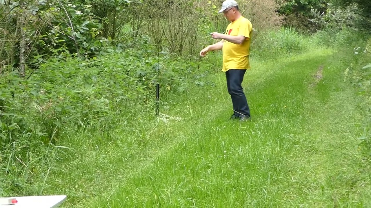

It takes me just under 4 minutes to set up my HF station, and that is when I don’t hurry :grin:
see:
The trick is to buid a “go-box” with everything connected, ready to use : rig, battery, internal or external tuner if needed, key / mic / phones.
Only the antenna coax has to be connected in the field.

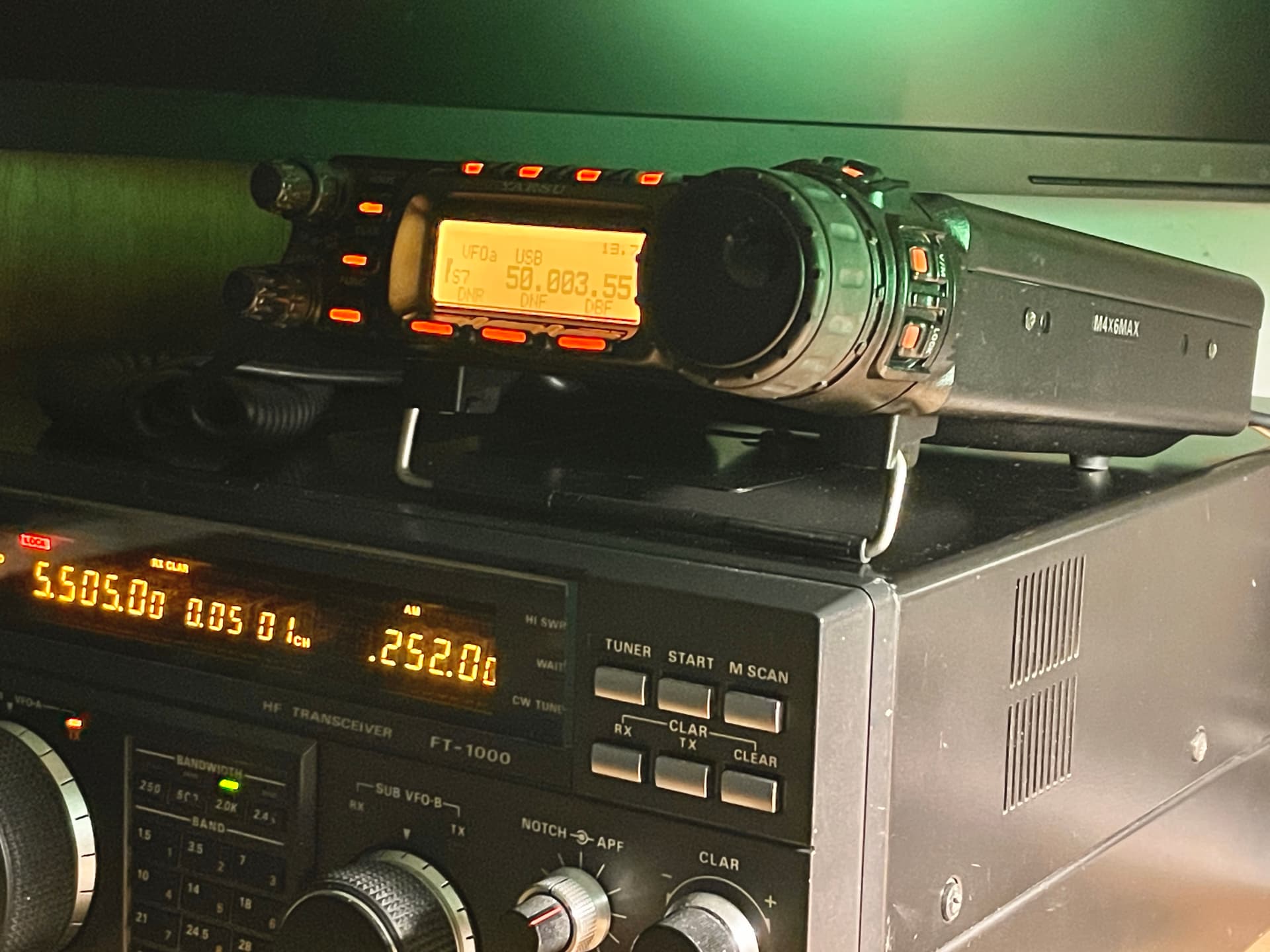

Yes, I’ve happily use mine for a dozen of years and only put it aside after getting my hands on FT-1000d and even then was reluctant to sell it for over a year :slight_smile:
Did you get a Yaesu hat? I have two Yaesu radios and no nerdy hat. :sob:
No :slight_smile: Not a Yaesu fan as such, but their radios are okay :slight_smile:
I have three now: 1000d, 857d and 60E

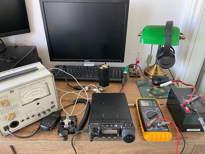

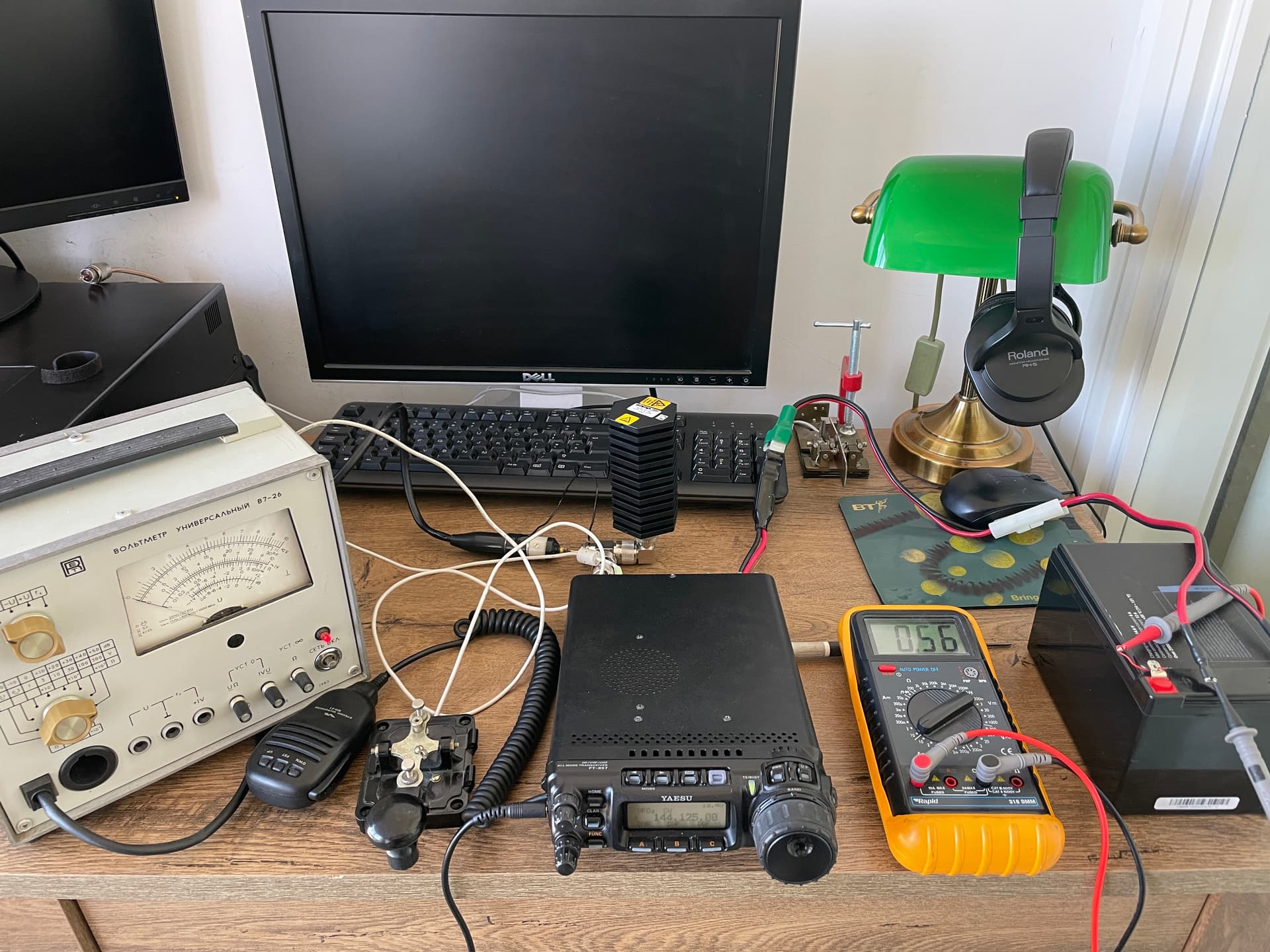

Slowly making ready my FT-857D, I’ve made some RX/TX current draw measurements. Perhaps that could be usefull to have here.
That is what I’ve got on RX:
Turned ON / loudspeaker: 0.6A-0.9A, sometimes floating randomly within this range.
Turned ON / phones connected + display illumination off: 560mA achievable minimum
Turned OFF: 7.5mA
Display illumitation: saves aprox. 90mA
Connecting phones: saves aprox. 200mA
Running fan: adds aprox. 100mA
VHF/UHF TX test:
2m FM/CW
5W - 3.0 Amp
10W - 3.7 Amp
25W - 5.6 Amp
50W - 8.4 Amp
70cm FM/CW
2W - 3.5 Amp
5W - 4.7 Amp
10W - 7.0 Amp
15W - 10.0 Amp
20W - 15.6 Amp
HARK! Is that a straight key I see before me for some 2m CW?! :heart_eyes:
It is, a good old Soviet key :slight_smile: Not sure if I can use a straigth key in a field though! I’ll try it for sure as have no field suitable paddle, but sending quality may likely suffer.
Returning to consumption, I was pleased to learn that on VHF/UHF FT-857 current is on par to my current Kenwood TM-V71. So at least I have a peace of mind there in case of sticking to V/UHF only.
FM modulation looks to be sligthly better as well.
