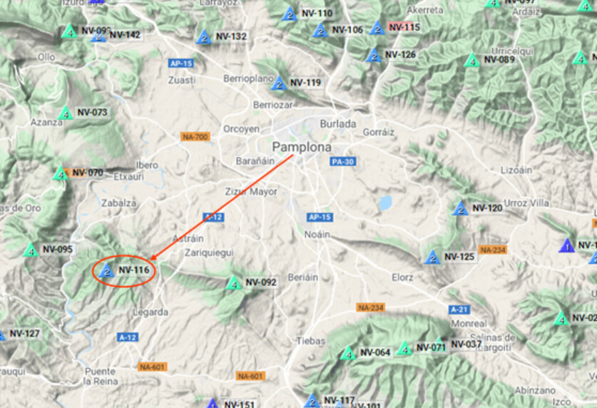

Mt. Iriberri EA2/NV-116 by EA2IF/P on 13/08/2021
This is the summit I activated today.
It usually has QRM problems from the close by WPG (Wind Power Generators) but this morning there was no wind and they were still, so I decided to take advantage of such unusual situation and give it a try.
It’s location is about 15 Km South-West of Pamplona, being the last 3 or 4 Km driven on AWD 4L through a service dirt road for the WPG farm. This service dirt road can be perfectly driven on a 2WD in summer time. Not in winter when snow and ice may be and is sometimes present.

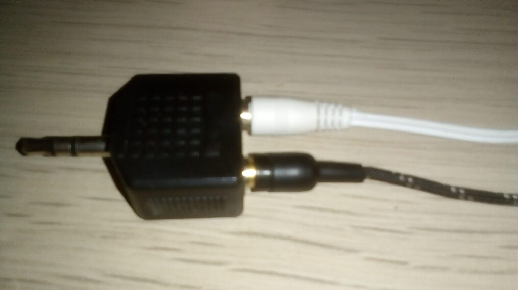

During my HF activation under the Sun, I experienced a problem that I have been having some times in previous activations, but it was even more severe today. The problem is that sometimes the AF output is vanishing and sometimes completely disappearing. Sometimes I lost completely the audio signal on my headphones, not only for my morse side tone but also for what it was being received on the band.
Touching buttons, sometimes made the sound get back partly or completely, but it would soon vanish again, forcing me to try again touching buttons. Sometimes moving the AF gain (volume knob) made the trick, some others didn’t and it was touching the band change button. Some other times it was touching the VFO/M button, some other times it was touching the band change button. Some other times there was nothing I could touch to get the sound back into my earbuds and I just kept CQing blindly (deafly) until the sound of my morse side tone spontaneously got back.
This problem has happened some times in the past recent activations, but it was particularly severe today and I wonder whether the high temperature and the hammering Sun was the one to blame.
Not many weeks ago, I made a joint activation with my friend Javier @EA2GM. He operated with my rigs and he noticed this same problem of the AF gain vanishing or getting notably reduced. He told me that he was also experiencing that same problem with his FT-817 and I wonder whether some of the readers in this reflector have ever experienced or ever heard about this problem and a solution.

I once had an issue similar to yours with my '817 which fooled me for quite a while… I eventually realised that the problem was due to a broken wire in the headphone lead… the slightest movement could cause the audio to randomly disappear, or reappear :-s
73 Paul G4MD
Thanks for your feedback, Paul. I hope it’s just as simple as that. I’ll do some checks tomorrow and I’ll let you all know my findings.

Hi Guru,
I had a similar problem with my 817ND, intermittent audio, or low and distorted. I thought it could be a faulty speaker (it seemed to work OK on headphones) but difficult to prove as it rarely happened. I fitted a new speaker and it has been fine since. However, I couldn’t find anything wrong with the old one, so I suspect it was something else.
Sorry, that probably doesn’t help, but you are not alone!
73, Adrian
Thanks, Adrian, for your feedback. I have known of some other FT-817 owners who had to replace the speaker. I never use the speaker, as I always have a couple of earbuds connected to the headphones socket with a splitter. First thing I’ll try tomorrow is removing those earbuds in order to check if the problem arises when using the speaker. I’ll also check if the problem happens when using just one set of earbuds without the splitter. Preferably, I’ll try a different set of earbuds, not the ones I currently have fitted in.
However, the fact of managing to get the sound sometimes back by touching some of the knobs and buttons of the rig and even switching off and back on the rig, makes me suspect that it’s not going to be anything related to the earbuds wire or jack, but something in the internal circuitry, which is not good…

This man of steel is nearly reaching his melting point today with 35.6ºC right now in the outside. I’ve spent some hours out in a terrace this appartment has in order to investigate the problem with the audio signal being reduced and even disappearing, as well as the other problem of high SWR when transmitting on 2m FM. I’ve been all the time sweating because of the extreme heat, but I’m happy to tell you that the problem has been solved.
In my case it was as simple as a random bad contact at the splitter jack and my touching knobs and buttons on the rig did cause slight movements which made the bad contact get sometimes good. I could verify very well that it was just that:
Long time ago, when I started going with my friend JAP to activate SOTAs, I installed this splitter in order to have 2 sets of earbuds always connected, one set was the one I always use and the other set was for my friend JAP and other possible visitors.
After finding today that the root cause of the audio problems was a bad contact at the splitter jack, I’ve just removed it and left one single set of earbuds for me, as it was in the very begining. So problem solved and the audio of my FT-817ND sounds again loud and clear. Pfew!!! :sweat_smile: :smiley:
