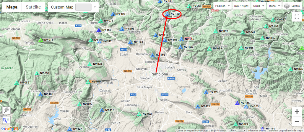

This is it’s location to the North of Pamplona at 18Km from my QTH:

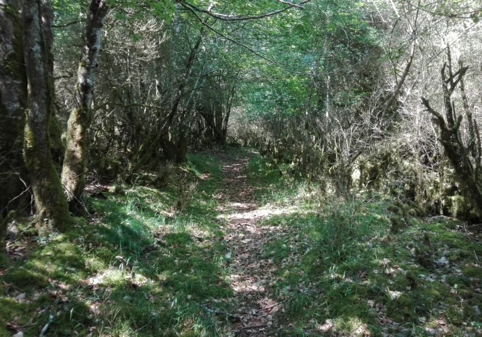

The ascent was through dense forest and quite steep at times:
>El ascenso fue a través de denso bosque y bastante empinado a veces:

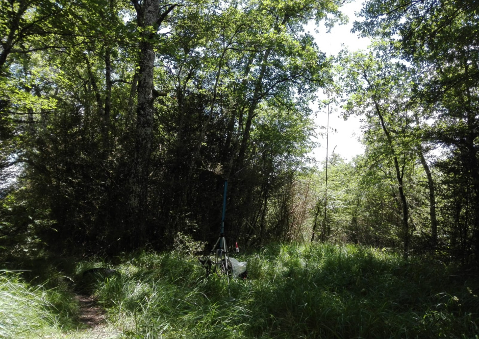

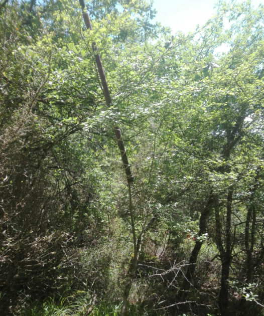

I tied my fishing rod to a young tree trunk like this as a way to try to get the top end as high as possible:
>Até mi caña de pescar al tronco de un joven árbol de esta manera para intentar tener el extremo superior lo más alto posible:
You can see here the final setup and the operating place with no views:
>Pueden ver aquí el montaje final y el lugar de operación sin vistas:
Rig was FT-817ND at 5W + MFJ-941B antenna tuner.
Antenna was 10m long endfed wire as a sloper to a 9:1 unun and 6m long elevated counterpoise wire.
El equipo fue FT-817ND a 5W + acoplador de antena MFJ-941B.
La antena fue un cable de 10m de largo alimentado en el extremo con unun 9:1 y un cable contraantena elevado de 6m de largo.

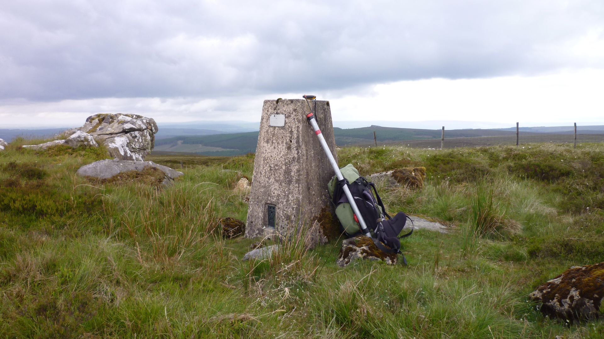

Glad you had a fantastic day. My activation time was somewhat time limited. I run 50Watts and 10Ah of Lipos gives me 2.5 Hrs ops time. Also Sighty Crag G/SB-005 is a hard activation. I will explain.
The drive distance is about 70km each way.
Then we have 10km on a mountain bike uphill on forest roads. (My activation on Wednesday was abandoned due to logging operations. I do not like sharing forest tracks with 30 ton wagons.)
Now comes the fun bit, 1km across cleared forest where every step is very very unsteady.
This is followed by 1km steep up hill, across the worst land in Christendom. Every footstep may be 3 cm down or 1m.
We are now on Sighty Crags, but this is not in the activation zone.
1km to go, but we have to traverse 8 deep cuts in the peat each about 4m deep. We now arrive at Sighty Crag, Phew. Take some photos for confirmation.
Activate (58 QSO’s on 5 bands) and retrace steps.
House to house time 11 1/2 hrs and 2 cw pts gained. But I enjoyed every minute,
Thanks Guru for another S2S
G0EVV/P
