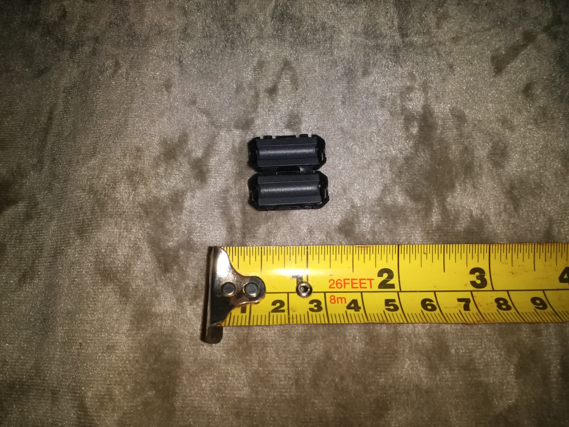

I’ve got some clip on ferrite chokes if want to try adding a couple? Let me know and I’ll pop them in an envelope and drop them off.
Cheers Sean. I think I’ve got some at home so I’ll give that ago. Probably also need to make more use of the 5 metres of feeder cable to get away from the radials. Embarrassingly, I assumed mechanical issues in the paddle or software issues in the Code Cube - but failed to even consider that RF stuff…!

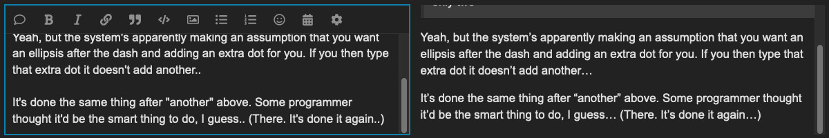

Thanks guys, some good suggestions to work through there. I did enter dot dash dot dot but it appears on here with an extra dot! If I go to edit, it appears correctly. If I remove one dot, then the public view loses two of them! Weird.
Sounds like the web page is interpreting the 3 dots as an ellipsis
There isn’t three dots to interpret - only two.
Do what I did during my Morse Test - send “F”
Examiner noted that I mucked up “F” & “L” but after sending a stream of each he passed me!!!
Yeah, but the system’s apparently making an assumption that you want an ellipsis after the dash and adding an extra dot for you. If you then type that extra dot it doesn’t add another…
It’s done the same thing after “another” above. Some programmer thought it’d be the smart thing to do, I guess… (There, it’s done it again…)
It comes from something to do with markdown processing. I spent 10 mins looking for the option but haven’t found it yet to adjust/disable/whatever.
So if your type dot dash dot dot together you get .-… (i.e. the double dot is made into an ellipsis)
To stop it happening you need to break the markdown with a backslash
dot dash dot dot .-…
dot dash backslash dot dot .-..
You can play about with how a \ inserted next to other characters affects what is displayed.
