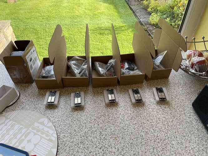

Another batch of trackers being assembled. These will be available shortly at cost to UK activators.
More and more new call-signs appearing :slight_smile: we have a great network going!
Prices for this batch work out to £55 each. This includes:
  • “The Rook” case
  • 1800mAH battery
  • RT18175 FLEXI-SMA-433 RF Solutions Antenna
  • UK postage and packing
I will supply them fully assembled and programmed with your callsign and ready to use.
DM me if you want one [UK Activators only].
