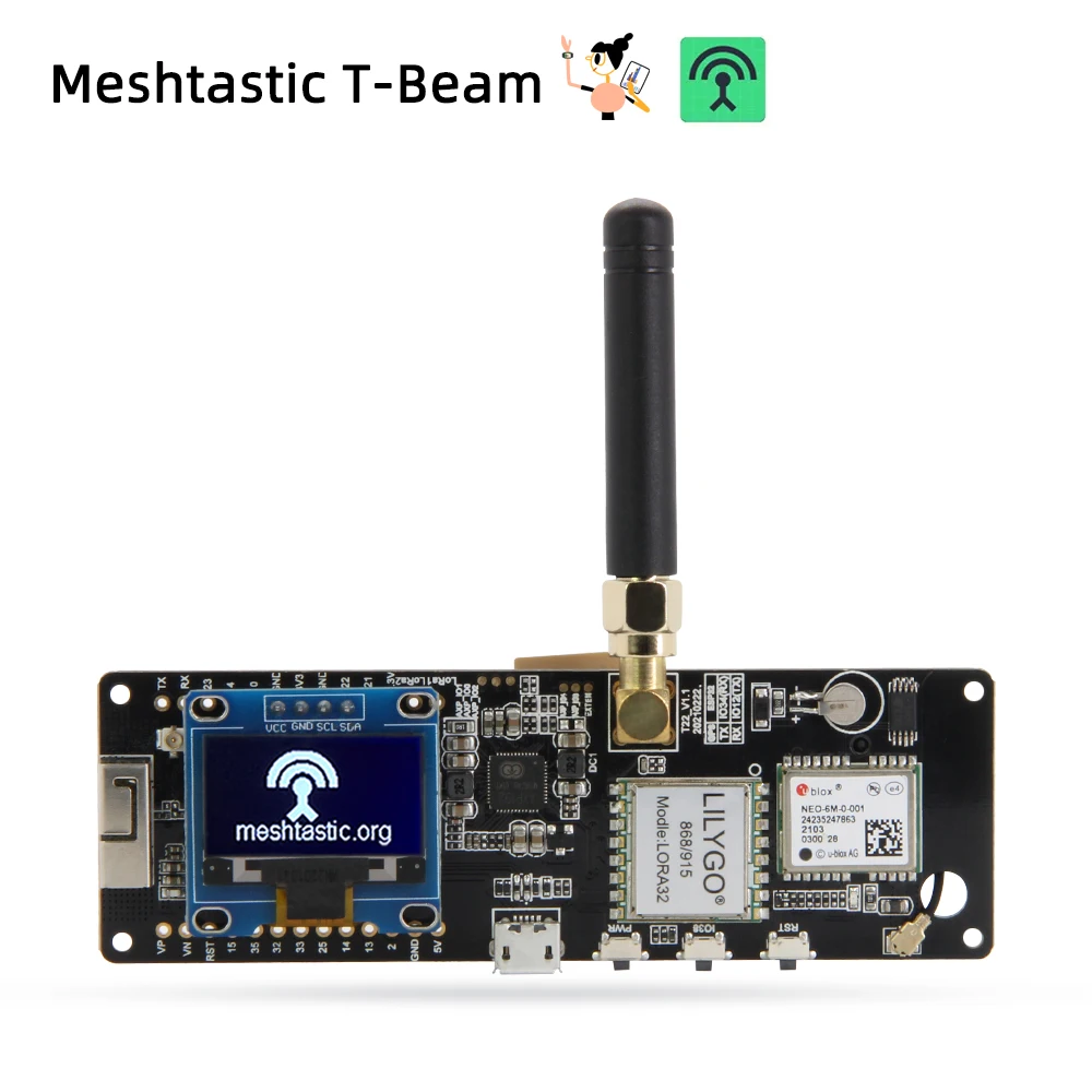

Hi All,
I’ve been using the Lilygo T-Beam for over two years now, as a LoRA tracker, and I’ve always been a little unsatisfied with the design of the thing, especially as a tracker that one can slip into a pocket. The size of PCB is clearly designed around a 18650 Li-ion cell. Anyway, as someone who has a reputation for giving hardware a jolly good thrashing when out in the hills (i.e. I’m not that careful), I’ve snapped the antenna on numerous occasions, and I’ve lost count of the number times I’ve had to replace the SMA connector.
I was therefore pleased when Heltec recently brought out the LoRA tracker, same ESP32, SX1262 LoRa chipset and a UC6580 GNSS:
It’s sold on Aliexpress as either the EU868 for Meshtastic or EU433 for very little money, and is now supported by Richard Guzman’s excellent Git Repos:
To protect the board I recently found this case being sold on eBay, for £17 including a BL-5C 1020mAH Li-ion battery - which slots neatly into the back of the case.
Here are some pictures of the one I recently carried up Cadair Berwyn on the GW/NW SOTA weekend:
The only “soldering” one needs to do, is to attach the other end of JST 1.0mm connector to a small plastic battery thingy that the battery plugs into.
It’s a very neat design and I cannot recommend the combination of the two enough. It is the LoRA tracker I’ve been looking for for a while:

Hi Dave
That’s all useful info - yes the antenna on the Liligo does emerge in the wrong direction !
And I’ve lost count of how many SMA’s I’ve broken or pulled off cables - they just aren’t that robust.
I’ve tried a homebrew right-angled 1/4 wave that runs parallel to the case, and that works fine - just need to add a 3d-printed tube
