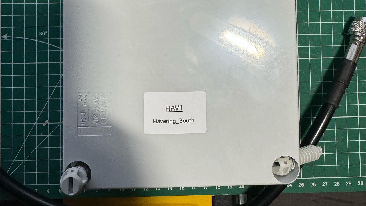

Here’s my first go at a standalone Meshtastic node; in a IP67 enclosure:
When I get bored with Meshtastic it will morph into a APRS digirepeater (with a 433MHz version of Heltec LoRa V3 board). It uses a 35cm (Ī») Collinear from McGill Microwave, which purports to have of gain of about 6dBi:
  https://www.mcgillmicrowave.com/product/6-dbi-tuned-antenna-eu-868-2/
It has a 10,000mAh power bank (which seems to last for around 5 days), but will hopefully be updated to include either Solar and an external 12v feed very soon.
What is the black box at the back? Where are the batteries? Sorry so many more questions about this :smiley:
