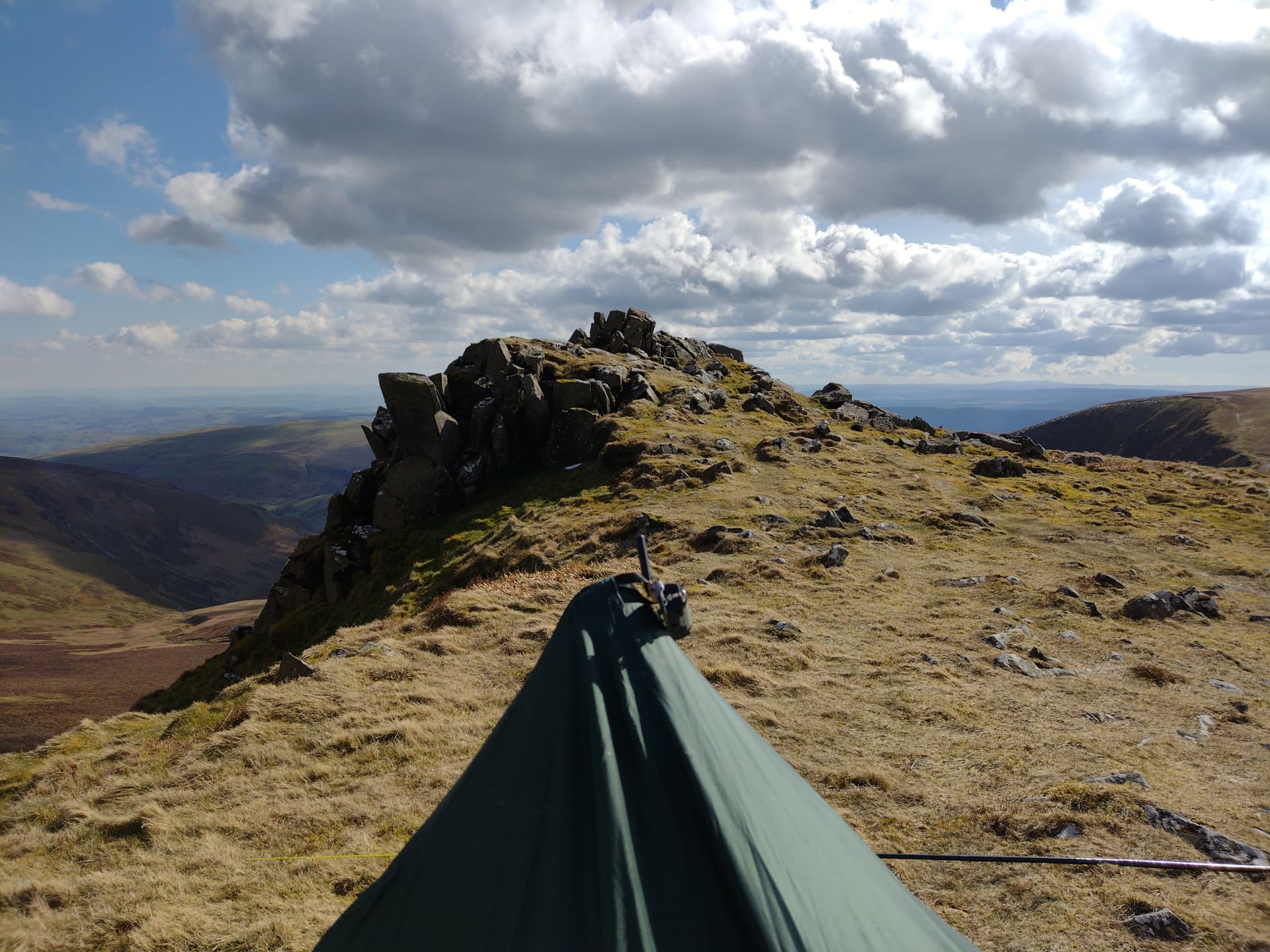

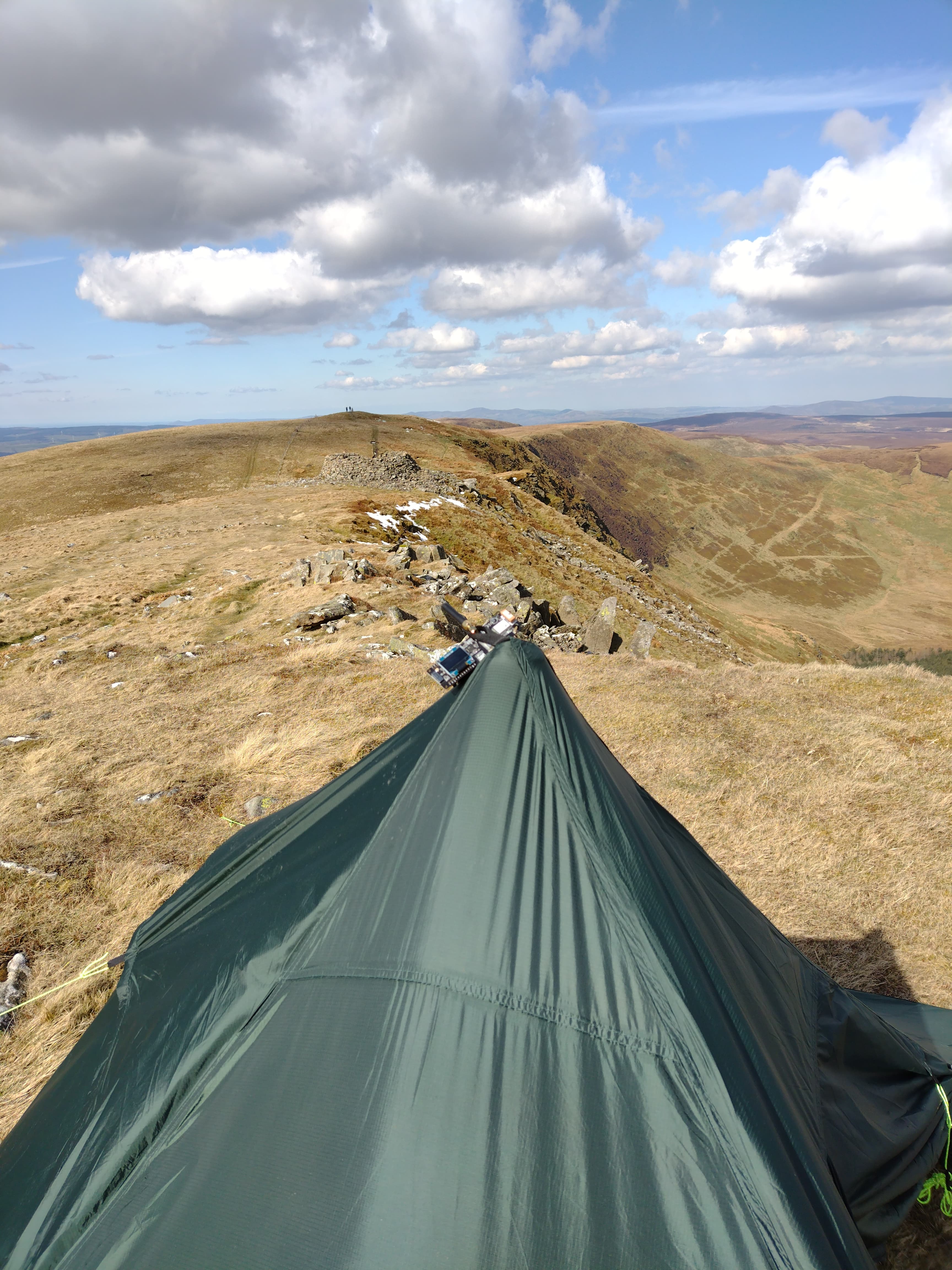

Here’s some piccies of the LoRA tracker mounted on top of the DD tarps pyramid tent - on top of GW/NW-012
Thanks for the update Dave. That’s 28km with that little rubber duck antenna you get with the board. I wonder what the range would be with a decent whip.

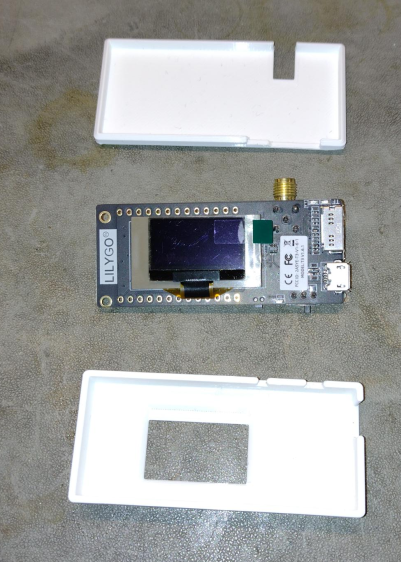

If you are interested in a 3D printed case for the tracker Robert G0PEB arranged for ebay seller chrisgcj to print some custom ones. He sells a box for the smaller ESP32 LoRa board (without GPS), which I use as the igate, as standard. My Sondy Go ESP32 LoRa32 V2.1 Case | eBay
I will message him today to suggest that he adds the T-Beam board to his standard items as there might be some demand from SOTA people.

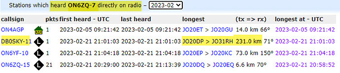

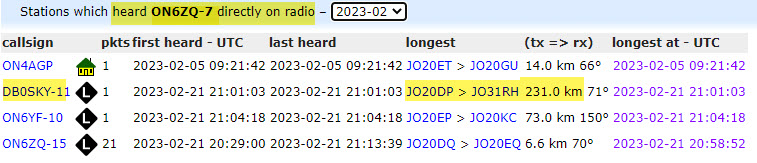

See the very first post of this thread: 231 km with 100 mW using a short dual band mobile antenna on the car window mount clip.
Your mileage may vary :slight_smile:

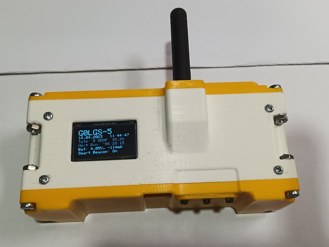

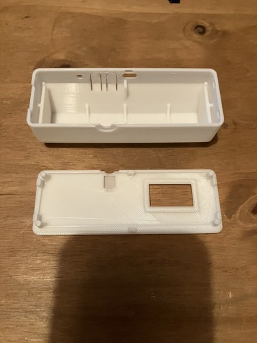

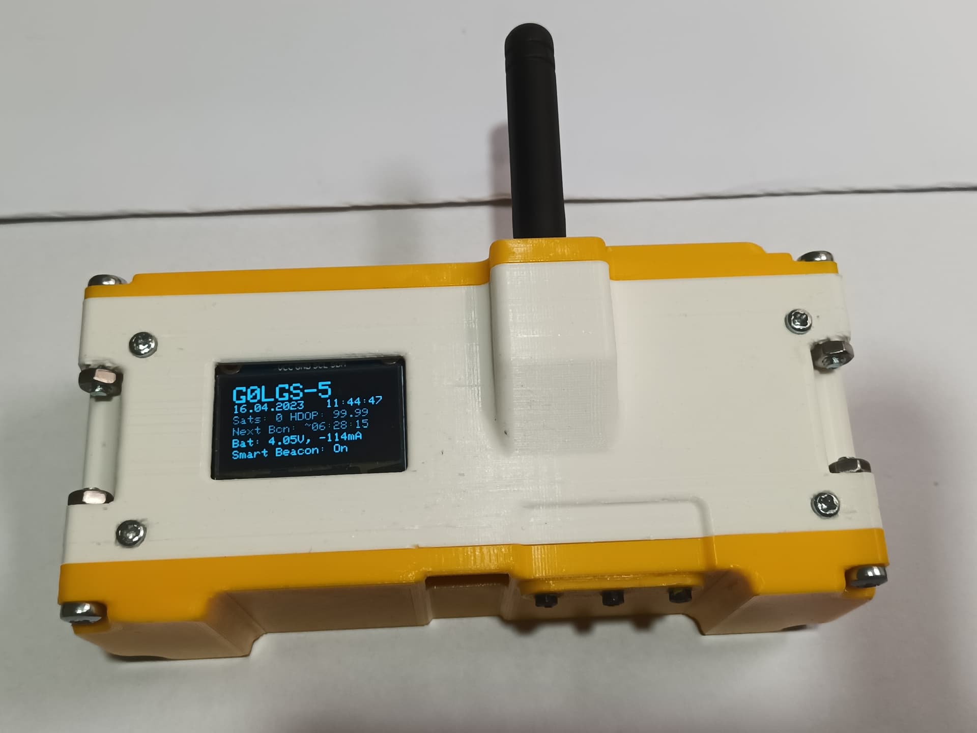

Here is a pic of my Lora / APRS tracker in a 3D printed case
Fantasic Dave. Those will be really good tests.
The T-Beam box is now up on Ebay. He didn’t put it up as he thought there was a copyright problem but that is now sorted. This is the link:
73 John GW4BVE
Wow Stewart, that is a super rugged box.
73 John GW4BVE

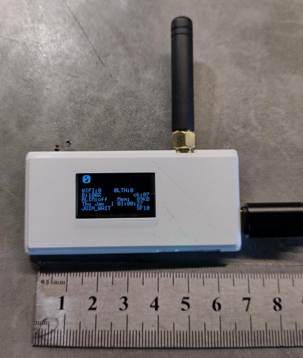

That looks robust! Can you share the cad files ? I have a design for the none-GPS version (that I use for my iGate); happy to share the design for that.
It looks great and sturdy!
Is the 3D model available ?
I found mine on Thingiverse 4677388 - various options available for shrouded antenna too.

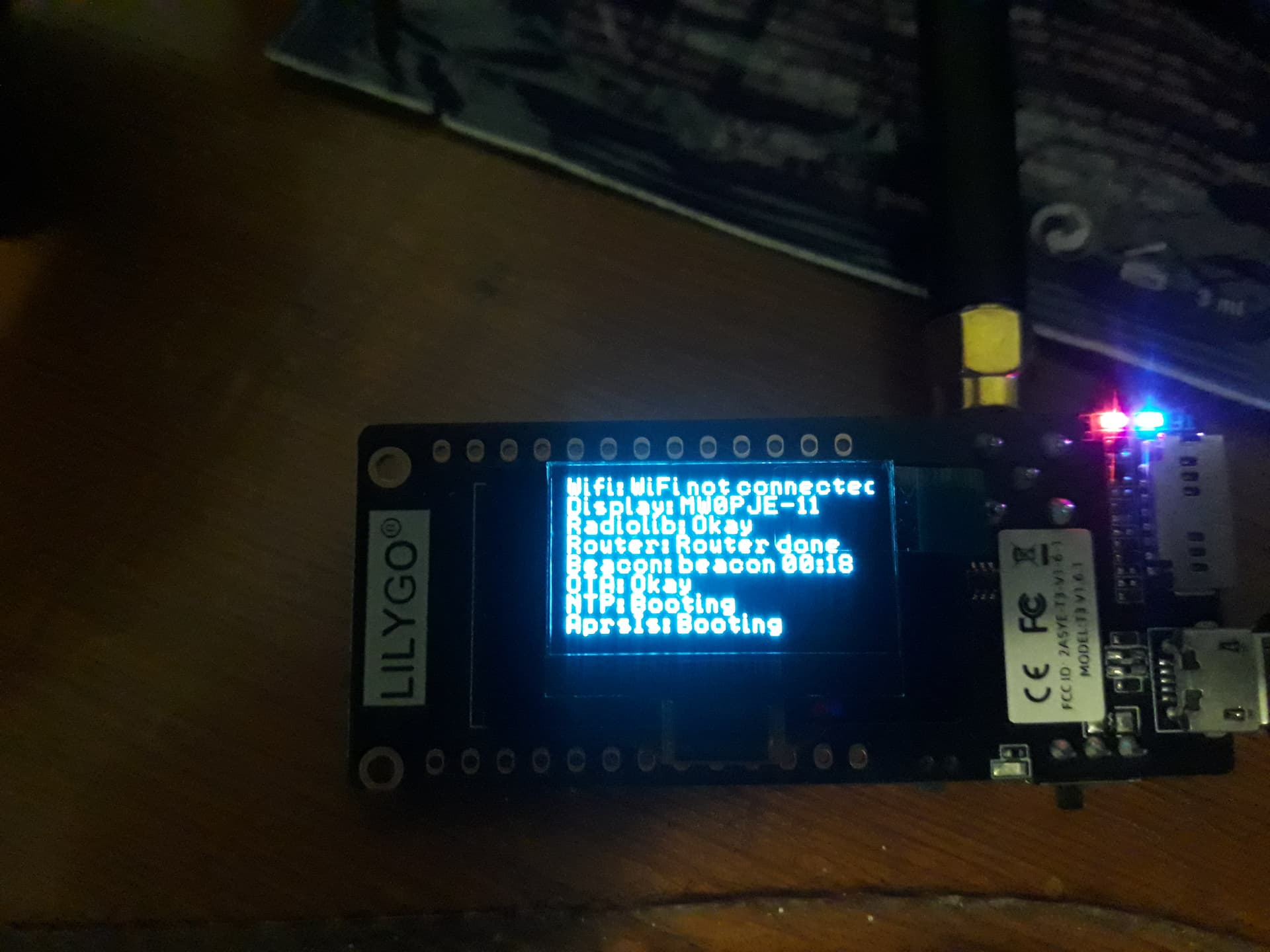

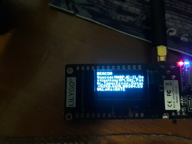

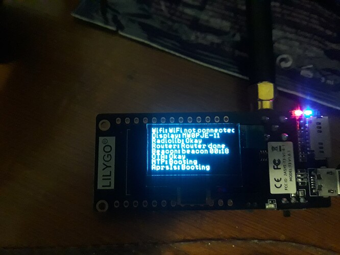

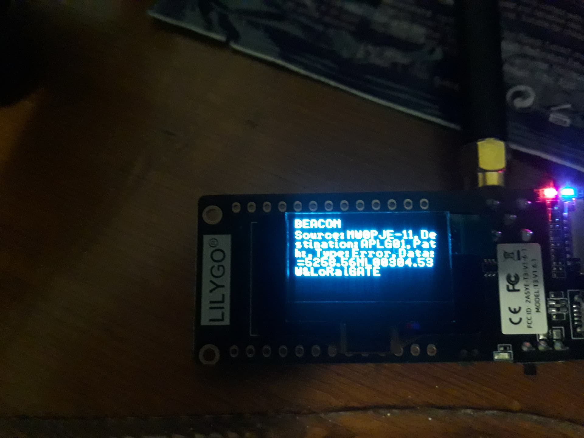

My LoRa boards arrived yesterday.
I’ve compiled and uploaded the code for the APRS igate, and uploaded the settings file.
However it doesn’t want to connect to my WiFi, even though the details are in the configuration file andive tried DHCP and static IP.
I’m also getting a seperate error with the beacon data which gets sent to APRS-IS.
Did anyone else have these teething problems when setting up a receiver?
UPDATE: All up and running. A fresh set of eyes spotted a typo in the WiFi ssid!
Hi Peter,
Did you upload the code (bottom tick) and the json file (Alien icon on the left menu bar) ? It should display your callsign when all is well.
Dave
Hi Dave, yes I compiled and uploaded the code to both the iGate and the tracker, and I uploaded the settings file. Both are working fine now.
