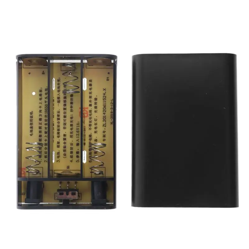

I’m using now 3x 18650 batteries with this Aliexpress case.
Works great and is 200g lighter then my 26650 LiFePo4.
For more days or more then 5 peaks I’m taking 3 extra 18650.
They also fit perfectly in my LedLenser.
photo_2023-10-15_09-50-49
Julian
Hello Julian - could you post a link for the battery case please?
Hello Matthew,
of course. There u go.
Julian
You can buy them on eBay. Get the ones that don’t use coil springs for the terminals.
