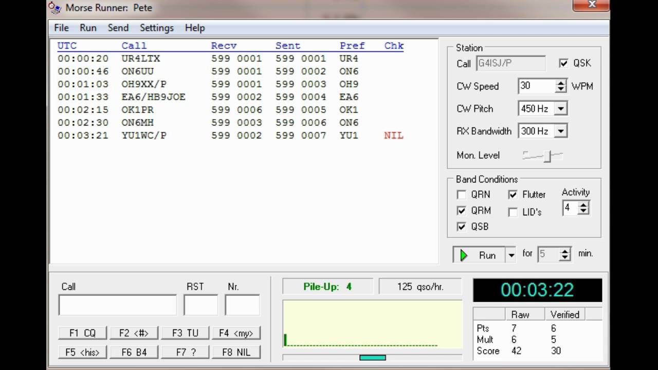

If that’s the case, there’s nothing more fun or useful than using Morserunner as previously mentioned by Christophe.
I often run a quick session when I’m at a loose end. Even a 5 minute session brightens the day up :smile:
I’ve created a callsign database from the “real” sota chasers in my logbook. It’s funny sometimes to hear people on CW that you have never worked in that mode :grin:
You can customise the session to make it as hard or easy as you wish. With QRM,QRN and LIDS it makes it very realistic.
Here’s a SOTA session from earlier this morning.
Try it, you won’t be disappointed and you don’t have to leave the comfort of your home to work a pileup!
