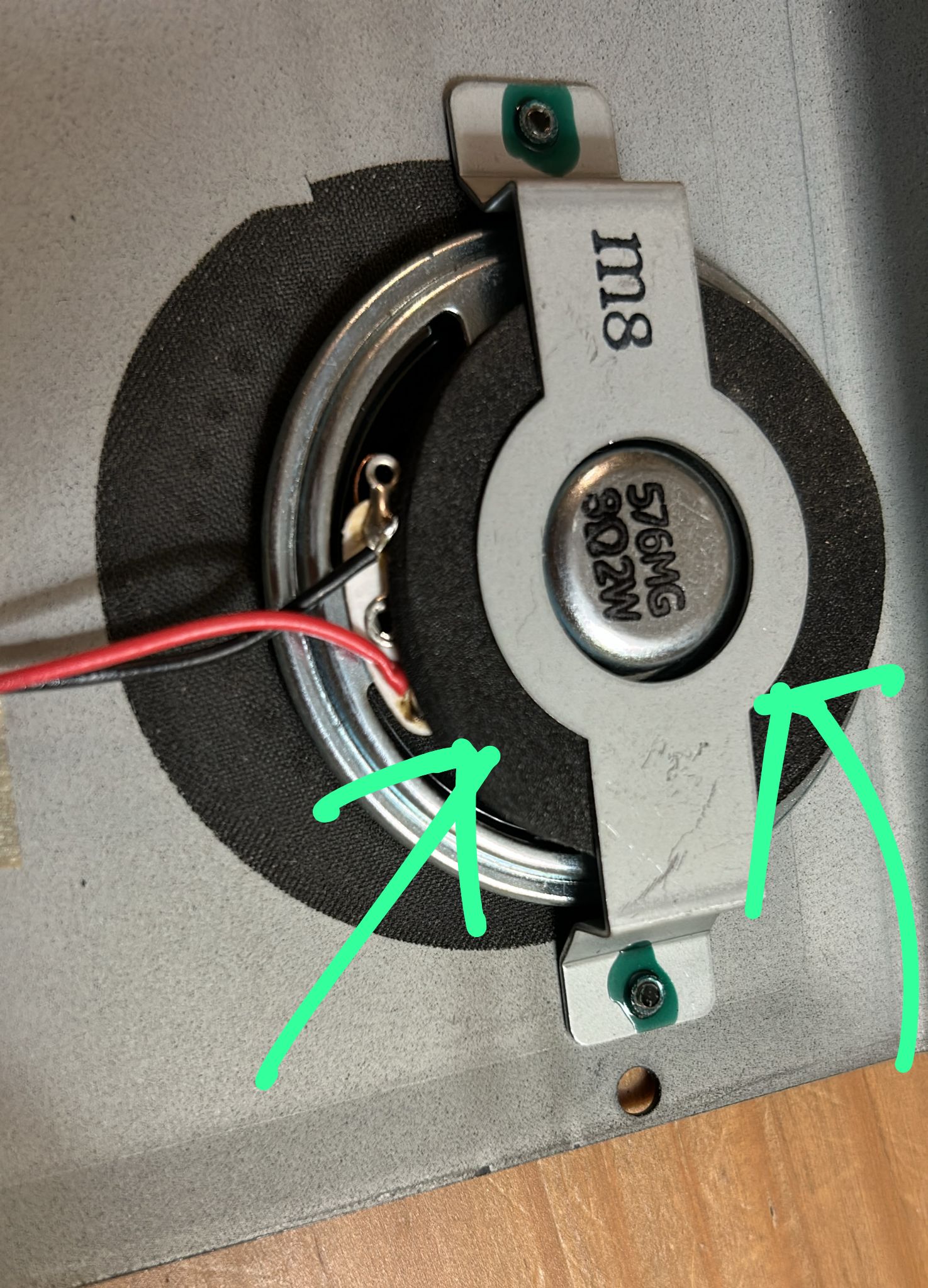

I was alarmed that since the FT817 had come back from the repair shop it has been making fart-like audio artefacts on SSB and CW which would go away on tuning slightly off the dial frequency. Fearing the BFO had become misaligned, I conducted a load of experiments to isolate the problem. Eventually, it turned out to be the loudspeaker very loose in its metal mounting bracket and vibrating – but not in a good way – on certain audio frequencies. Weird, because the LS was nothing to do with the original transmit fault.
To cut a long story short, I added a large rubber washer between the back of the LS and the bracket, and now the speaker audio sounds fine. All set to go now!

Hi Don, when I worked you on Sunday from Gummers How G/LD-050 I used an almost vertical J-pole on an unguyed 3m pole leaning against a rock – very quick to deploy. The problem that day wasn’t your signal strength or that of the others I worked on 2m SSB [especially with S0 noise on 2m] but my FT817’s farty loudspeaker which made the audio virtually unintelligible.

I’ve deleted your entry from the log. Better luck next time (with my 817 audio working properly).
