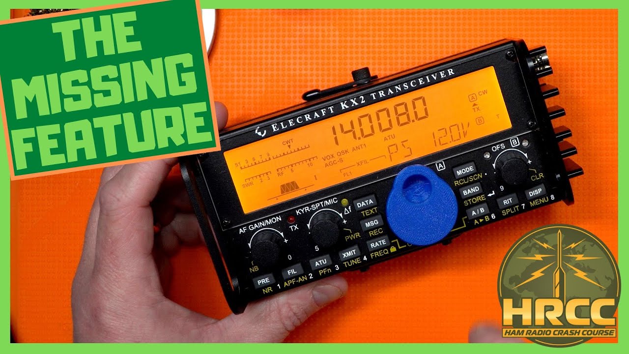

After the @K5DEZ video I think I’m not will installing the KXIBC2. I’m very clumsy with the solder. ![]()
I’m halfway through the video and it’s glaringly obvious Jason hasn’t been paying attention to the discussions taking place on the dedicated email reflector for this product (which he would have been invited to as a field tester). The E-pin issues were sorted out very early with a number of options put forward.
Yes, it’s a thru-hole.
Yes, it’s filled with non-lead solder.
Yes, melting the solder is a PITA.
That is literally the only difficult part of the install, but as I said, work-arounds were developed. I personally used the “drill it out” method using jeweler’s drills. ![]()

My KXIBC2 arrived Friday and was easy to install. The current instructions call for solldering the white wire’s pin to the base of the DC input jack rather than the solder-filled “E” hole in the board. Piece of cake.
