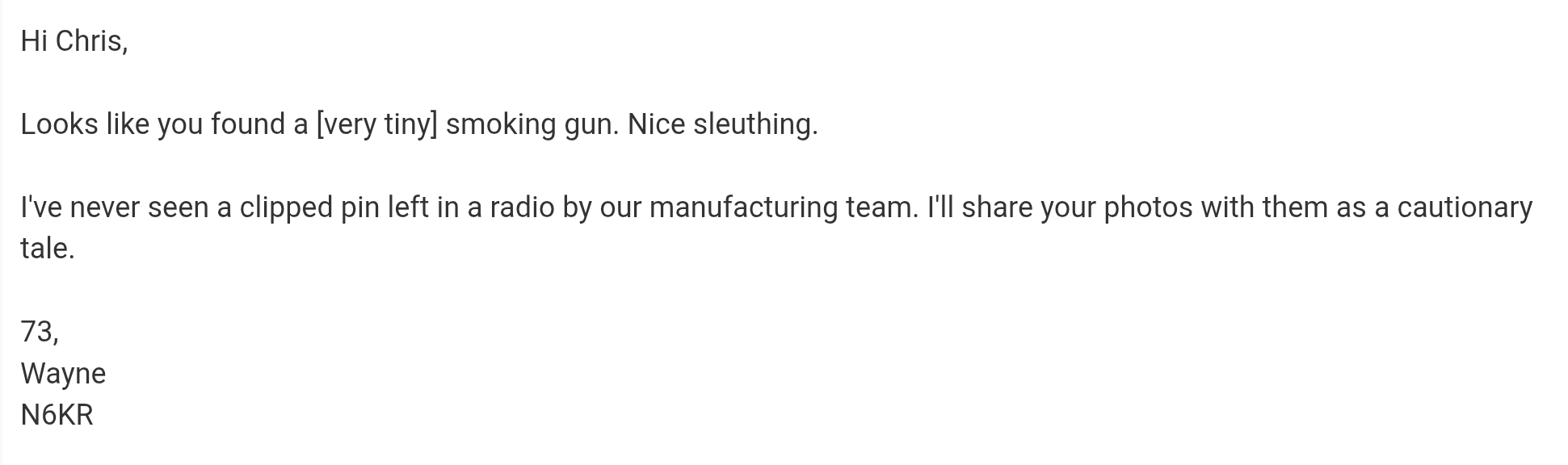

This is his reply of my post here. https://elecraft-kx.groups.io/g/main/topic/kx2_encoder_issue_solved/120116625
