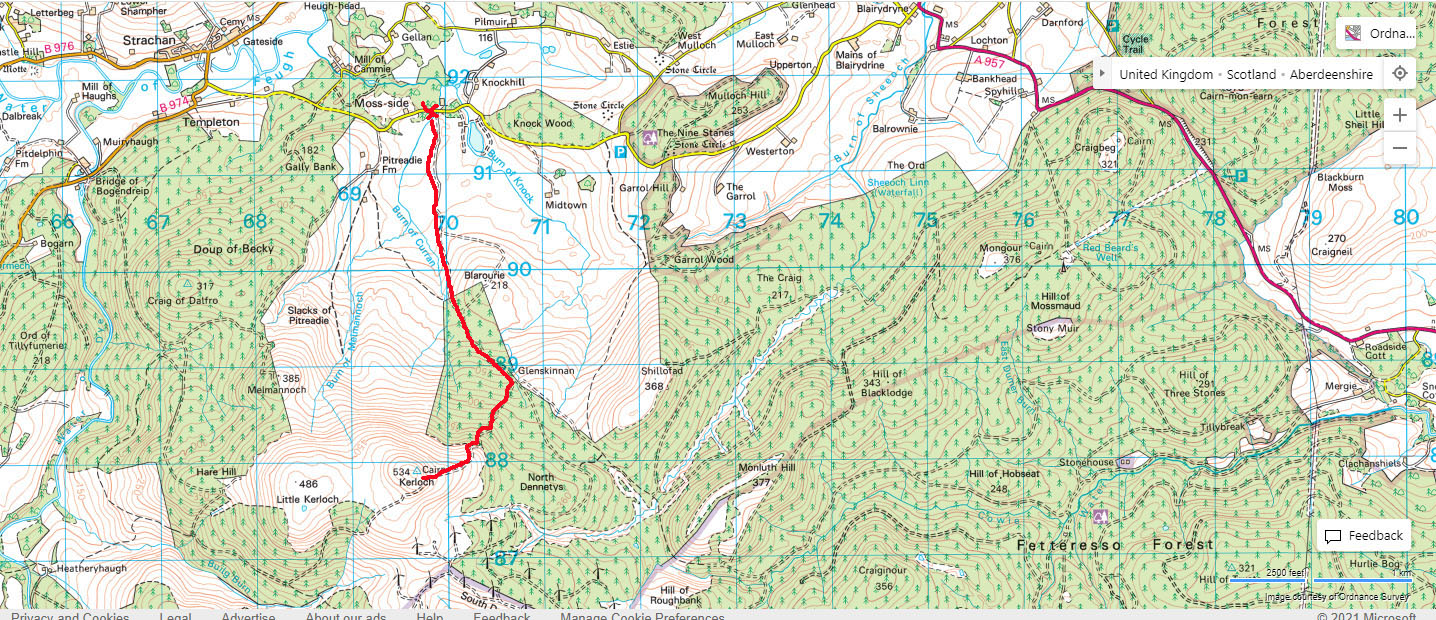

The approach to Kerloch is initially an easy stroll along a well-maintained forestry track from the starting point which has parking for 4 or 5 cars. After passing through a field of cows and two walker-friendly gates, the track starts to head up. The track to the summit branches off the main path and it is however more like a river bed than a path, mainly composed of small granite boulders and stones. The recent poor weather has evidently taken a toll as parts of the “track” were quite deeply eroded by running water. A minor hurricane had also passed through, leaving broken branches strewn around and one large tree had fallen across the track and had to be ducked under - I managed OK on the way up but my mast got snagged on the way down, causing much swearing. So even though this last bit was relatively short, it contributed to my arriving at the top quite a bit behind schedule.

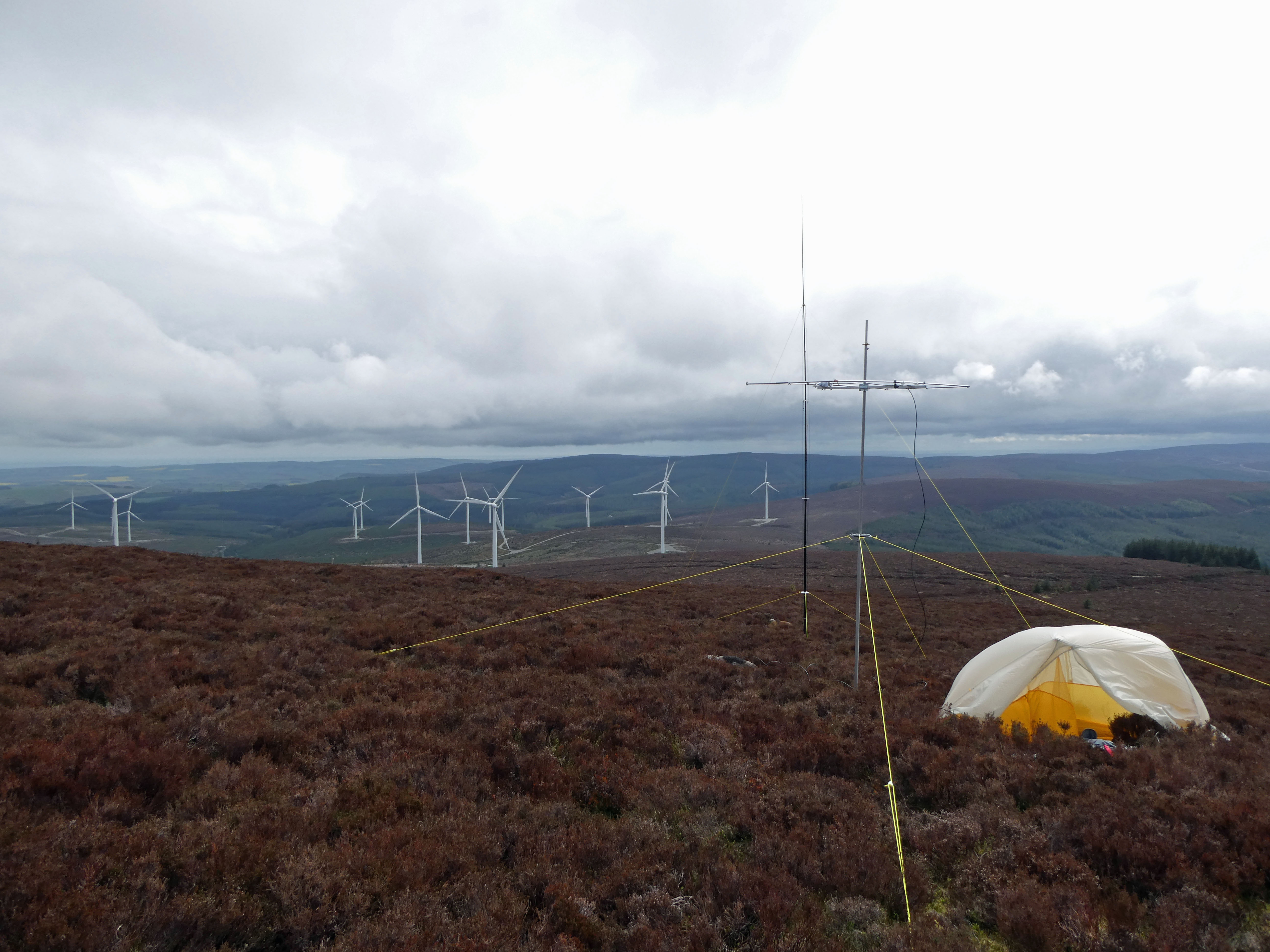

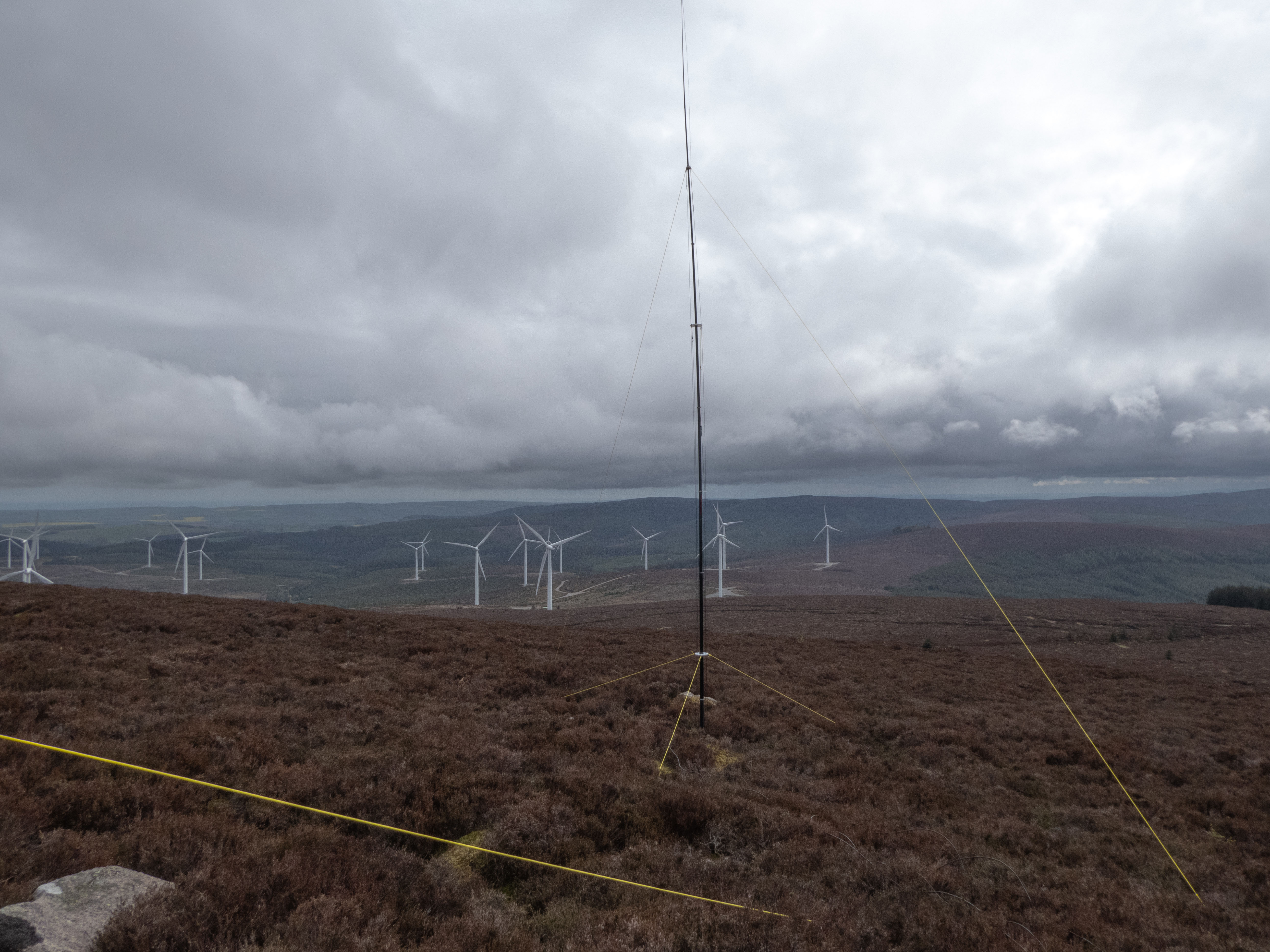

With a strong breeze blowing from the south I set up the vertical first and was happy with the upper guys - the antenna looked more like a vertical than on my last activation. Ground surface presented no problems - just short heather. As rain appeared to be threatening, next up was my tent and I eventually got the 857 going at 1115 local - the rain thankfully held off but the tent was good protection from the wind anyway.To ensure qualifying the summit I made a quick spot on 40m and had a good run for 15 minutes, with F4WBN being first in the log and including a S2S with DC5LY/P. I then checked 6m - the DX Commander is not far off resonant on 6, enough at least to give an idea of what the band was doing and it sounded lively. I therefore took a short break to put up the moxon.

Route up
Operating position, looking south
DX Commander with upper guys

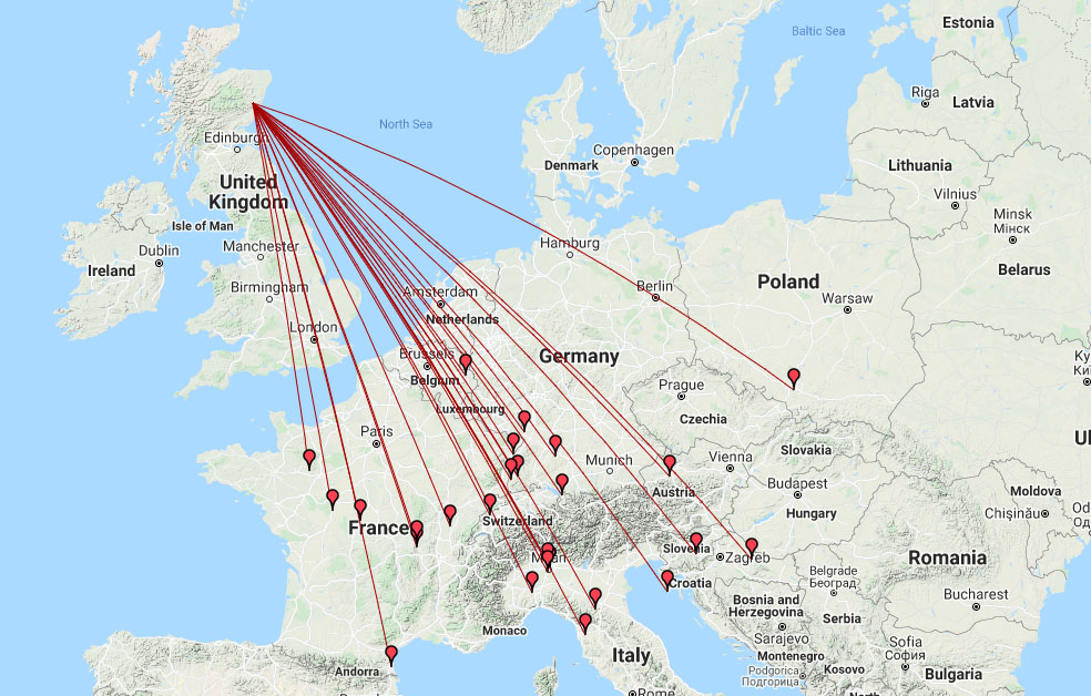

6m QSO map
