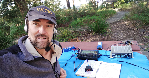

Today I activated Mt Elliot VK2/HU-093. It was a very successful outing with 25 S2S including 3 NA, 9 JA, 2 ZL and 11 VK. Best band was 17m although DX signals in general were weak. A 50W linear was used for some 17m contacts when 12W from the KX3 wasn’t enough. Antenna was a ZS6BKW at 9m plus a 20m elevated ground plane.
Looking forward to the next one.
Thanks for all the calls!
Cheers,
Gerard - VK2IO
