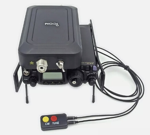

Yes, in theory it is a dedicated atu for the 705 only. I guess it could be adapted for a 703 also - the pin out is the same although the connector is different (a conventional Icom socket). There are adaptors on ebay to interface with an 817.

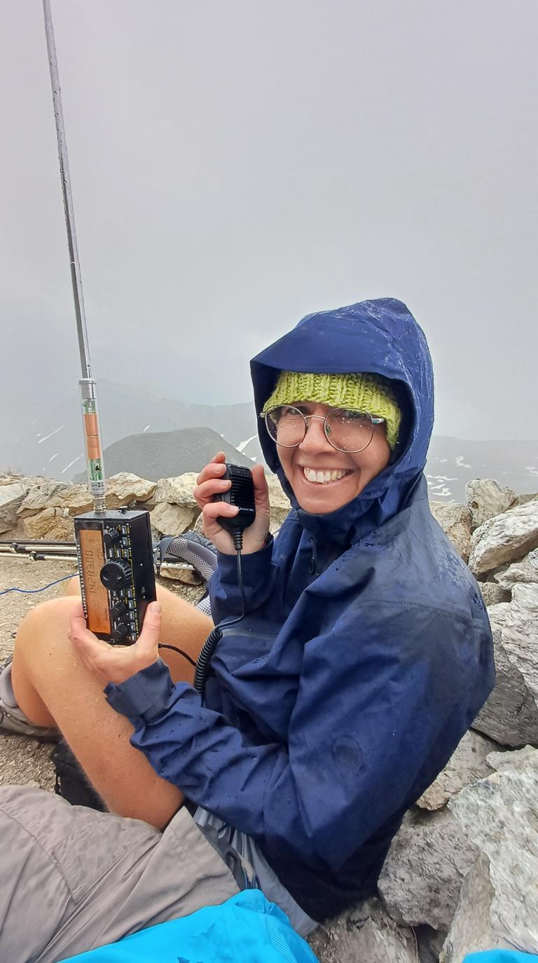

When operating in the rain, the KX2 goes in a repurposed see-through toilet bag with cables coming through the zip opening. See photo in link below …
Good advice. Me too. Actually I do that with everything that gets wet/damp.

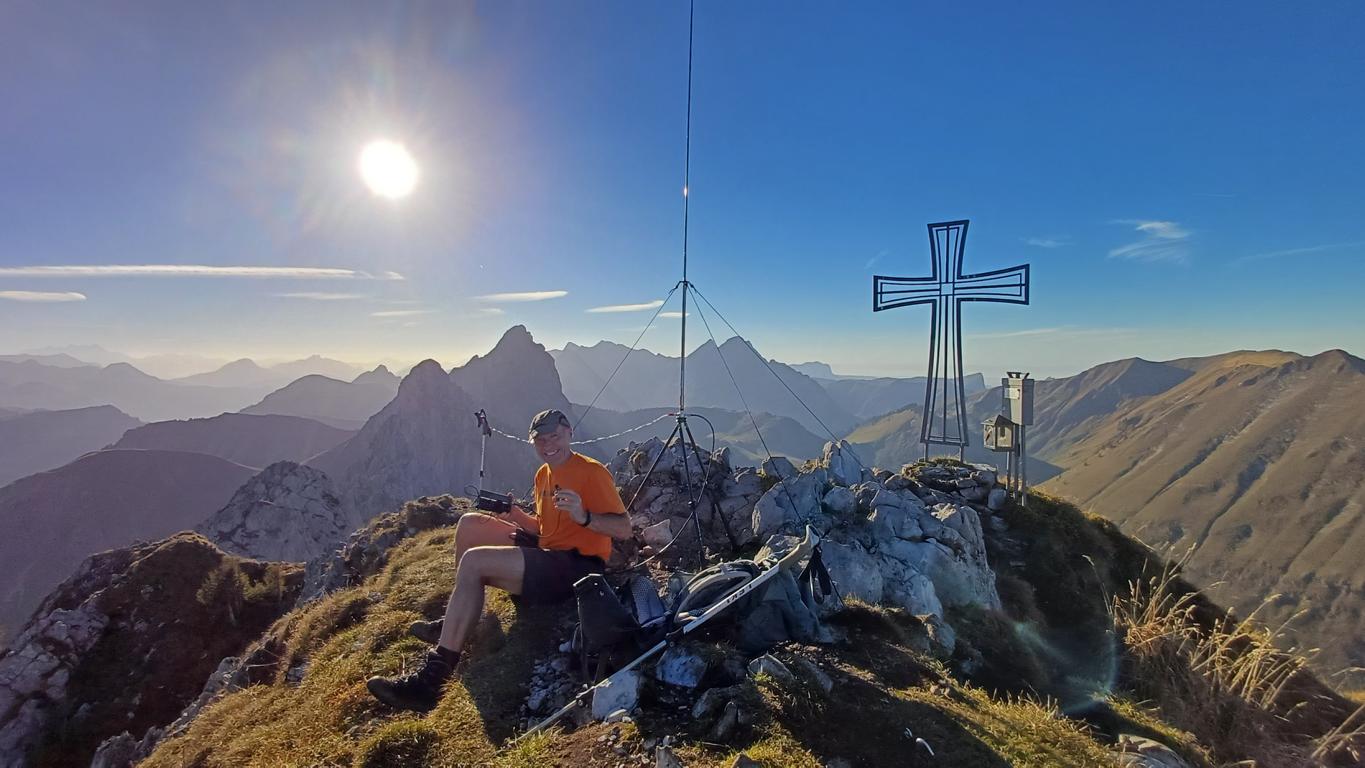

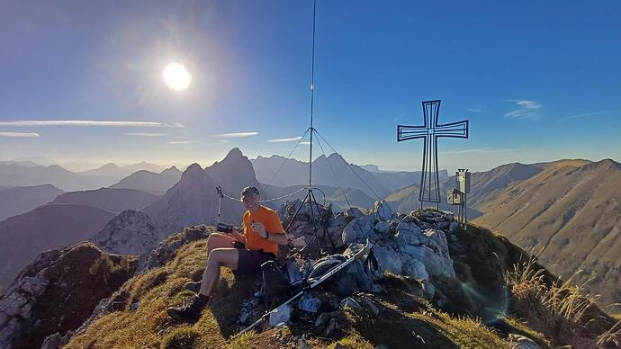

17 days after you, albeit with better weather, I also activated this summit.
On this summit I used my proven LAB599 TX-500 with a loaded vertical antenna, which I mainly use on summits with limited space.
In this picture you can see this antenna in action, resulting in 45 contacts:
The following video shows my personal pros and cons of this resonant antenna:
Tomorrow for the Trans-Atlantic S2S party I’ll use the same antenna mount with the earth spike, but instead of the shortened vertical I’ll use the cheap full size quarter wave vertical from Aliexpress (see the reflector thread Cheap 1/4 wave antenna whip from AliExpress (Part 2))
There are so many different antenna solutions, just choose what suits your situation best!

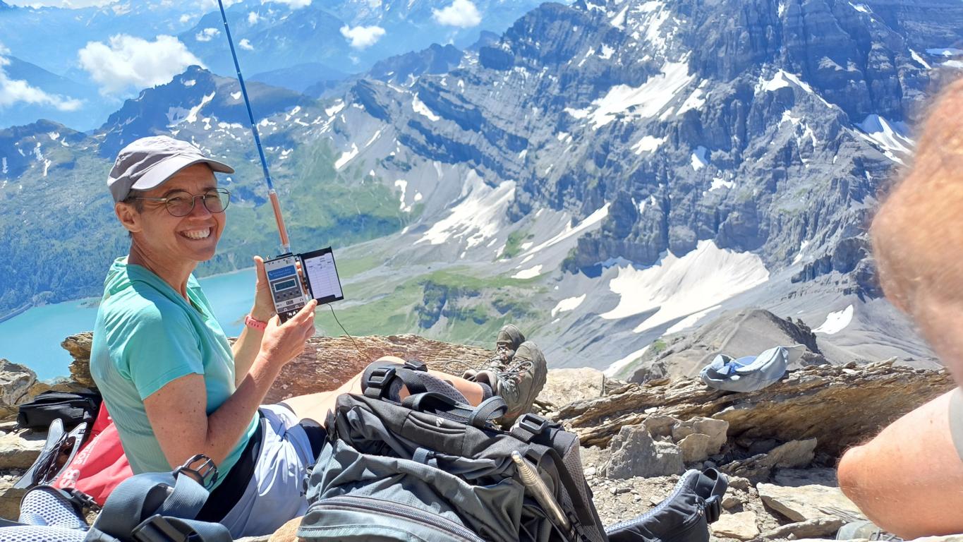

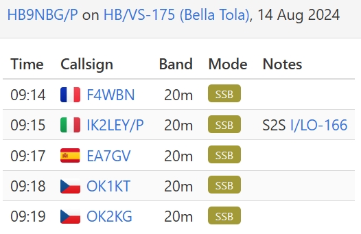

Great video with very understandable explications :+1: As you know, we prefer HB9NBGs Clever-Whip Kit, that is a Full-Size solution and can be used also, if the ground is completely made in rock :grin: of course it’s not as cheap as the components from Ali, but it’s made in Switzerland :wink: My remark, that I’m sure, that the activation of the Bella Tola wouldn’t be possible with any other equipment than a KX2 with direct mounted AX1 was meant with that WX, that we had at this day - there’s was no minute more left for the activation, because the thunderstorm was already exactly above us :flushed:
That was my log - Carine had worked the same stations within the same 4 minutes :grin:

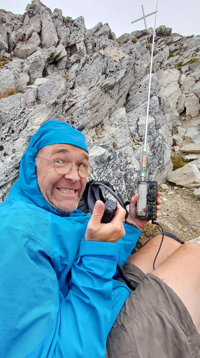

What sometimes makes me think is how you and others log your QSOs, holding the rig in one hand and the microphone in the other. I want to sit comfortably and need one hand free to enter the data into my smartphone, which is magnetically attached to my leg (well, my leg is not ferromagnetic, but I have a magnetig strap around my leg) :sweat_smile:.
