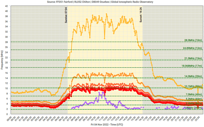

MUFs and F0 as of yesterday, and it looks promising for today as well:
