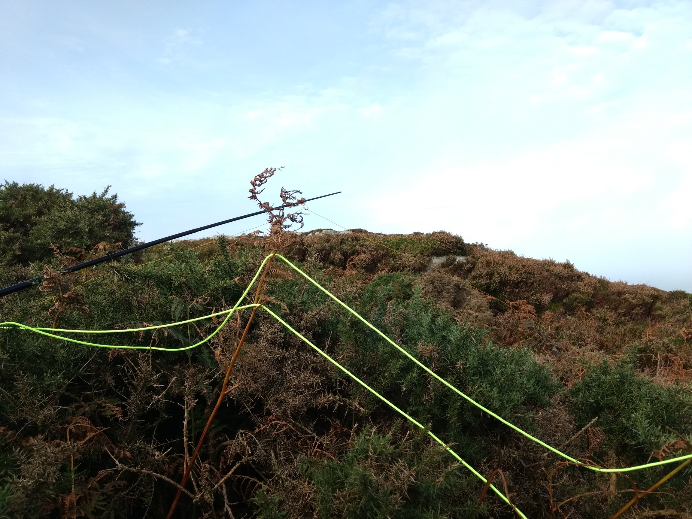

I was soon on the summit. It was quite a struggle to get to the trig point thanks to the wind. Fortunately I could drop a little bit down to find some shelter. I started setting up the fishing pole mast. Thanks to being quite narrow and with guys and wires getting caught in the gorse I managed to step on the pole and crack it. Fortunately, I now carry a little repair kit and so I taped the break. I continued to set up the EFHW but in doing so the tension bent the mast where it was taped. My antenna wire was now on the ground, slightly raised in a couple of places thanks to the gorse and heather.
I’d read on the reflector about activators forgetting poles and still managing to work stations with the wire on the ground so I was determined to try this to save the activation. I carried on setting up my homebrew CW QRP rig and called CQ on 40m. I wasn’t getting any response so thought I was wasting my time but then I was called by GM4ZMK. This was quickly followed by regular chasers DJ5AV, EA2DT and EA4BOC. I’d qualified the summit without a mast!

A rather sad looking mast and antenna

Thanks for the report and well done for not giving up and completing the activation. I never ceased to be amazed at what actually works in the field!
I found reception was fine when my antenna fell over but the SWR went off the scale when I tried transmitting so I stopped. But the antenna wire was flat on grass and rock with no assistance from gorse. :slight_smile:

My homebrew rig doesn’t have an SWR meter so I don’t know what the SWR was but it’s PA should be pretty robust. I haven’t tested it into a short or open circuit but perhaps I should try that.

I managed to fix the pole simply by putting some insulating tape above the cracked bit. This means the pole is slightly shorter and the broken bit is kept inside but it should be usable (although I haven’t tested it in the field).

Always worth a try! Looks like a similar setup to me when I forgot the mast on Seat Sandal in the Lake District.
