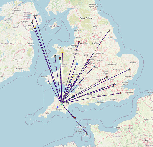

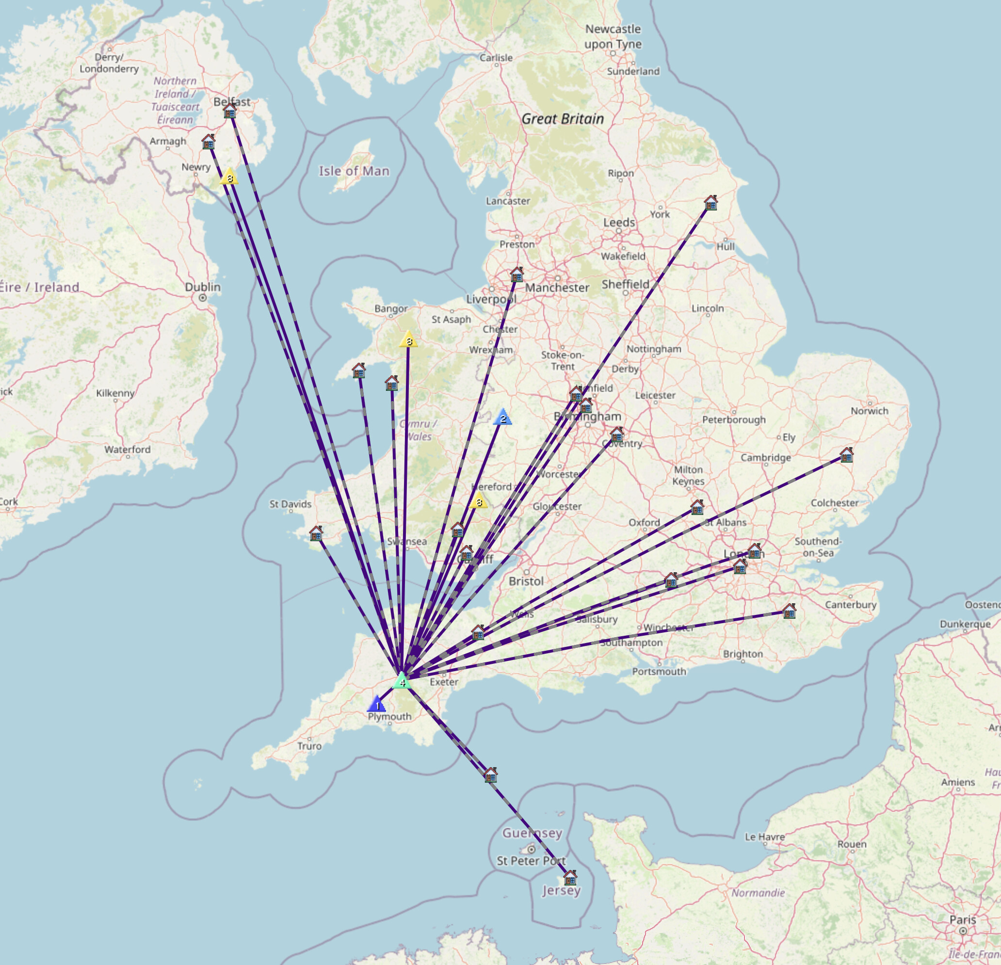

I managed about 25 contacts before my 3AH battery started to complain - so I dropped the power and kept on going. I was already very pleased to have contact with MW0JLA on GW/NW-010 (S2S contacts are the best) as well as contact with stations further than I had managed before, so I wasn’t concerned about running out of power.
But about 6 minutes before my battery finally gave up, I made contact with MI0SRR - who was close to, but not on a summit yet.
Two contacts later, the battery died. I’d have gone home then - but the MI contact lured me to switch to the HT for a final attempt at DX. He was my next contact, this time on GI/MM-006. Success. DX S2S on 2m-fm.
