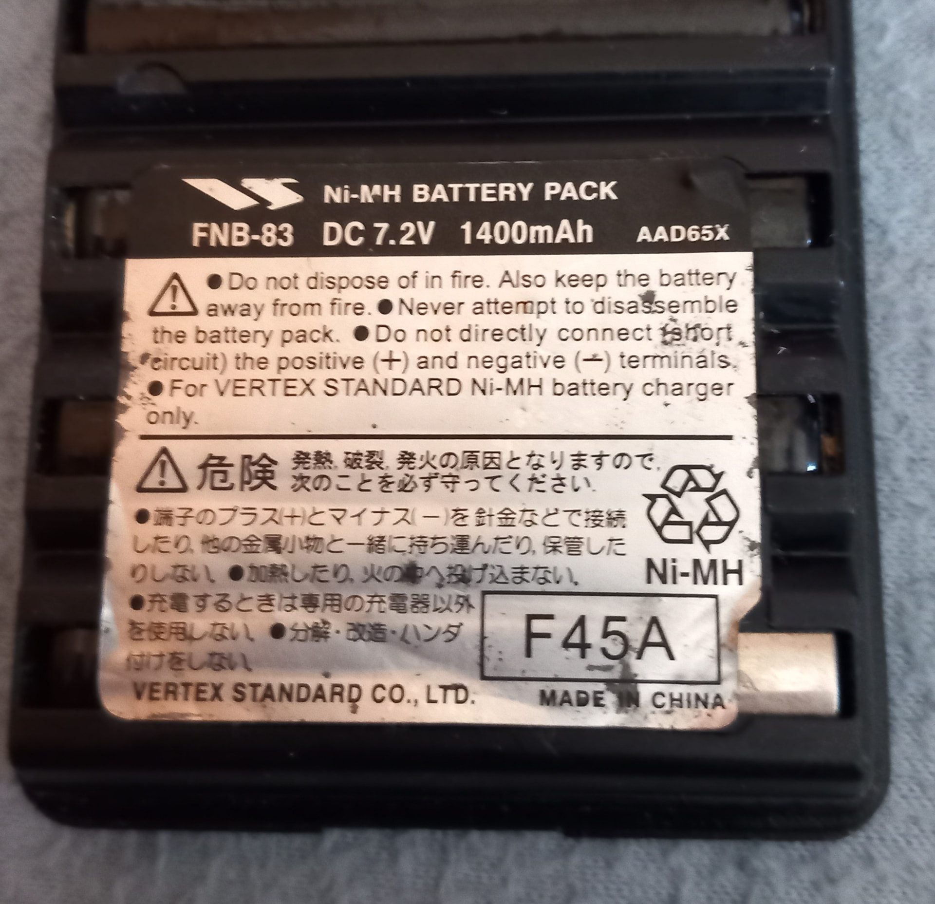

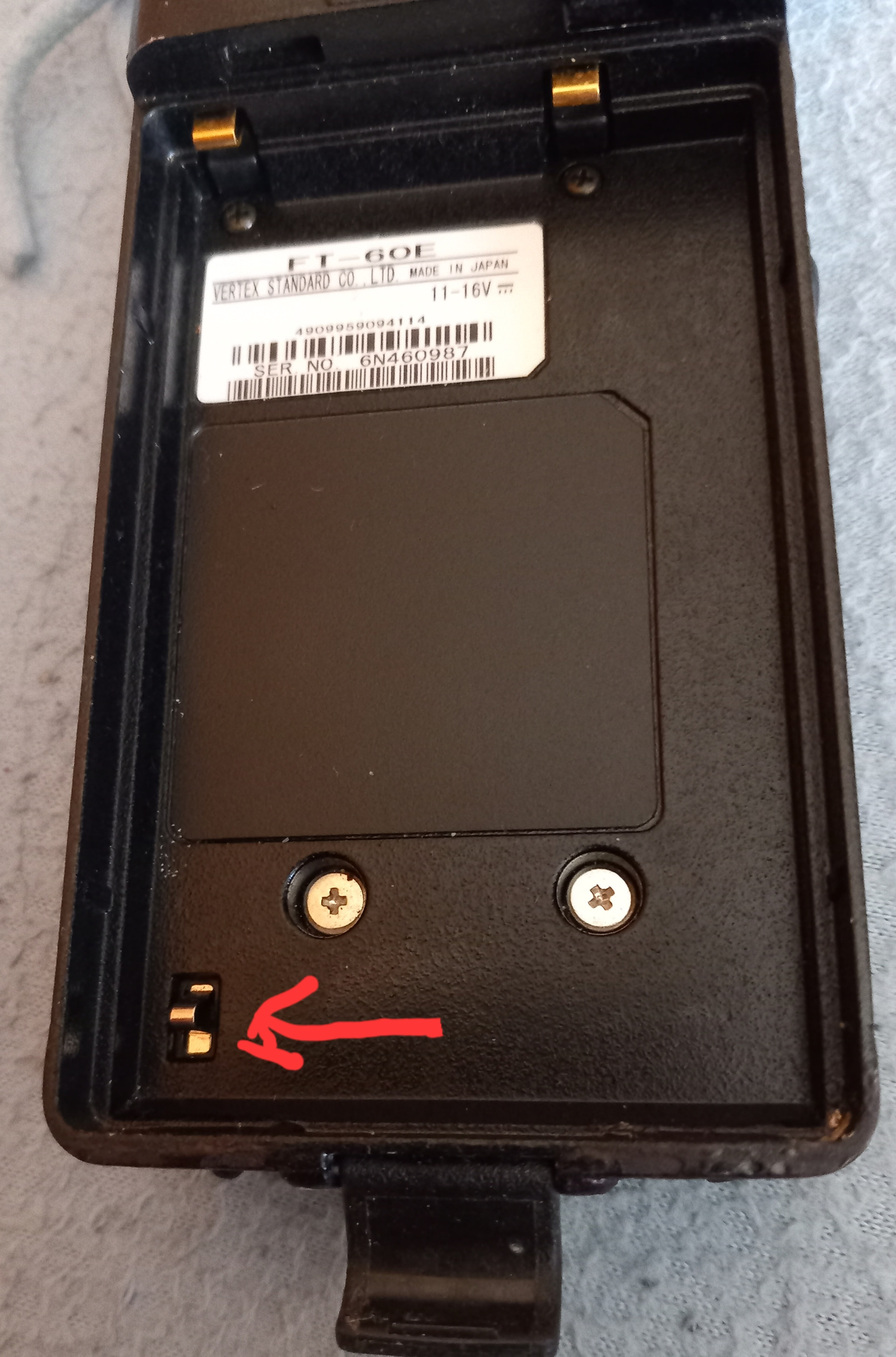

My friend told me about modification of AA cells in battery box for FT60
Strip a little bit of lowest cell insulation and you can charge AA cells with battery box on the handheld. On the low part of body of ft60 there is contact
