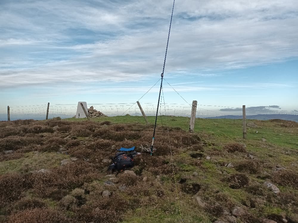

More in hope that expectation I put up my 10m quarter wave vertical with three elevated radials, and matched it on 6m with the Elecraft T1 tuner. I could hear no signals, not even FT8 which didn’t bode well.
However, a self spot for SSB and a CQ with 5W from the FT817 quickly attracted a call from Richard @MW0GWG near Aberystwyth, and we exchanged 59 / 52. Result! Thanks Richard.
I also heard Stewart @G0LGS calling, logged as 44, but he couldn’t hear me. Someone else called, but too weak to be readable. Thanks to all who tried, much appreciated - maybe I should have rigged something horizontal…

Yes, sorry, I only thought about polarisation later. I have very little experience on 6m, and for EU stations when the the band has been open, vertical has worked well enough. For closer line-of-sight plus a bit contacts, it is probably more critical to avoid cross polarisation.
