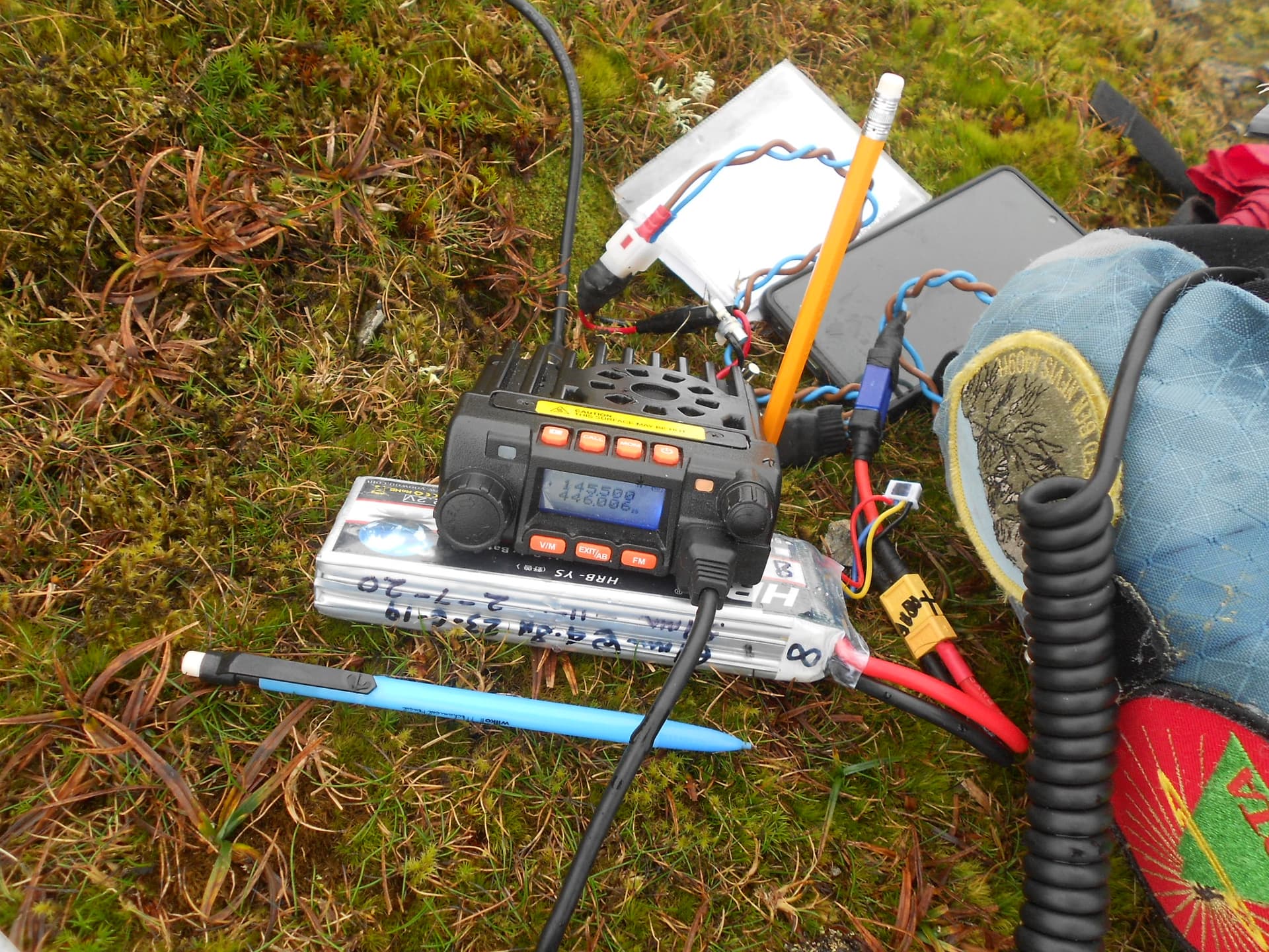

Moonraker MT270M, 2m/70cm, 25W miniature Mobile Transceiver

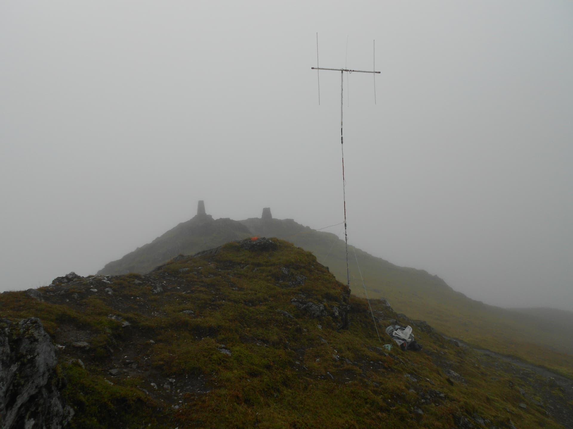

3-ele modified SOTAbeam (vertical config.) with 4m RG316 coax
3-section mast and guying kit. (Top section PVC to minimise pattern distortion)

One HRB 11.1V, 5Ah Li-Po battery

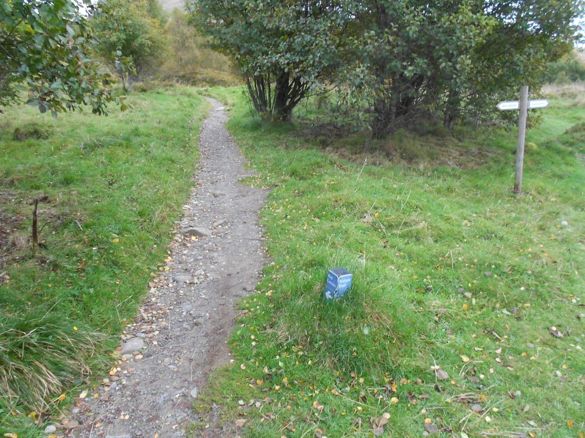

The start point is the Ben Lawers car park at NN 6085 3772 (430m ASL). It’s pay and display and costs £3 for the day. Divided into bays separated by trees and bushes, it’s extensive. Unlike the Schiehallion car park, it doesn’t have toilets.
Getting up at 6am and driving there for 07:15, I set off walking from the car park at 07:49. First you walk through a ‘walled interpretation area’ to a gate then cross the road to the path on the other side. The initial ascent is in pleasant surroundings of bushes and trees. Once on the open fell there is a gate (NN 6165 3925) at which a choice is made. It’s either straight on to Beinn Ghlas followed by Ben Lawers or if just doing Ben Lawers - keep left and go up the valley on a good path. I did the latter.
When you reach the highest point there is a left turn to CS10 (NN 6208 4074 at 870m ASL). Carry on to skirt the the western flank of Beinn Ghlas via NN 6224 4087; NN 6235 4076 and NN 6283 4101. You meet the path coming off Beinn Ghlas’ NW ridge at the col between that and Lawers (NN 6301 4117). From there the path steepens up to the summit of Ben Lawers where there are two pillars. One is a dilapidated trig point (TP-1281) sorely in need of repair and the other a view indicator apparently missing its top plate?
The path is good all the way and currently being improved on the higher reaches but it’s quite a hard climb that took me two hours to complete. The cold and foggy summit was deserted for at least half an hour after I arrived.

Above: The wooded section

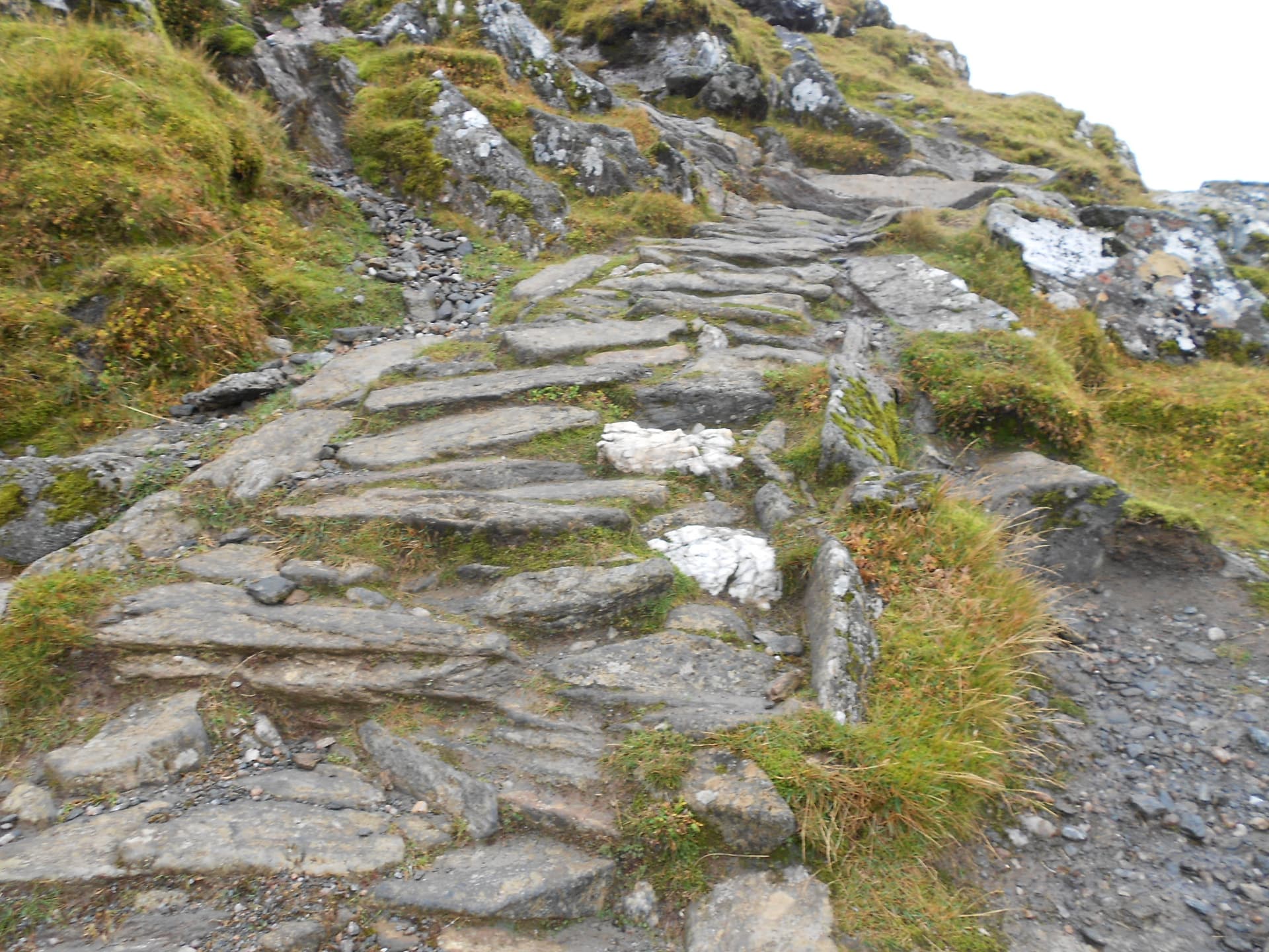

Above: Ben Lawers path

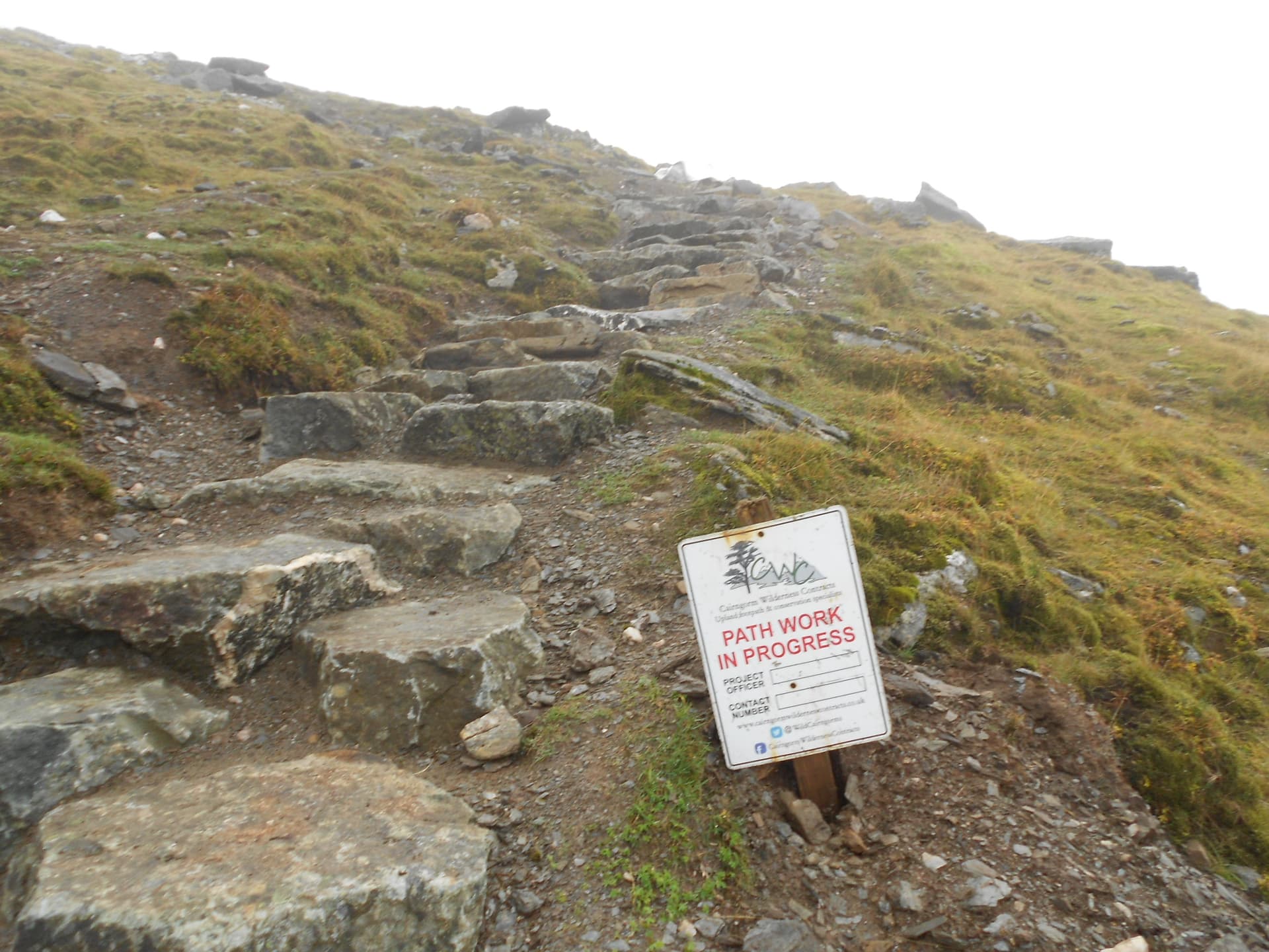

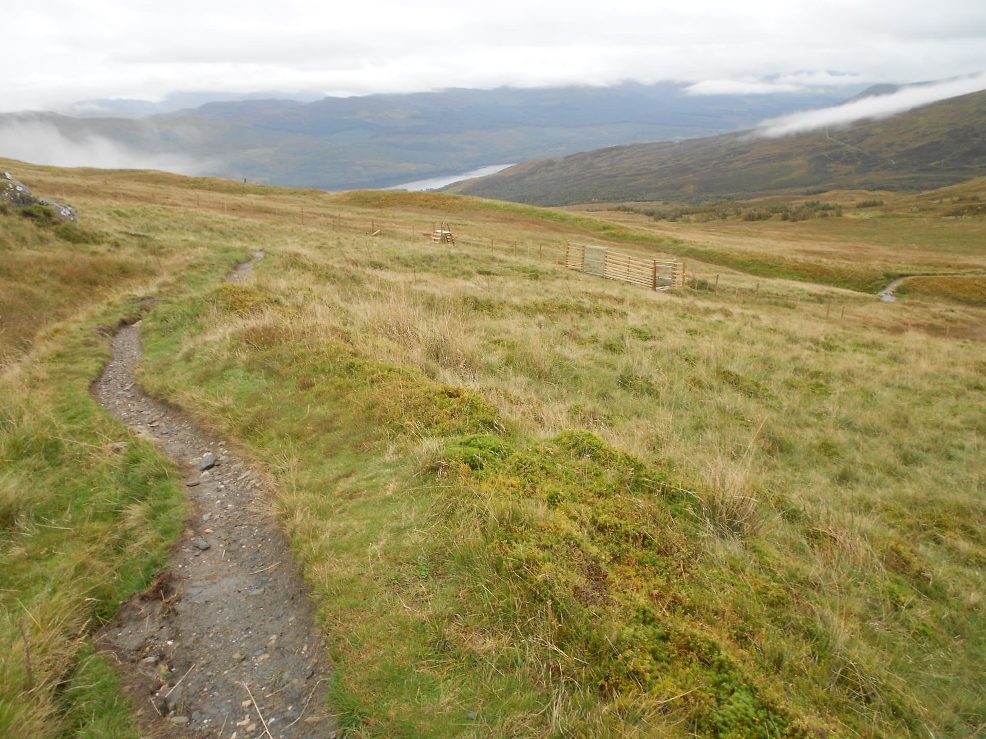

Above: Well up on B.Lawers. Path repairs

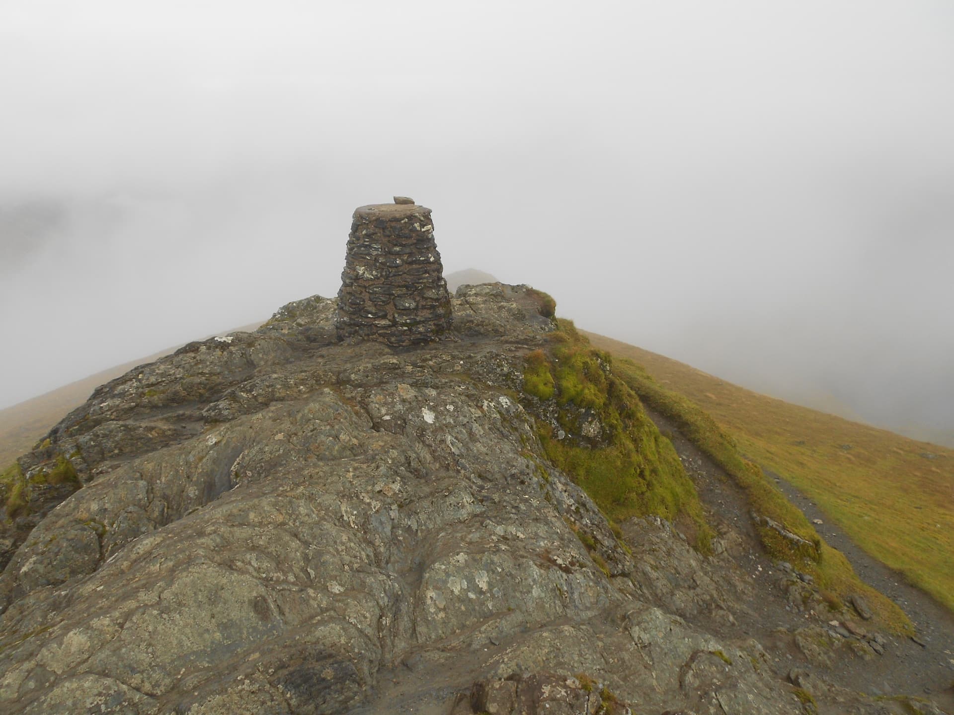

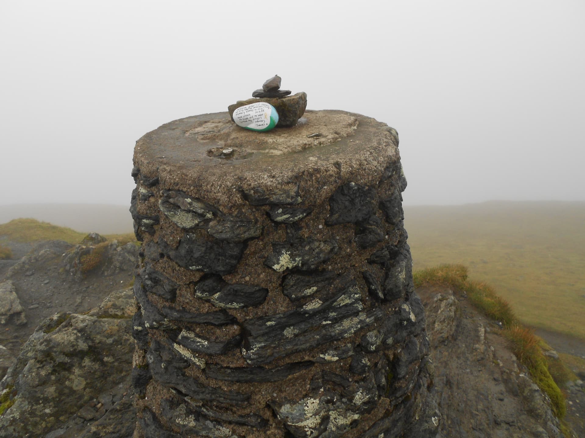

Above: GM/CS-001 Ben Lawers trig point TP-1281
Above: View indicator not that I saw any views!
Above: VHFM activation with Sotabeam
Above: Moonraker MT270M, 2m/70cm, 25W Mobile

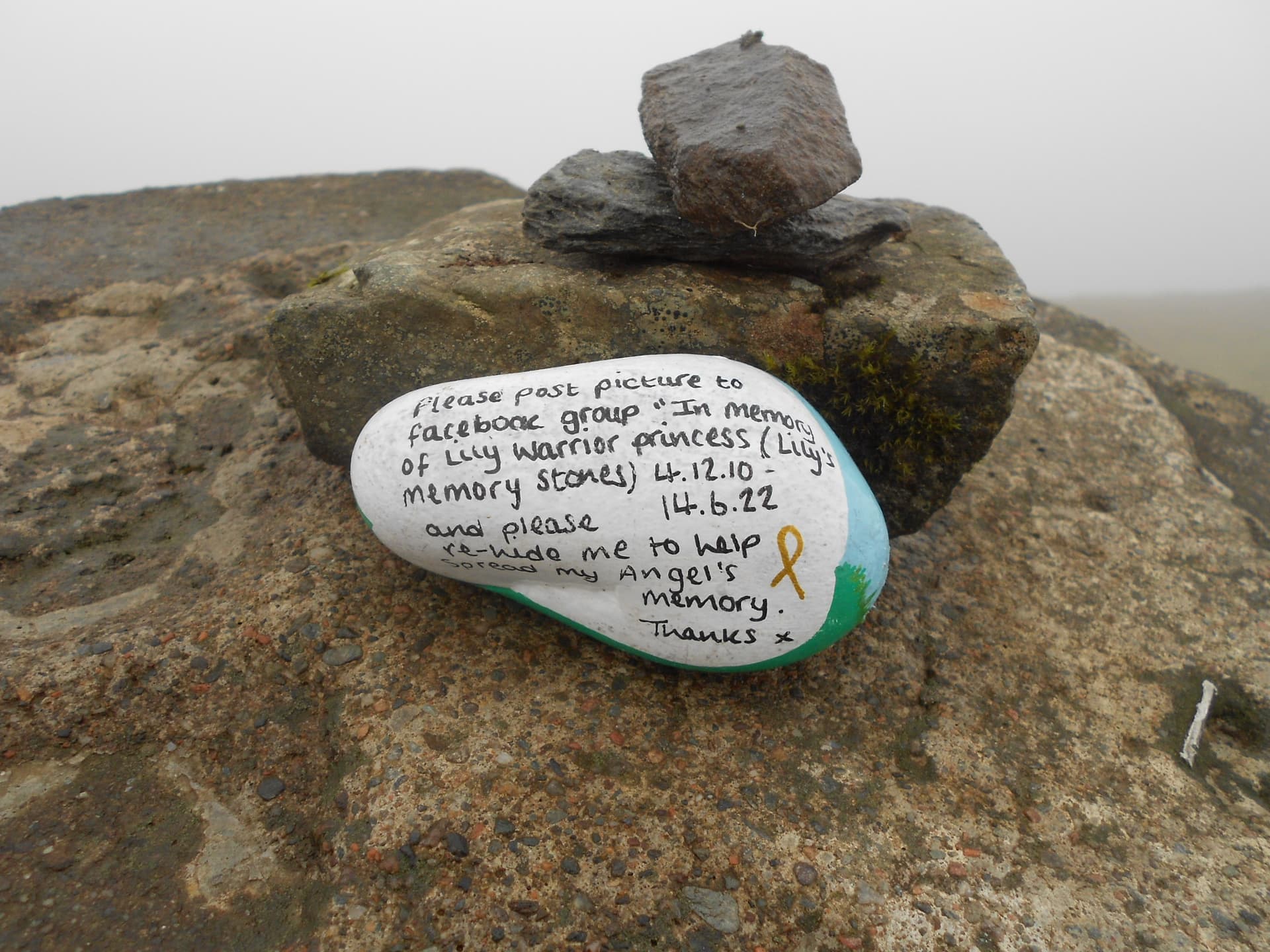

Above: The View indicator with the missing top plate plus an item that wasn’t there when I arrived

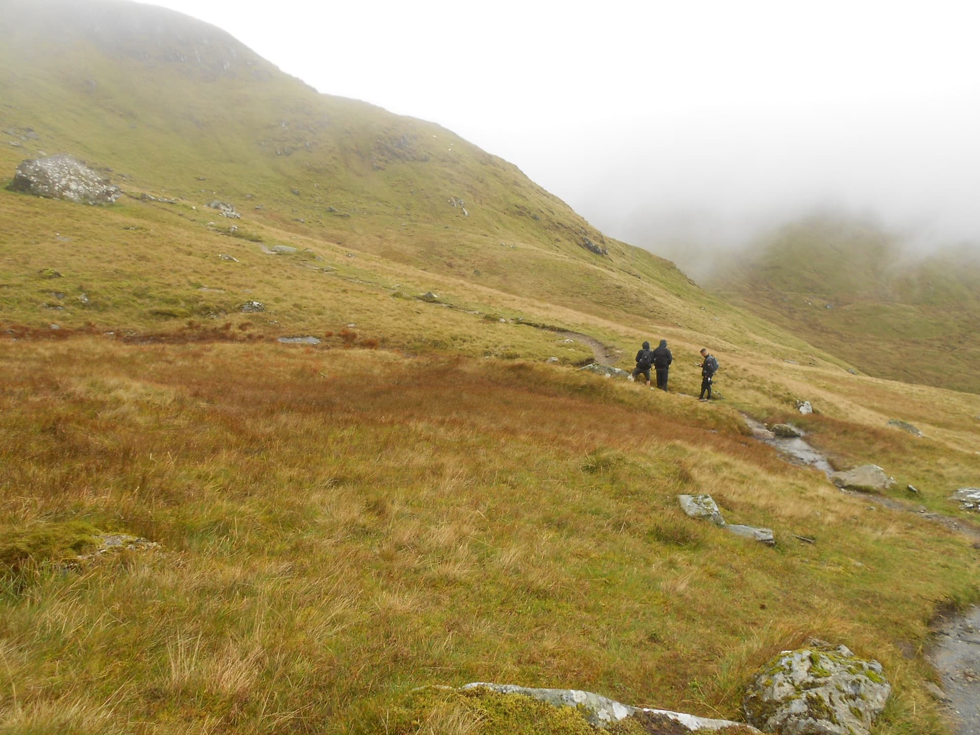

Above: On the way down and back on the bypass path

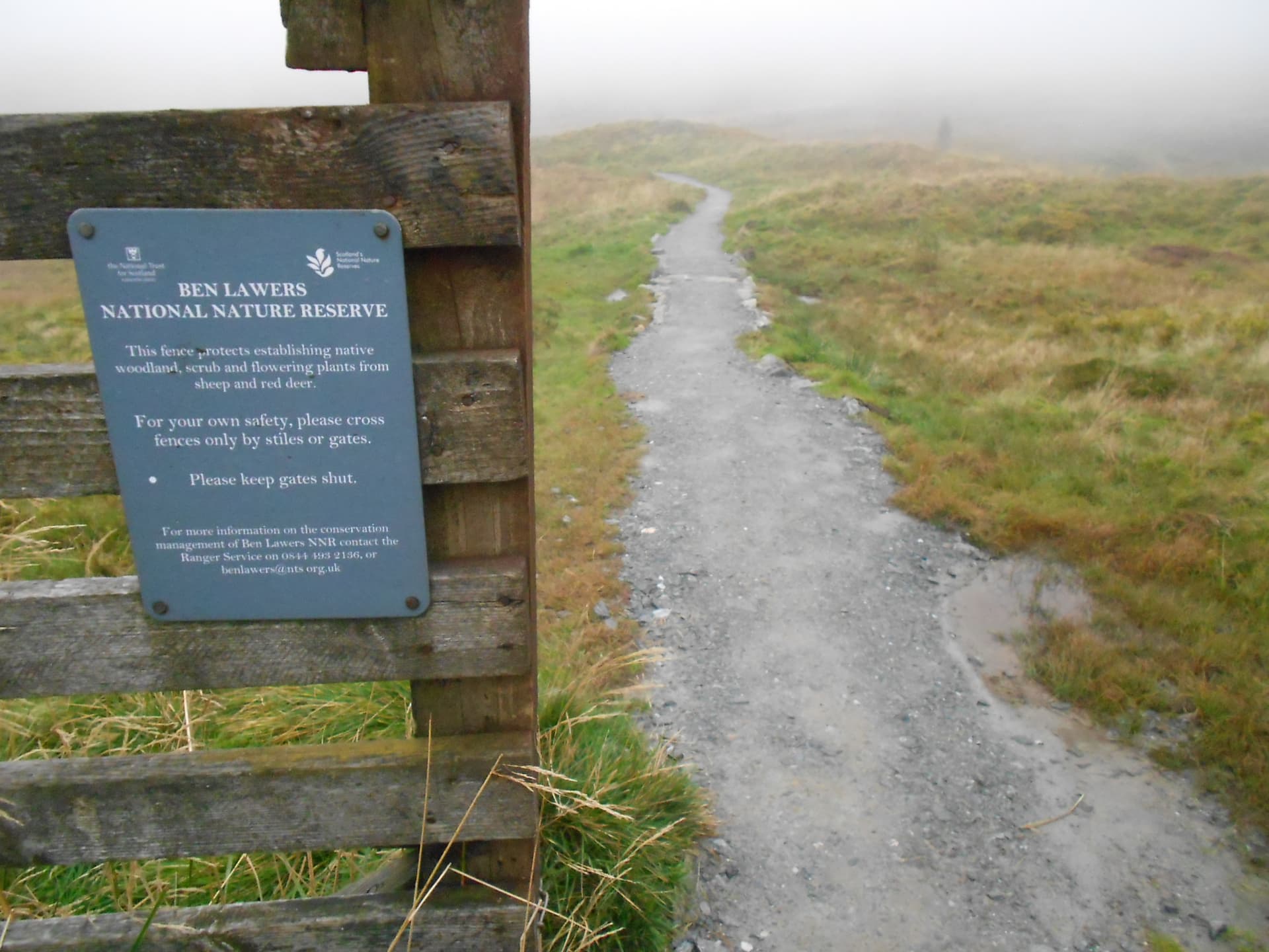

Above: Nature reserve notice

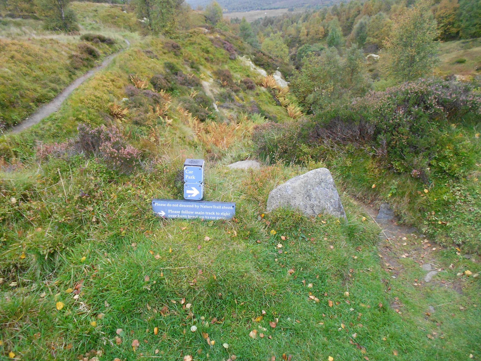

Above: A nature trail leads off the main path here. Only to be used on ascent.
