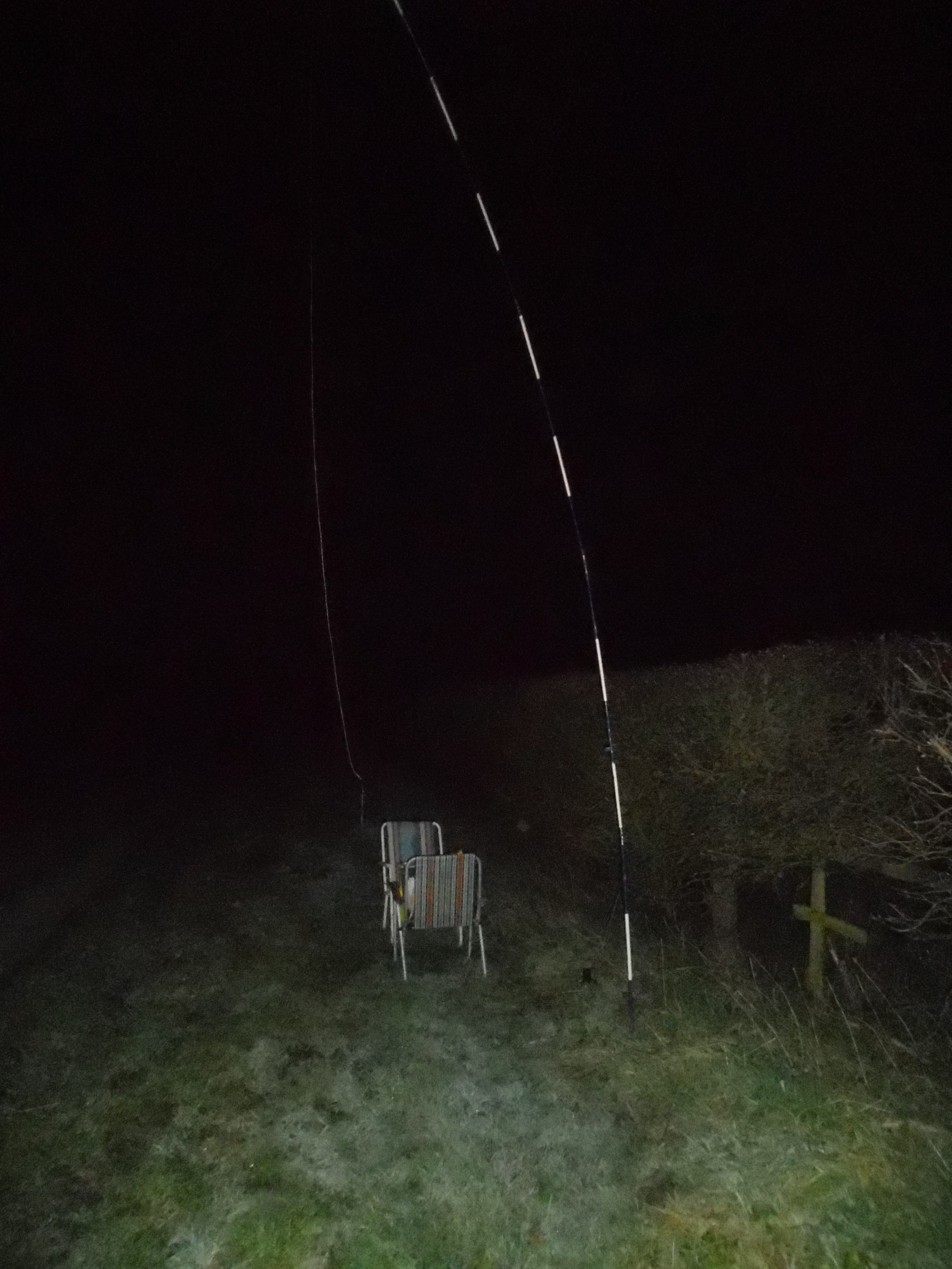

5-section 6.8m Home-brew CFC mast (Blue/ White colour coded)

The 6.8m mast and link dipole were erected leaning outwards from a very prickly hedge but while doing this I stepped back in the dark and smashed the antenna spool instantly creating another job for me! The hedge is over 2m high and it makes a good tie-off for the dipole ends, the feeder coming down to a garden chair with a second chair for the operator.
First job was to insert and tune the 160m loading coils before removing them for safe keeping until later in the evening, after which task the 20m links were pulled. I calculated in advance that the 5th harmonic of the 14MHz CW sub-band would fall into the 70MHz SSB section but that 20m SSB would be clear of the 4m band altogether. As for Top Band the only worries were the 38th or 39th harmonics which would likely be too weak to bother about.

Above: The HF station 100m down the road
Above: The SOTA HF station set to 14 MHz. Note the ‘rucksack.’ Is this really a SOTA?
