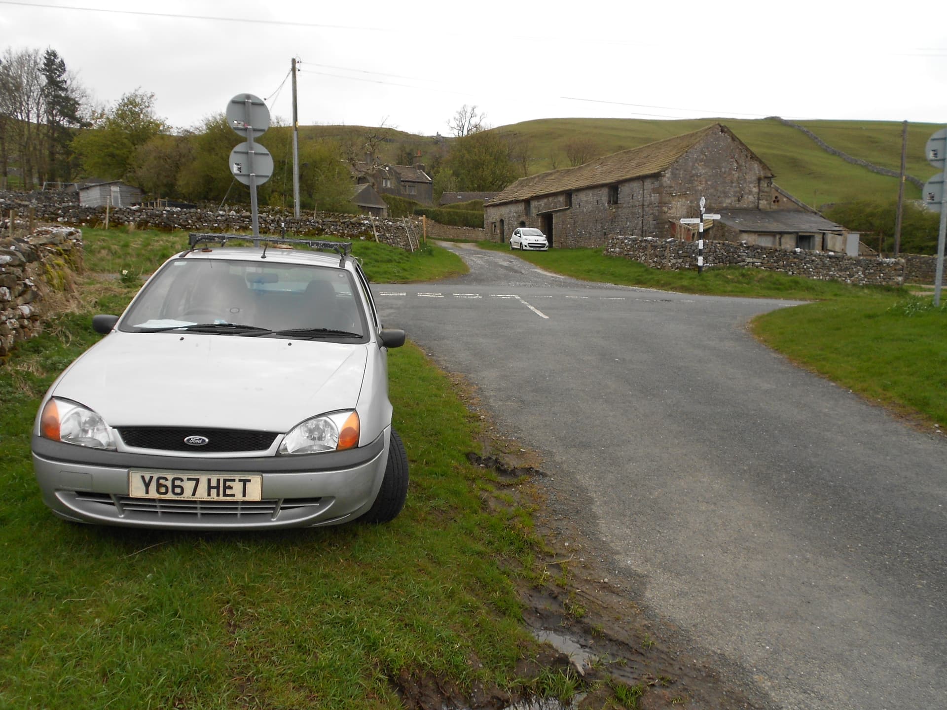

Above: Start Point for Ingleborough at Newby Cote Farm
Above: Newby Cote Farm. Ingleborough 2.5 miles (nearer 3)

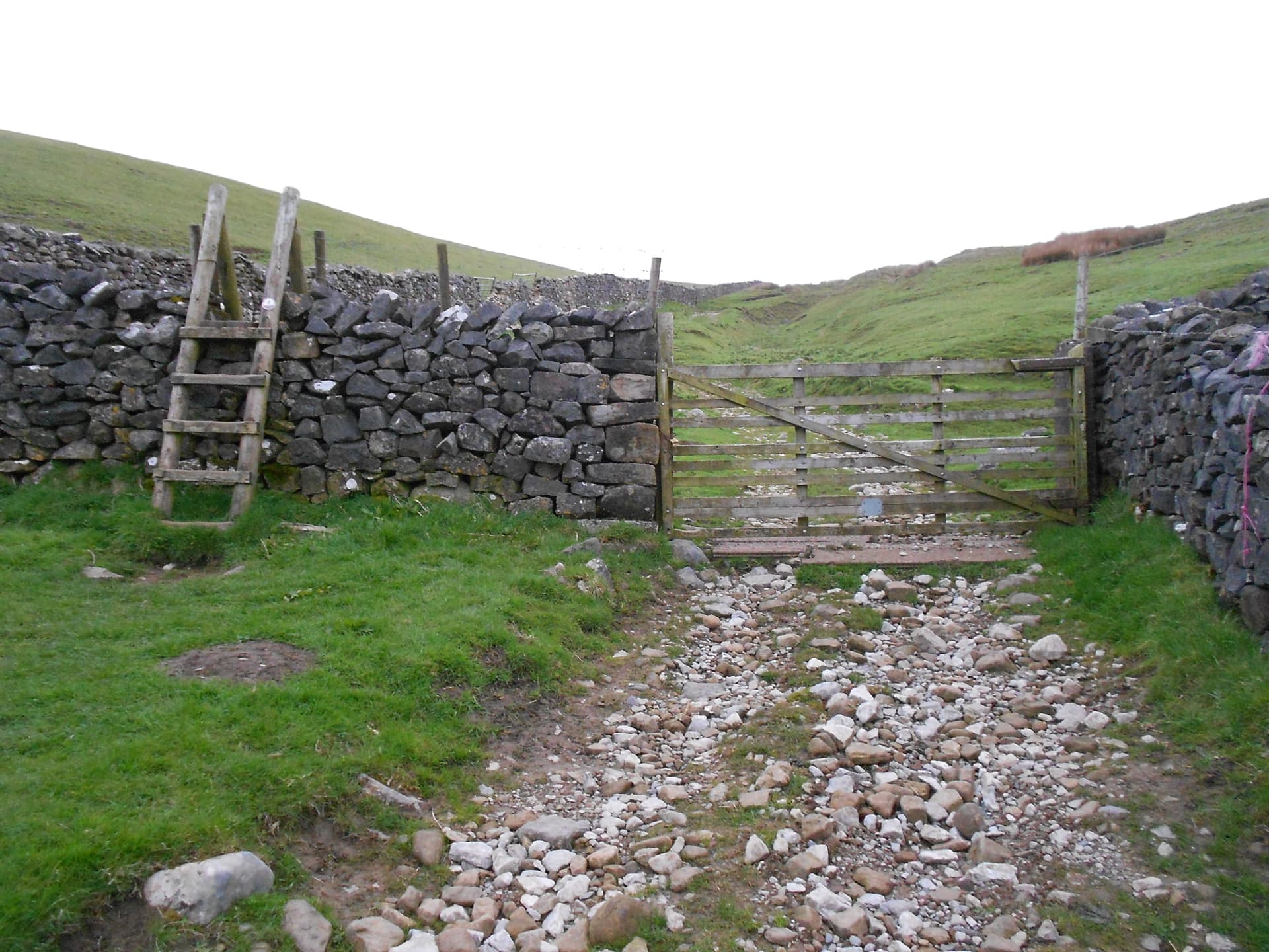

Above: Newby Cote Farm track. Exit to open fell

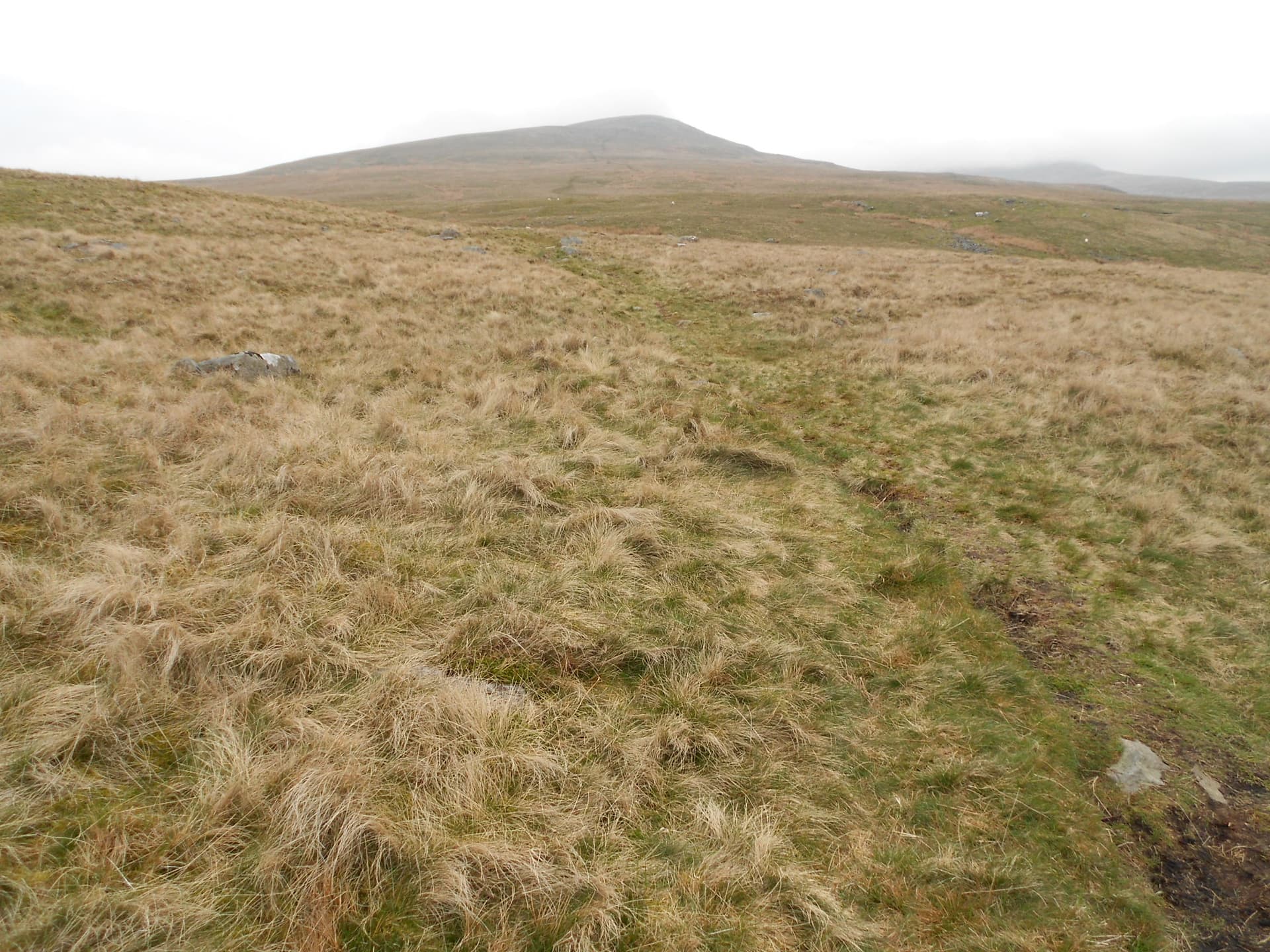

Above: Half way up the path. Little Ingleborough showing its head

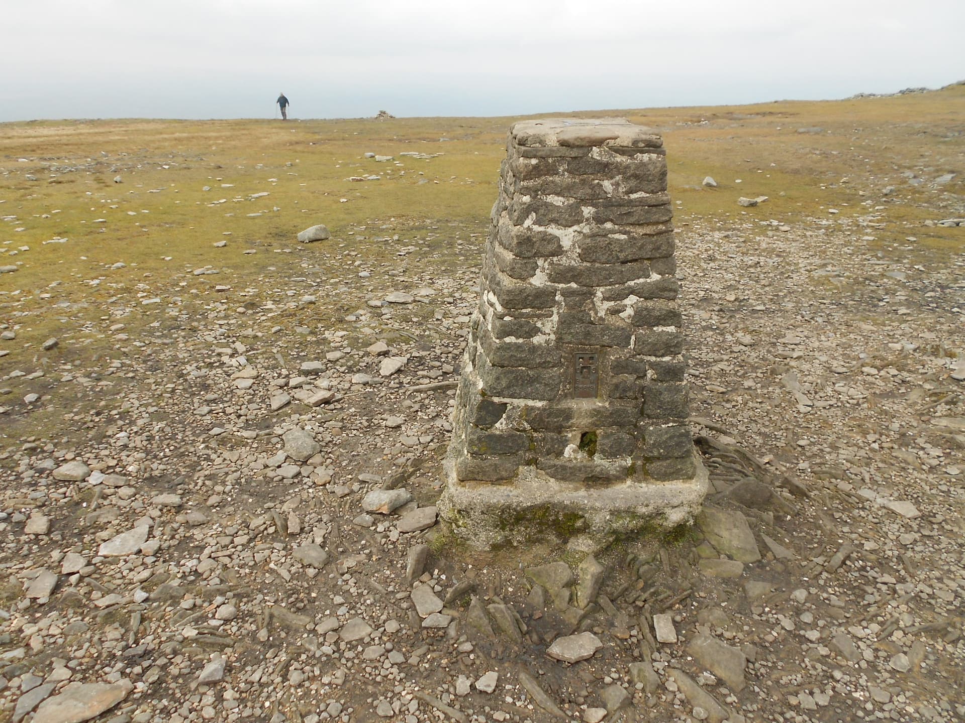

Above: G/NP-005’s trig point TP-4102
