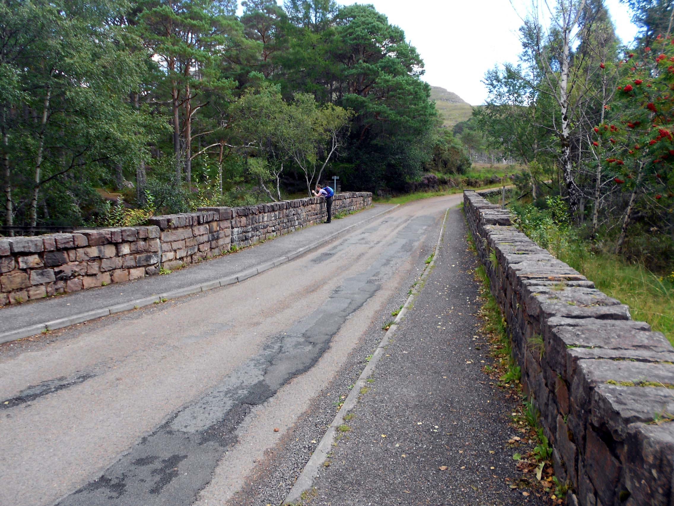

Above: NG 8690 5766 on the A896 is the WS98 path start point, just to left of camera position. The car park is out of frame to the right. Someone is photographing the waterfall.

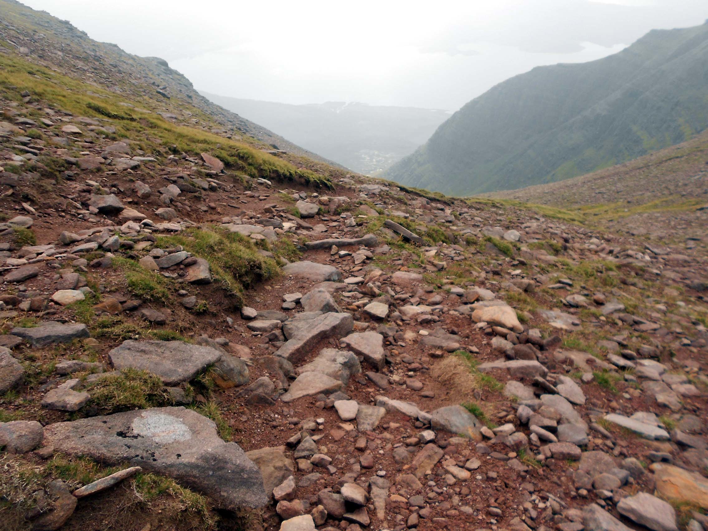

Above: The higher reaches of Coire Mhic Nobuil on the way up WS98 showing the rougher path.
