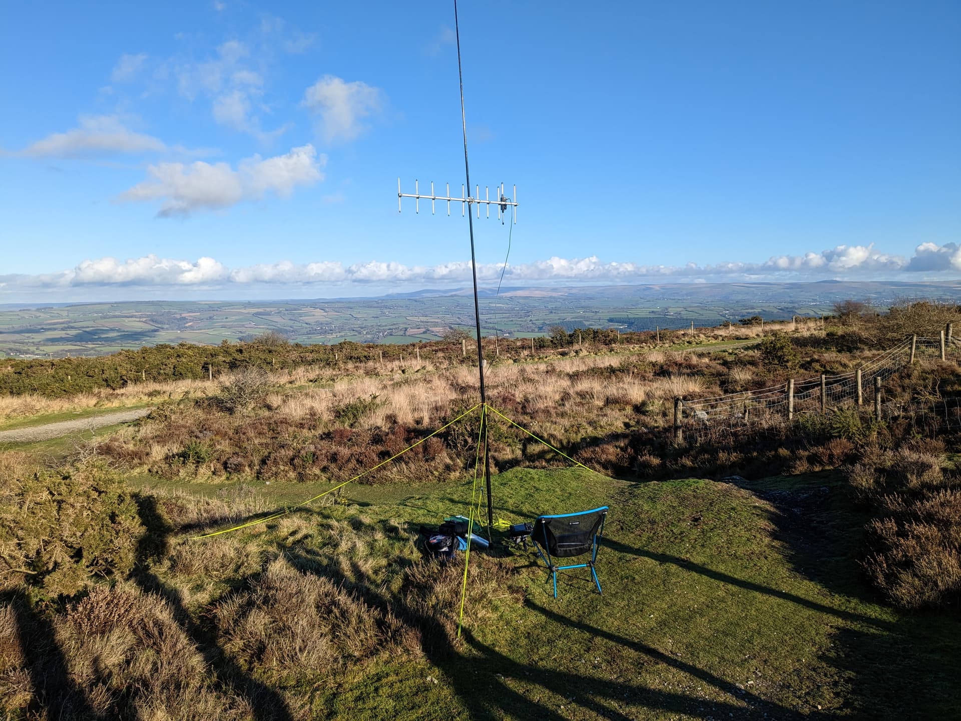

I then took down the wire antenna and tried my new 10 element 70cm Yagi. I wasn’t expecting any replies but Derek 2W0FLY responded from Swansea which gave him a complete as he has previously activated G/DC-003. The photo below shows this antenna in use. I was running out of time so didn’t try 70cm SSB which probably wouldn’t have yielded any results anyway. I will try on another date but it will need setting up by advertising on here first.

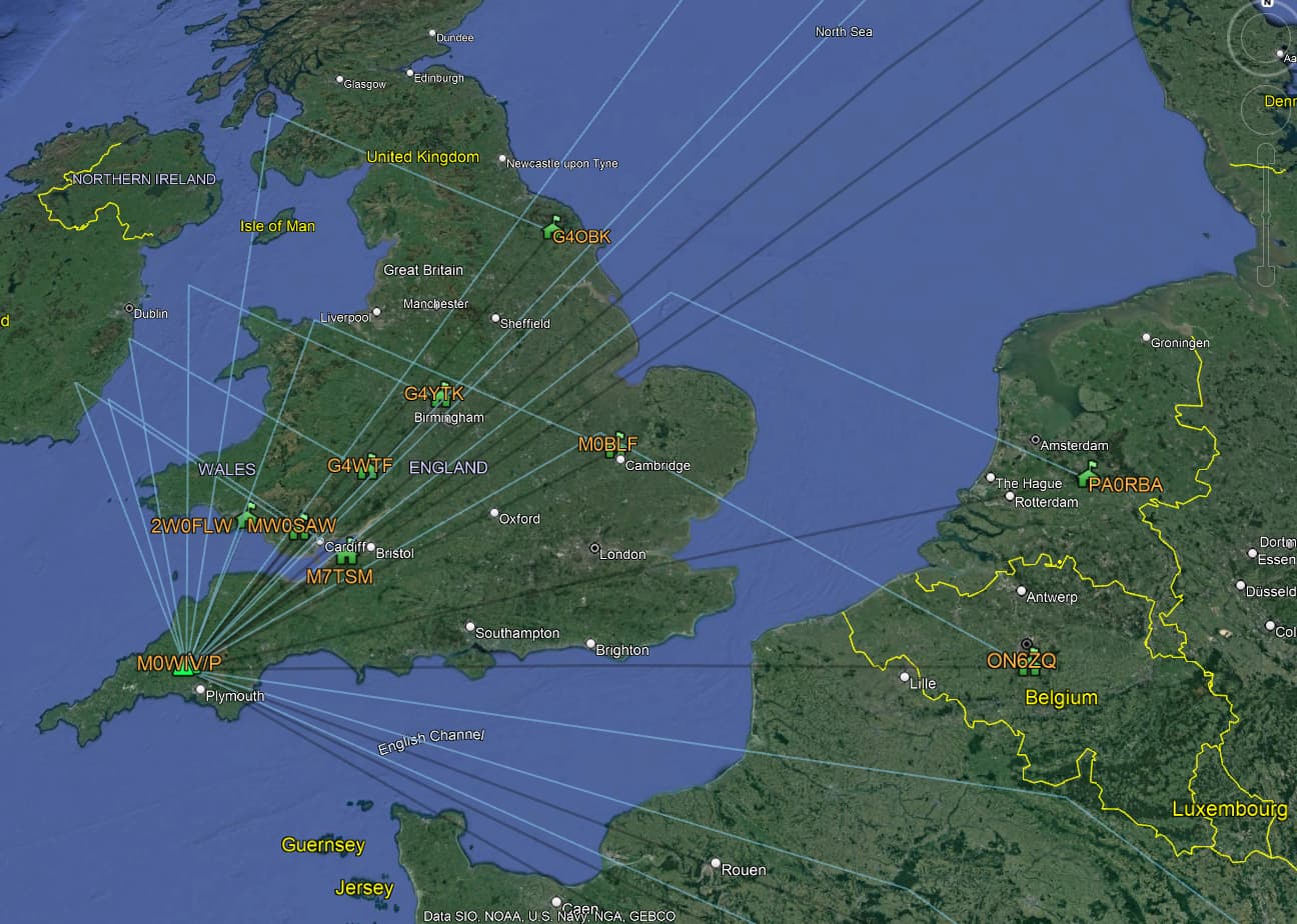

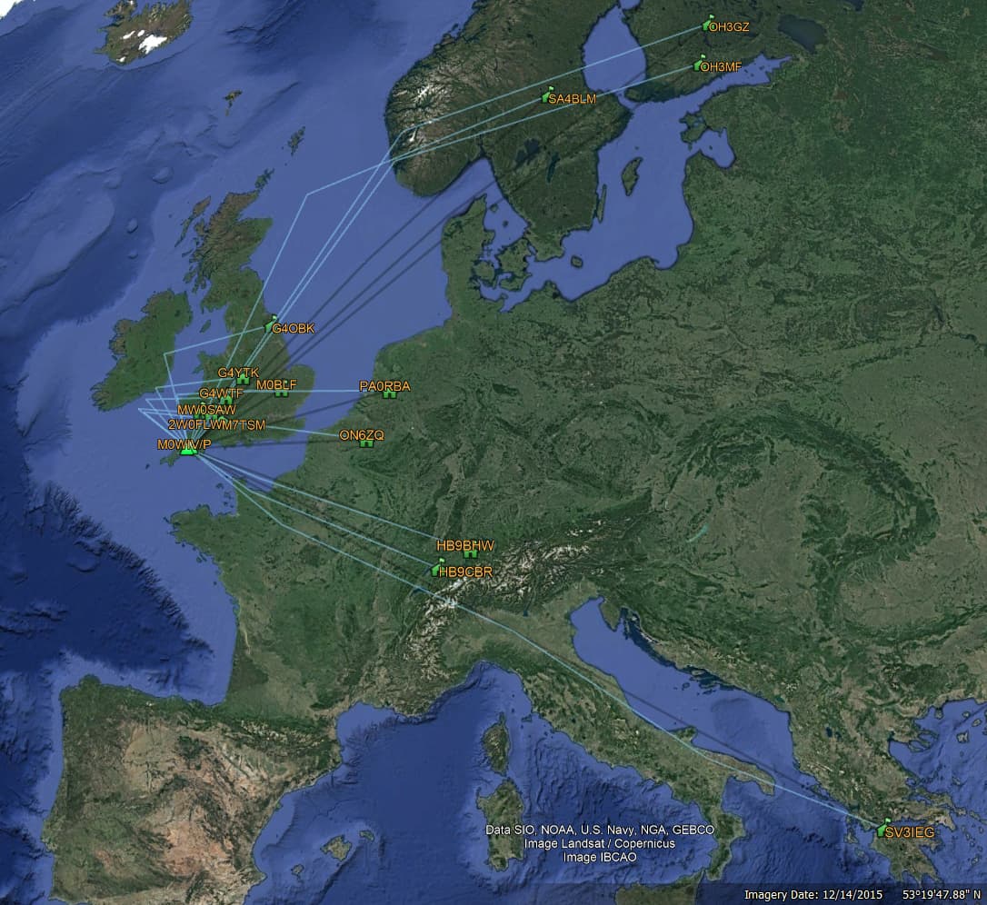

The maps: (F4JBC/P not shown as this QSO was a belated entry.
Operating position when using the 70cm Yagi:
Thank you for the point, report and maps John - very interesting to see an activation’s QSOs in that way - puts it all into perspective.

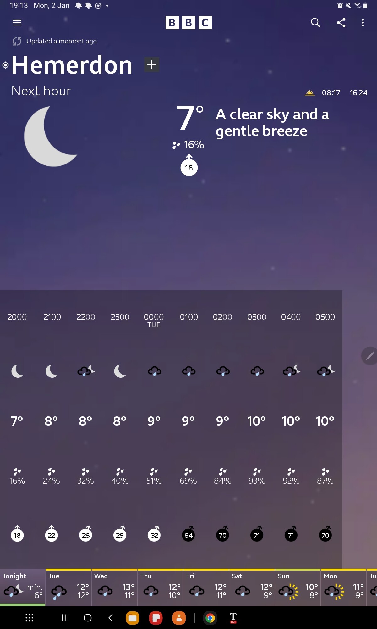

Ludwig, thank you, the weather was amazing. Air temperature about 6C when I arrived but the sun was shining and there was zero wind. The rain and gales return tonight! The wind speeds shown below are kph.
