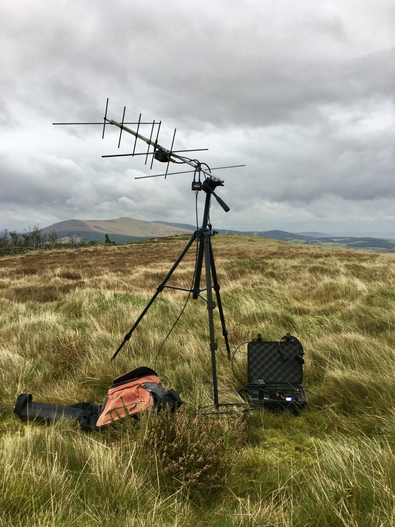

On the first picture is my satellite antenna acting as a terrestrial with UHF 5 el beam removed until sat comes in.
