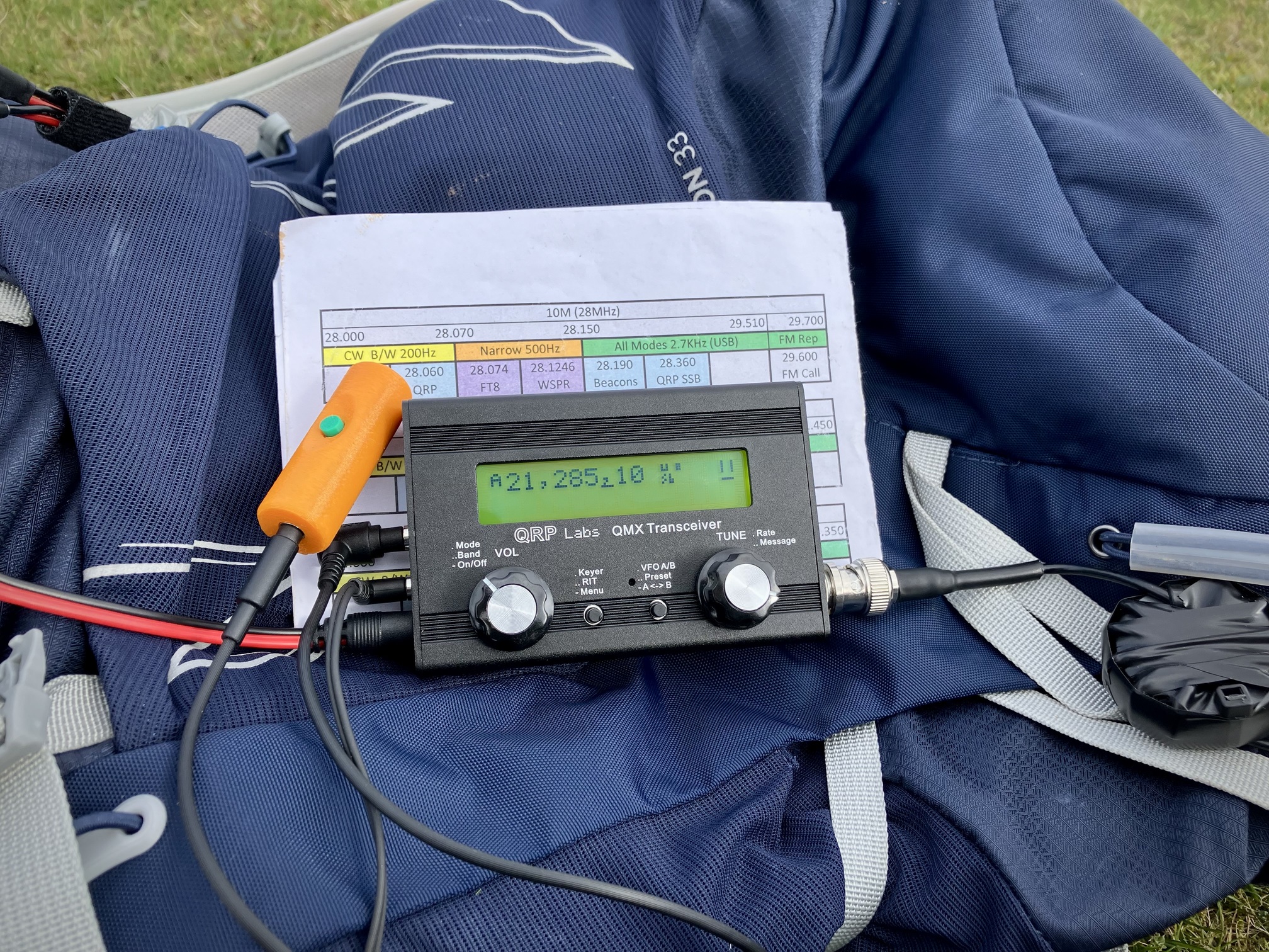

The radio:
Everything (apart from the antenna and mast) fits into an A5 padded envelope with room to spare. Small and light - perfect for elephant leg.
Previously, I had a G106 - it was a similarly powered radio but much bigger and heavier. I could write pages about this, but in a nutshell I much prefer the QMX. Very pleased (so far).
