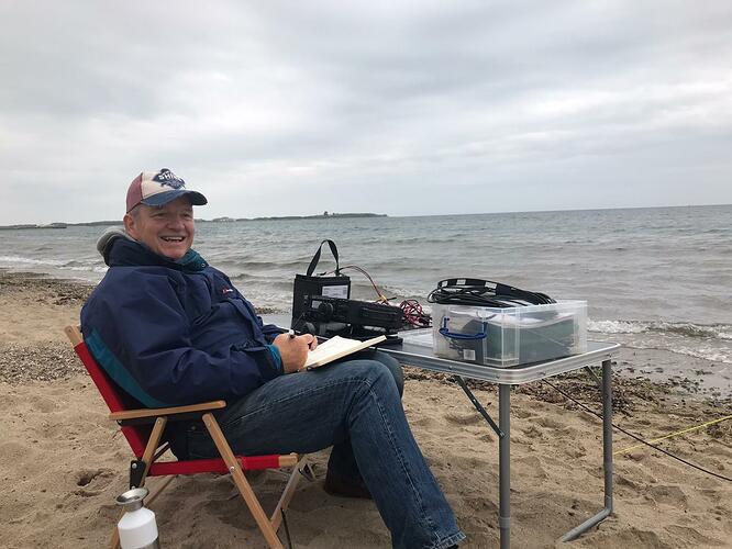

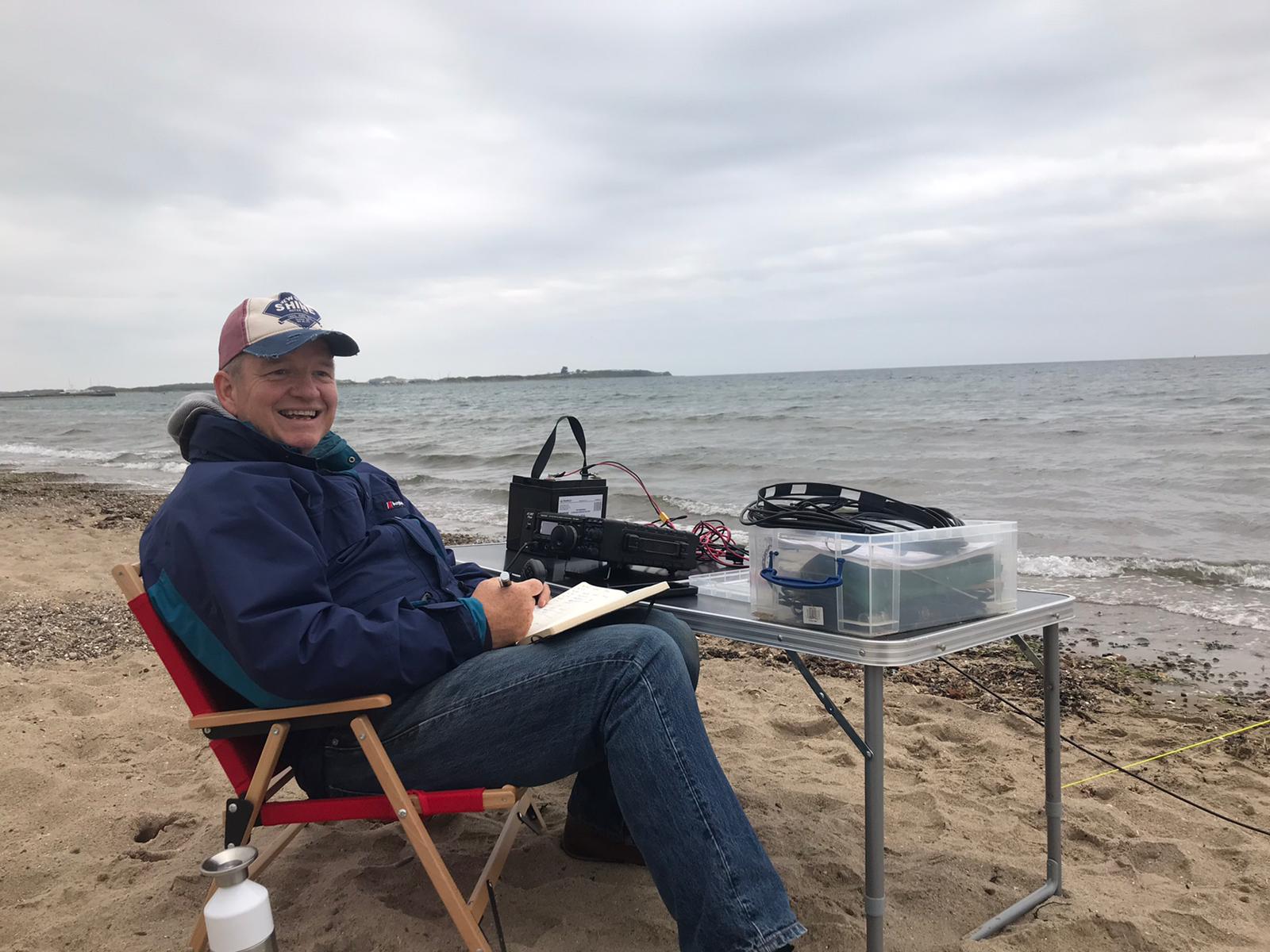

Thanks for all the answers everyone. Apologies if I haven’t responded, but we have been staying in Harlech for a few days.
These pictures were taken on Thursday evening, just before the rain set in. Unfortunately Friday was a wash out, so I didn’t get a chance to try again. As you can see, I am not very “mobile” with this setup!
Well, I started looking for a KX2 second hand, and instead came across a KX3 which is in excellent condition, and actually came with a T1 tuner, all for an attractive price. I decided to go for it, on the basis I can get something lighter in the future should my activities dictate a need. I am now sourcing BNC connectors to get my antennas working with it, as my ft-897 has SO-239 connectors.
With luck, I will have a go at activating in the next week or so!
