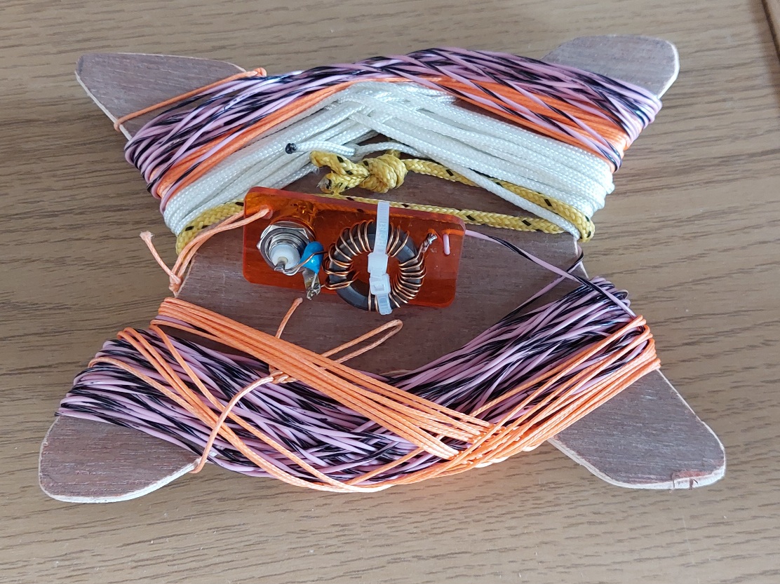

Have a watch of K6ARK’s recent video on his “smallest possible all-mode” set up. From what I can tell, he has one of his matching units attached to a wire cut for 80m, with marks on it for different wavelengths, and he just unwinds it to the length he needs for a band. Regardless of whether you take this approach, Adam’s kit instructions are really good for building an endfed.

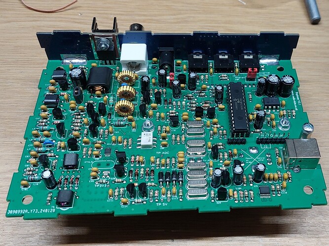

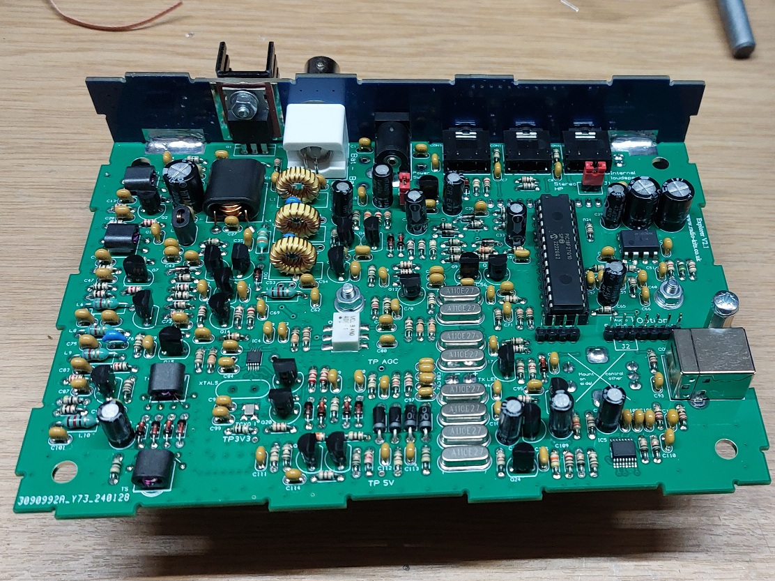

I’ve finished swapping the band parts on my Radio Kits Explorer this evening. The reworking went without issue, you can’t even see where I’ve touched.
I’ll apply power tomorrow, I wanted to read the manual to work out how to reset the firmware or whether I need to reset it at all.

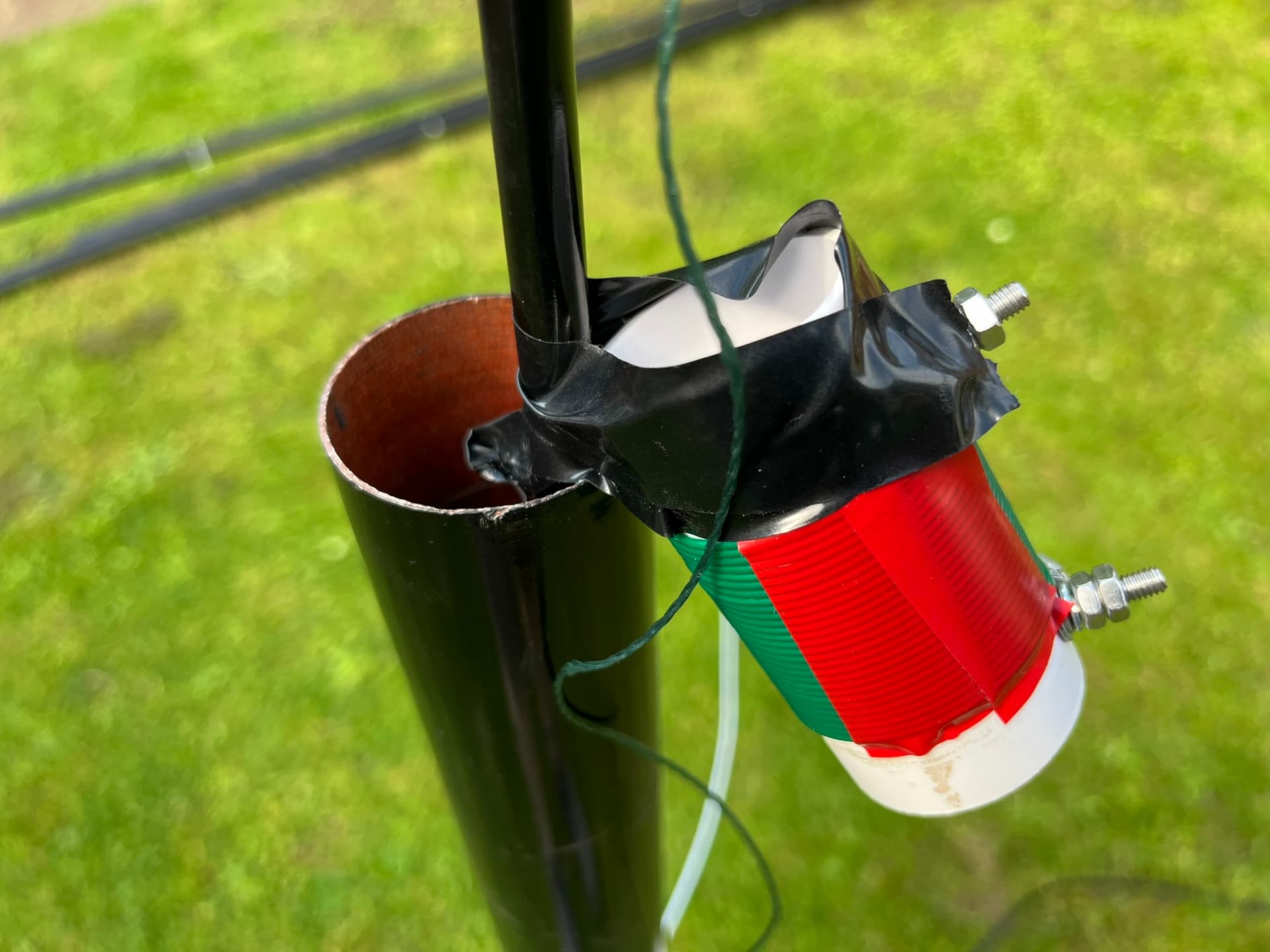

I’m using my 5m pole to hold up the EFHW and I’m using the EA2BD method of attaching the wire to the pole.

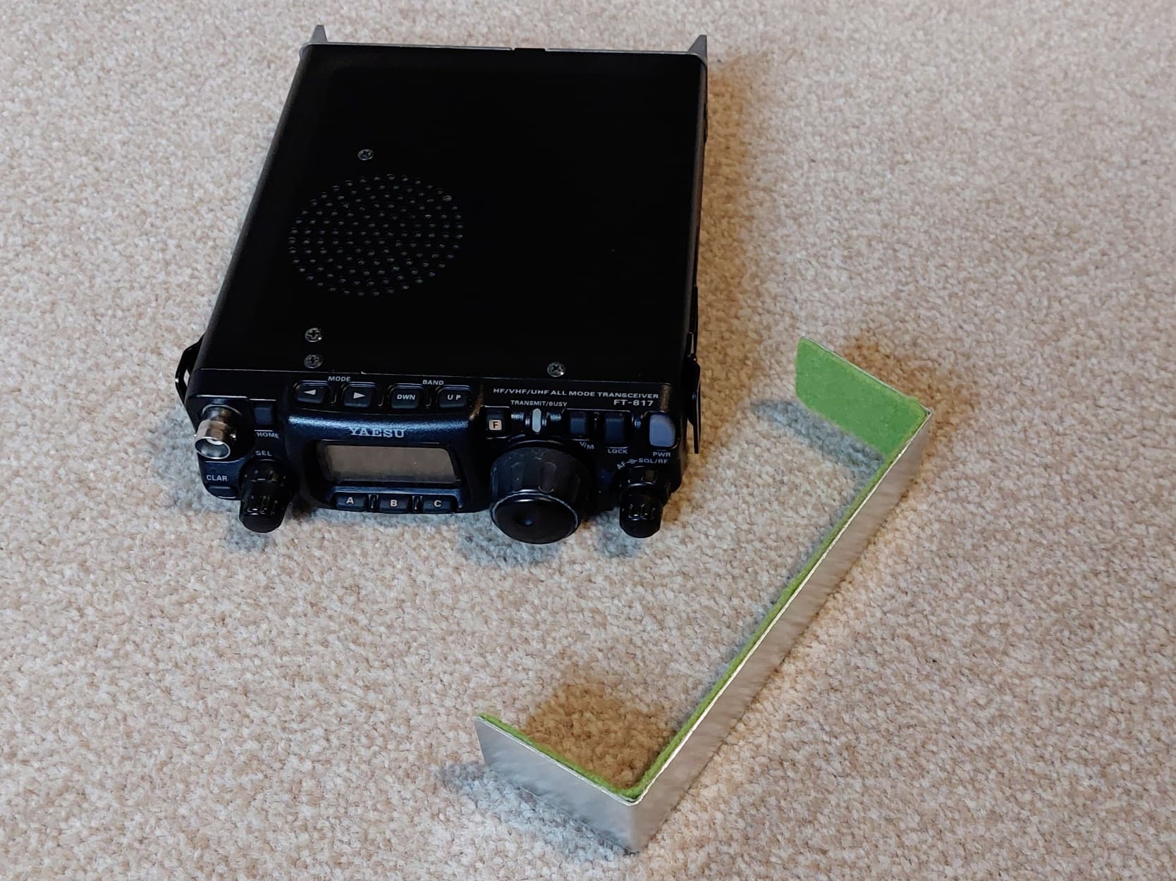

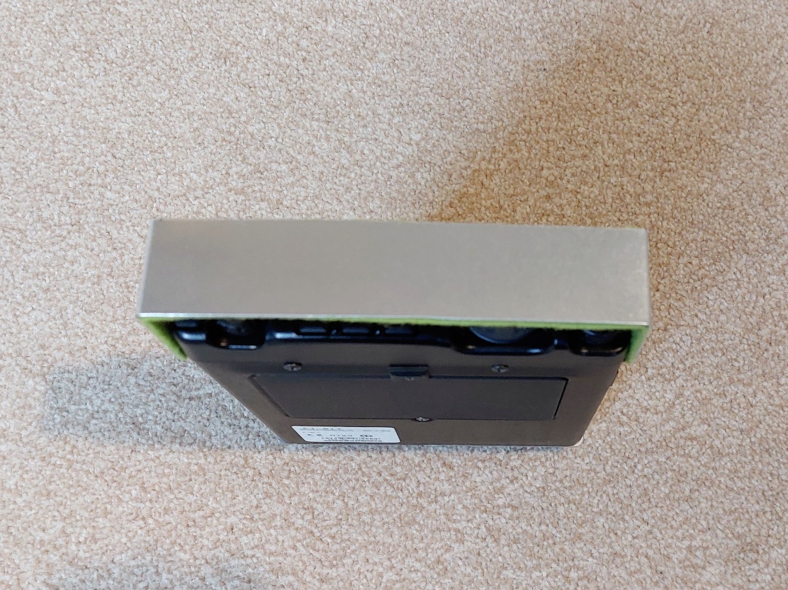

I have decided to use my FT817 as whilst it’s twice as heavy as the Radio Kits Explorer, it does not need a high voltage to run it. My only 4S LiFePO4 weighs around 750g, whereas 2 off 3S lipos with the same aH total weigh half as much, at 330g. The FT817 offers a built in VSWR ‘indication’ and other bands. When all is added up, it makes more sense to take the heavier FT817 as it needs less ancillary items. I’ve saved a little bit of weight from the FT817 by ditching the vinyl case (which weighs more than my MTR by itself!) and fabricating a control protector with a strip of aluminium (15g).

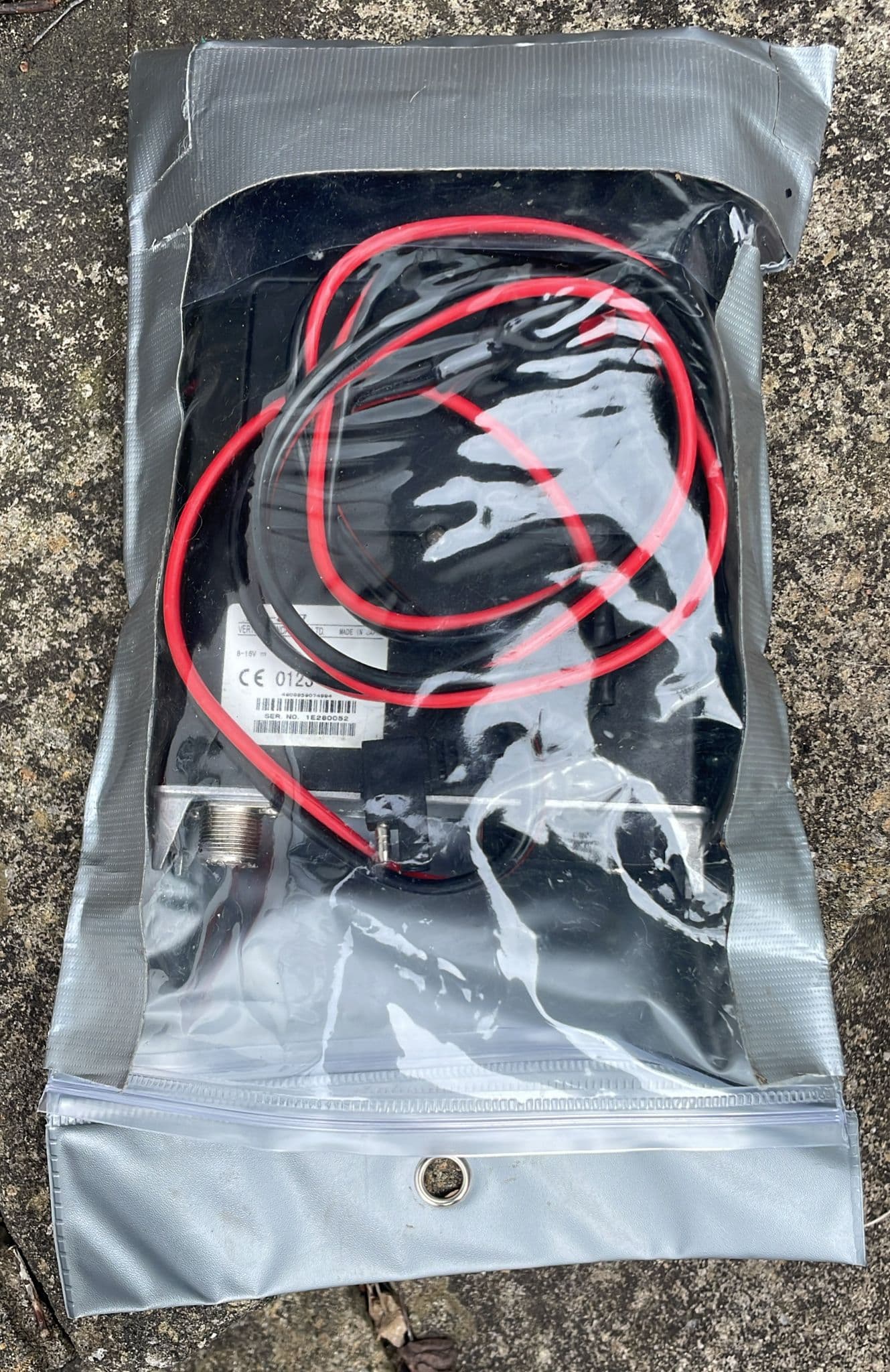

Hi Colin, I’ve made a lightweight (53g) water-resistant carry bag for my ~21-year-old FT817 by ‘sawing off’ and gorilla-taping the end of one of those resealable thick-plastic pouches that miscellaneous AR items are shipped in.
One doesn’t need a hard-shell case to protect the rig if it’s in the middle of the rucksack wrapped or surrounded by soft items.
