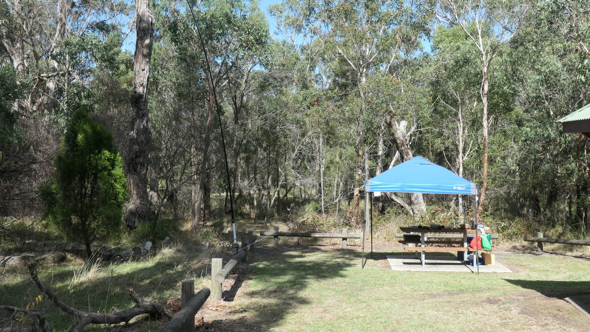

The area has numerous picnic areas with tables and BBQ for all to enjoy. My preferred location is a small, grassed area that has a quiet walking track on one side, and is across the road from a convenient car park. It has a sheltered electric BBQ and two picnic tables with bench seating.
It is also a relatively short drive in the bush between the summit and the freeway, minimizing the risk of collision with kangaroos after dusk.

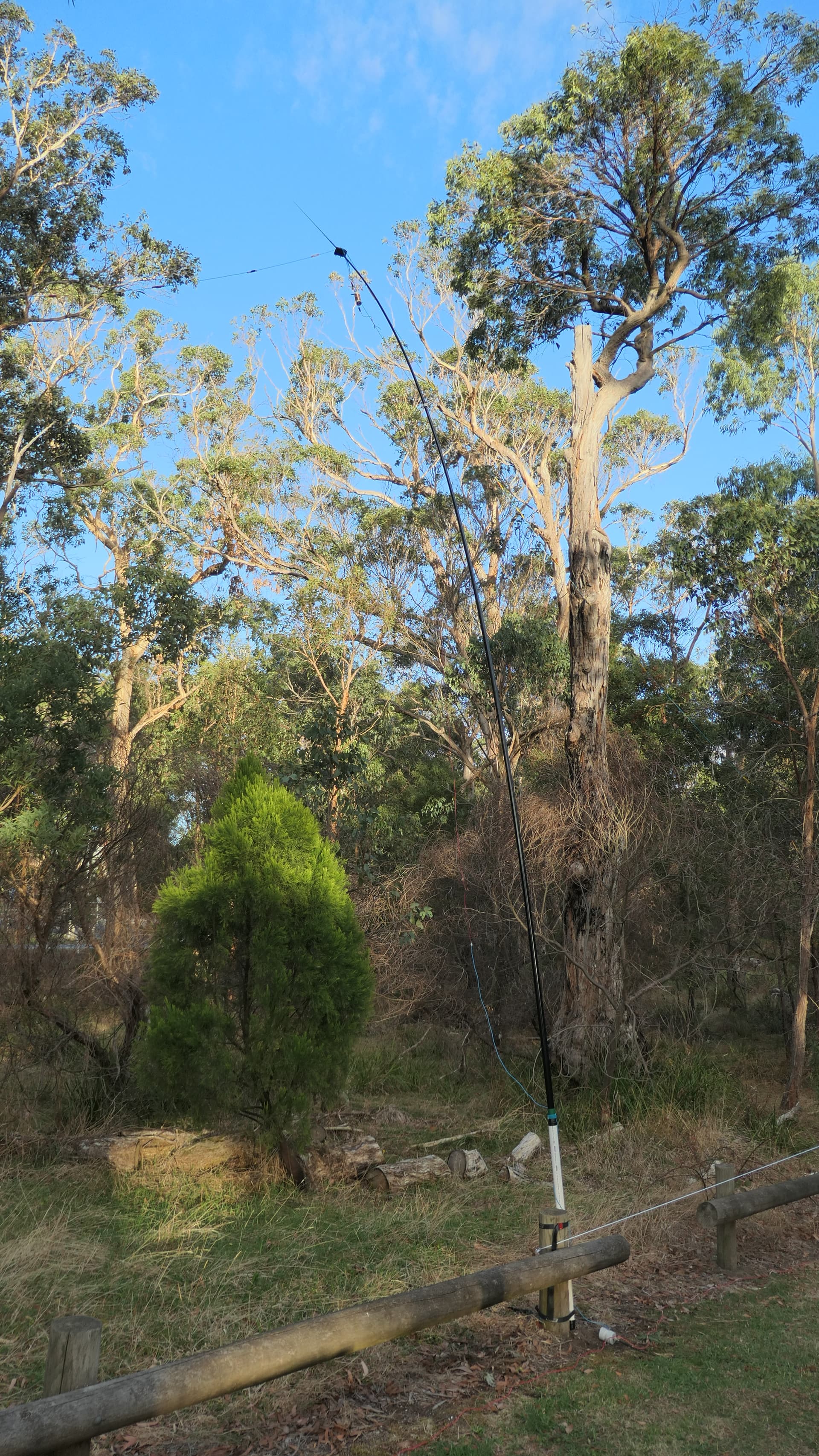

The station consisted of a Yaesu FT450D radio, 100 Ah LiFePO4 battery, Lenovo laptop, SignalinkUSB interface, link dipole (80m – 2m), 9m fiberglass squid pole and some extra wires and an 80 turn tapped 165 uH inductor for use on my 160m antenna.
Arriving at about 11am, 0100 UTC, I set up for the day including a 2.4 x 2.4 m portable gazebo over one of the picnic tables for shade, and the link dipole on the squid pole set as an inverted vee.

Stuart VK3STK arrived about midday, and we spent the next two hours talking about SOTA, WWFF, FT8 and a few other topics as well. Eddie VK3SRT arrived around 1:00 pm and joined in the discussions.

Eddie and I then changed the antenna to be a top loaded T shaped radiator with two radials for 160m. The vertical section of the antenna is a 7.6m length of wire that then connects to the 165 uH inductor. The inductor then connects to both side of the link dipole, shorted at the middle, with the link dipole opened for the 17m band (about 3.8m in length) making a capacitive top-hat. The radial wires are 9.7 m long and lay on the ground, directly under the top-hat wires. This is the same antenna I had used one week earlier at VK3/VC-037.
At first the ATU in the FT450D couldn’t match the antenna system and the VNA sweep showed SWR greater than 6:1. Lowering the centre of the antenna we discovered the crocodile clip to the top of the inductor was disconnected. Duh! Once connected and raised back up in the air the radio’s ATU was able to provide a reasonable match from 1825 – 1855 kHz.

Just before dusk I returned the antenna back to 160m, however the ATU wouldn’t match the antenna. I lowered the centre of the antenna and, with light rain falling, I discovered I had forgotten to reopen the 17m links, so the top-hat section of the antenna was too long. Doh!
After putting the antenna back to the top of the squid pole, I returned to the shelter to find the rain had been blowing in and my radio, phone and laptop were now wet, and the ATU still wouldn’t match the antenna.
At 1811 local time, 5 minutes after the official sunset, I sent a QRT spot to SOTAwatch and packed away all the equipment in the rain. While packing away the antenna, I noticed an open connection that may have happened during the take-down or may have been missed during the earlier change from 20m back to 160m. Either way the wet radio, wet laptop and wet phone had confirmed it was time to call it for the day.
