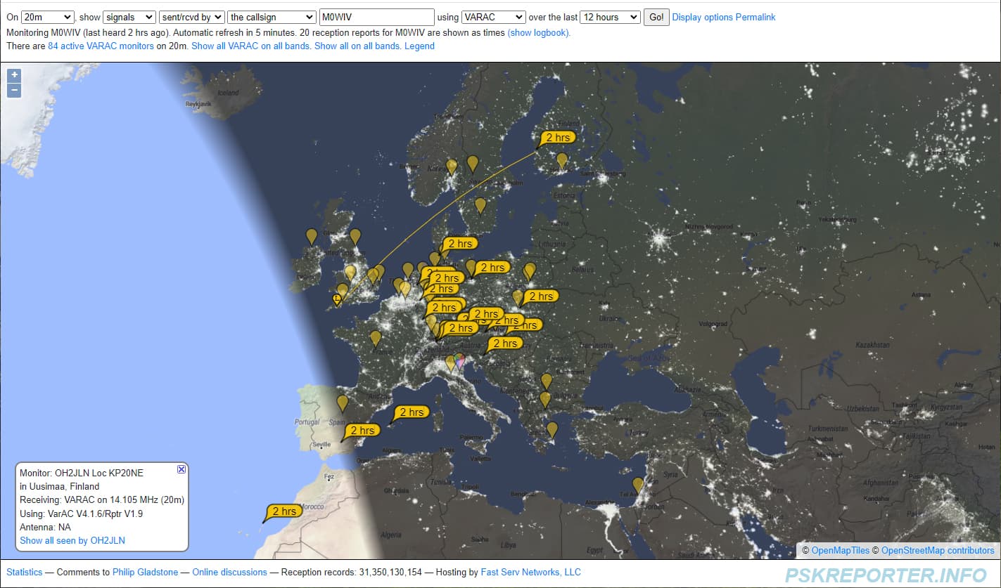

Looking at pskreporter later my 20m VarAC calls were getting out.
On 15m only one station in Europe reported my signal on pskreporter and on 10m again only one station heard me - but it was in the USA!
Psk is showing my callsign above as M0WIV because in the CQ call it cannot handle complex callsigns. Apparently, had I established a link to another station it would have sent M0WIV/P but as I didn’t get that far I can’t confirm this.
