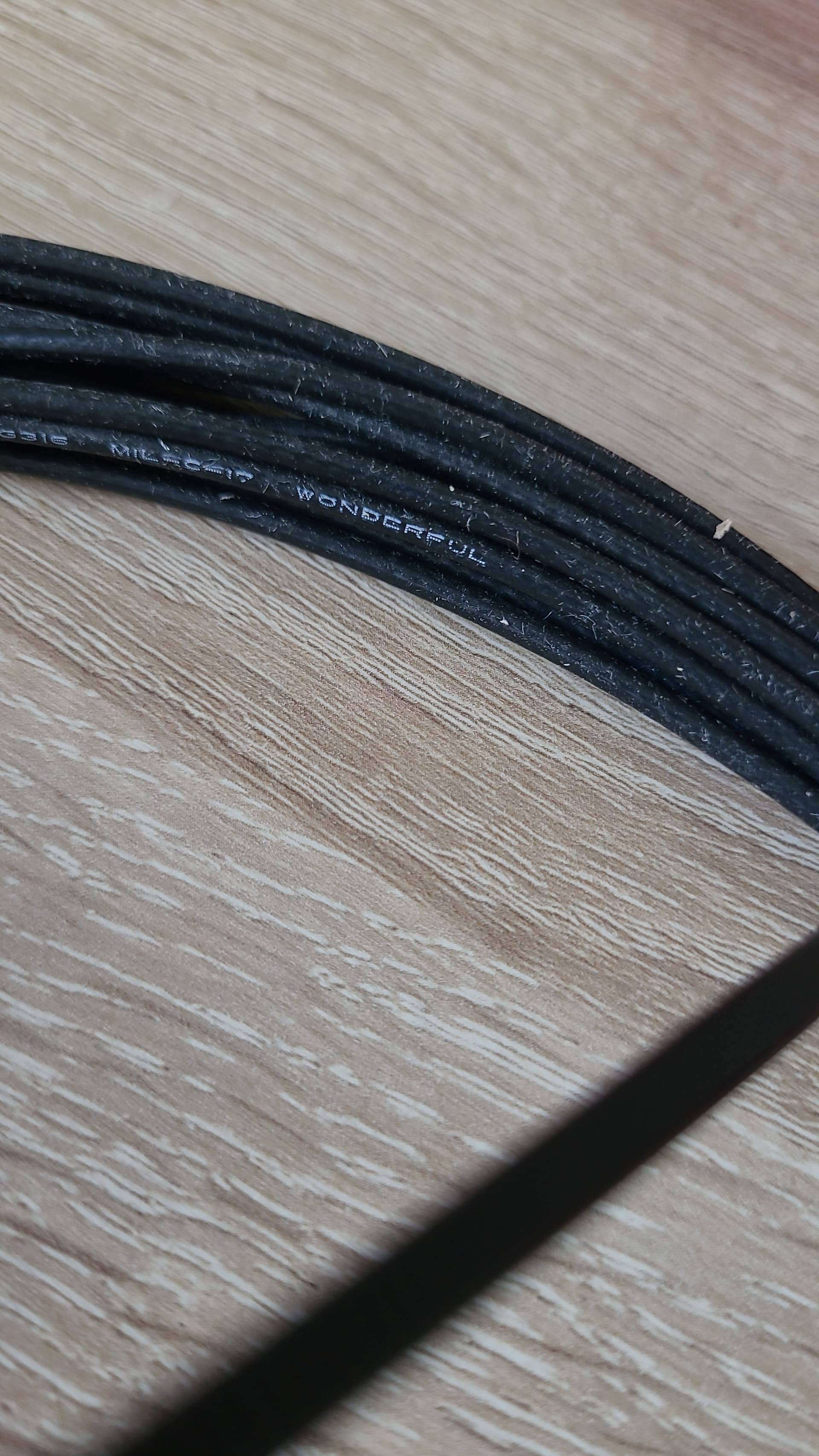

My RG 316 arrived…
I am a bit amused, it says wonderful… What does that mean, I know its a wonderful cable but…
Doesn’t look like any RG-316 I have ever seen. Outer jacket is normally transparent FEP.
It seems the manufacturers name is “Wonderful”. A company apparently from Malaysia… Well, how did I end up with their cable, I dont know. Obviously some surplus at Wimos warehouse. However, physically the cable makes a pretty sturdy and solid impression.
However going through their datasheet it seems it has higher attenuation than a RG174 :thinking:
http://images.100y.com.tw/pdf_file/03-WONDERFUL-RG316U.pdf
I’ll send it back.

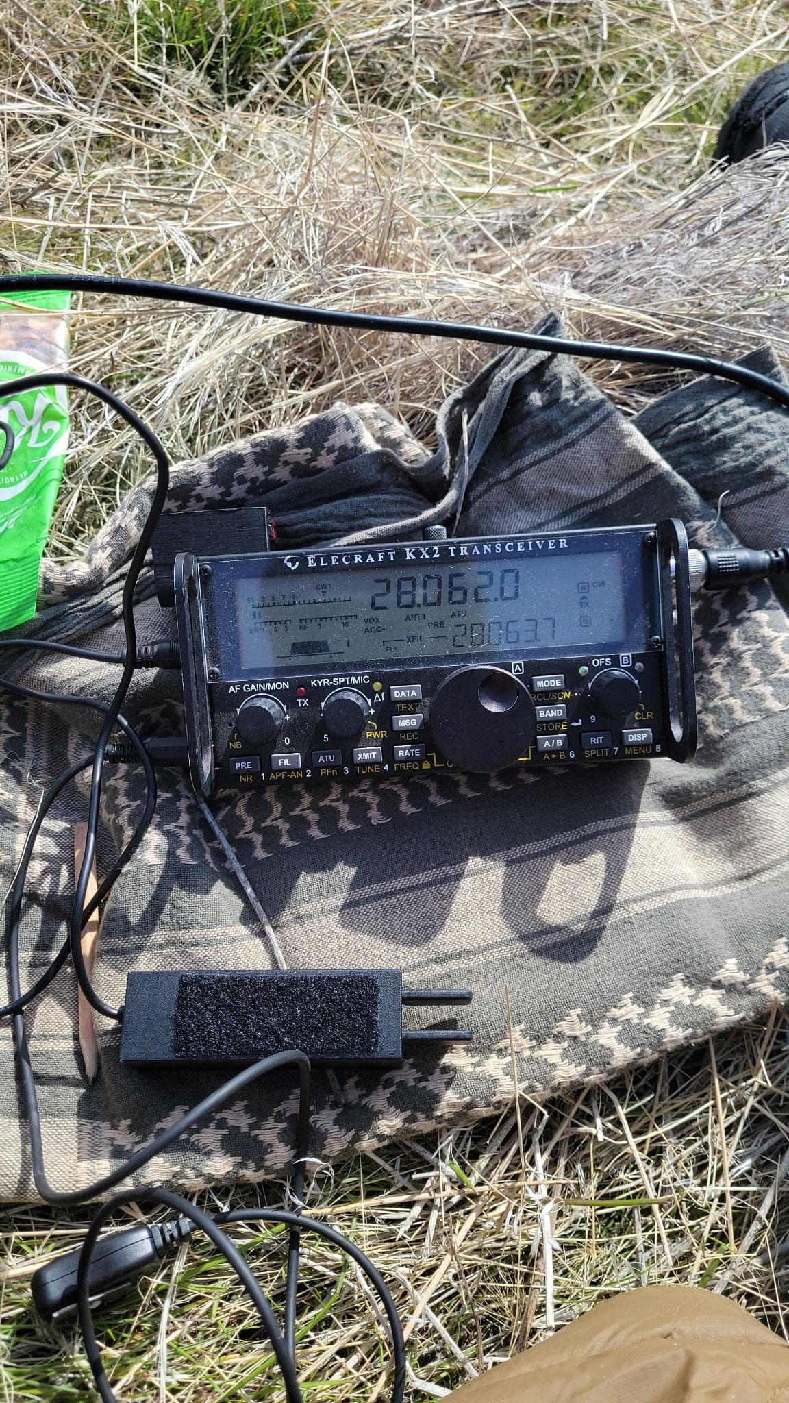

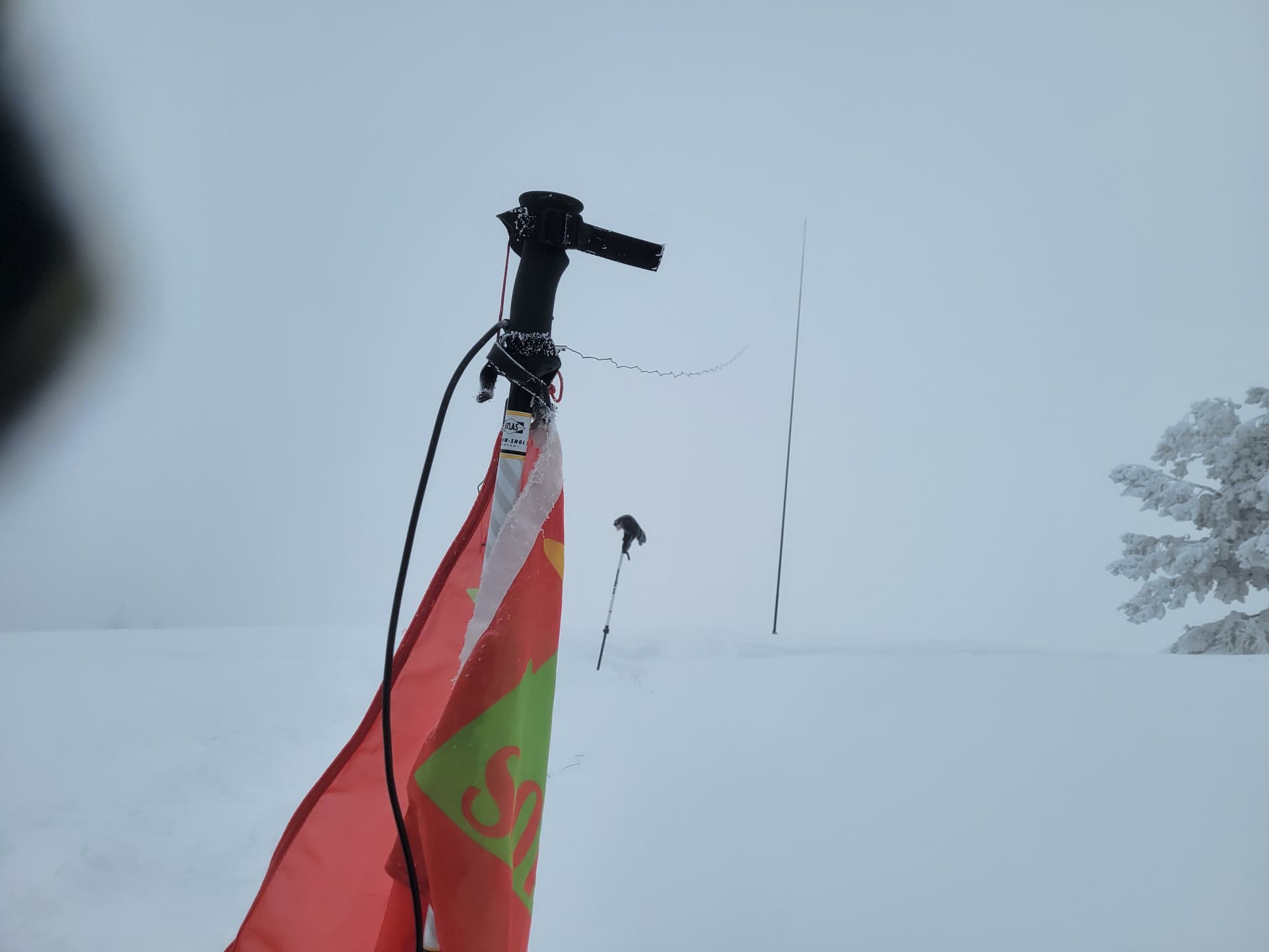

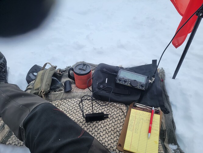

I use a 3Ft piece of RG58 for my endfeds, usually rigged as a sloper. Coils up small and is easy to handle with gloves and in the cold, very durable under field conditions.
This was taken yesterday. Long time since I made a QSO on 10 meters!
Another shot doing an activation a week ago:

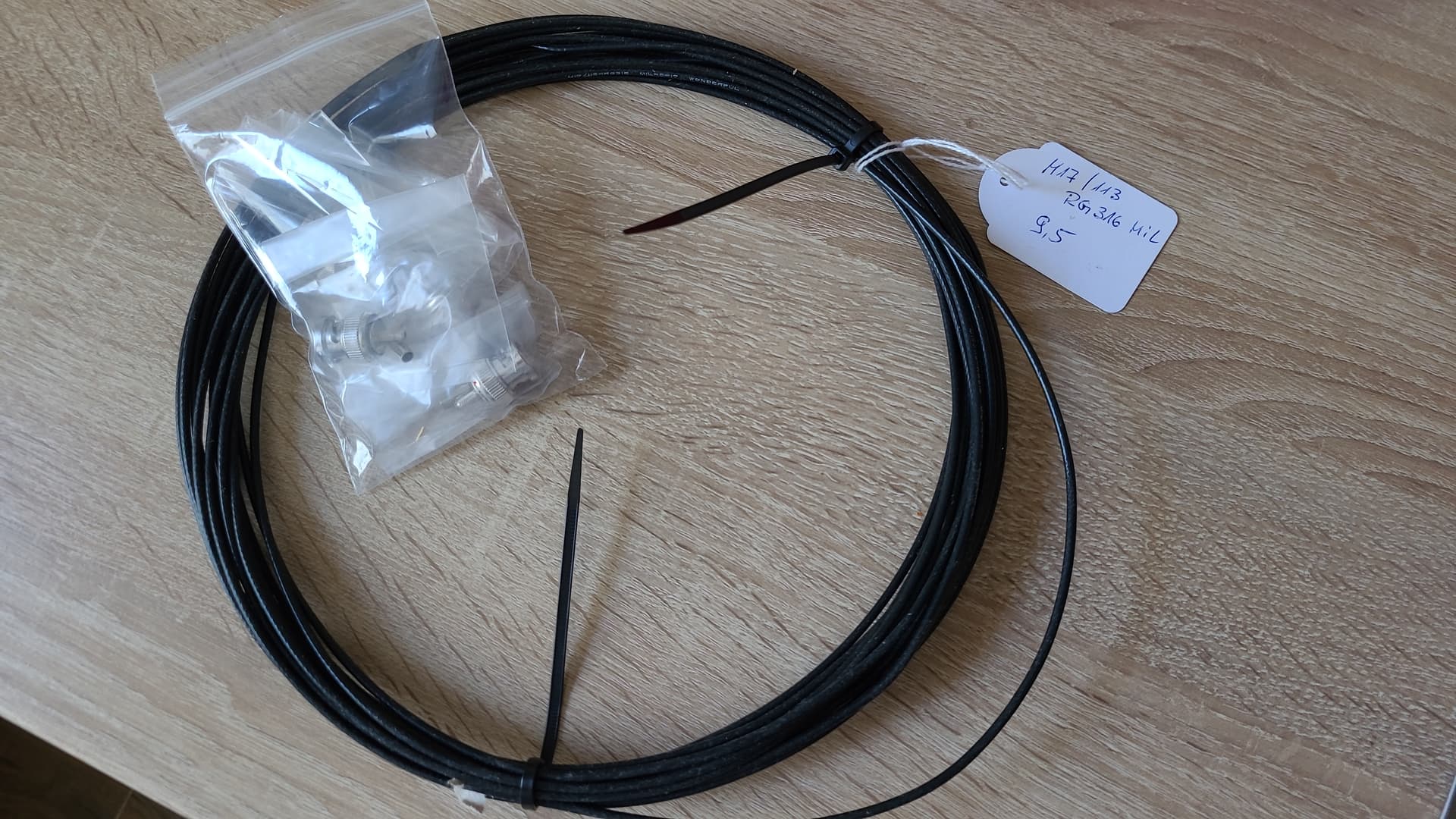

Well, after a very disappointing experience with WIMOs customer service I had to discard the cable that I got (it was broken right around the middle). So I found another shop that has a enormous offer of coax cables.
I am not quite sure if I should take a /C or /U cable. What is better? Pure copper or a steel/copper core? Does this even matter at all?
Does this even matter at all? - NO!
Use whatever you can get quick and locally and get out in the mountains.
73, Heinz
Hi Aleksander,
I’m a bit late to the party but wanted to share my experience with the RG174A/U from Sotabeams.
I bought this MIL-spec coax nearly 4 years ago, did nearly 400 activations with it and it still works like on the first day, even I stepped on it on several occasions.
I know the shop is not local to you, but maybe you need other stuff?
