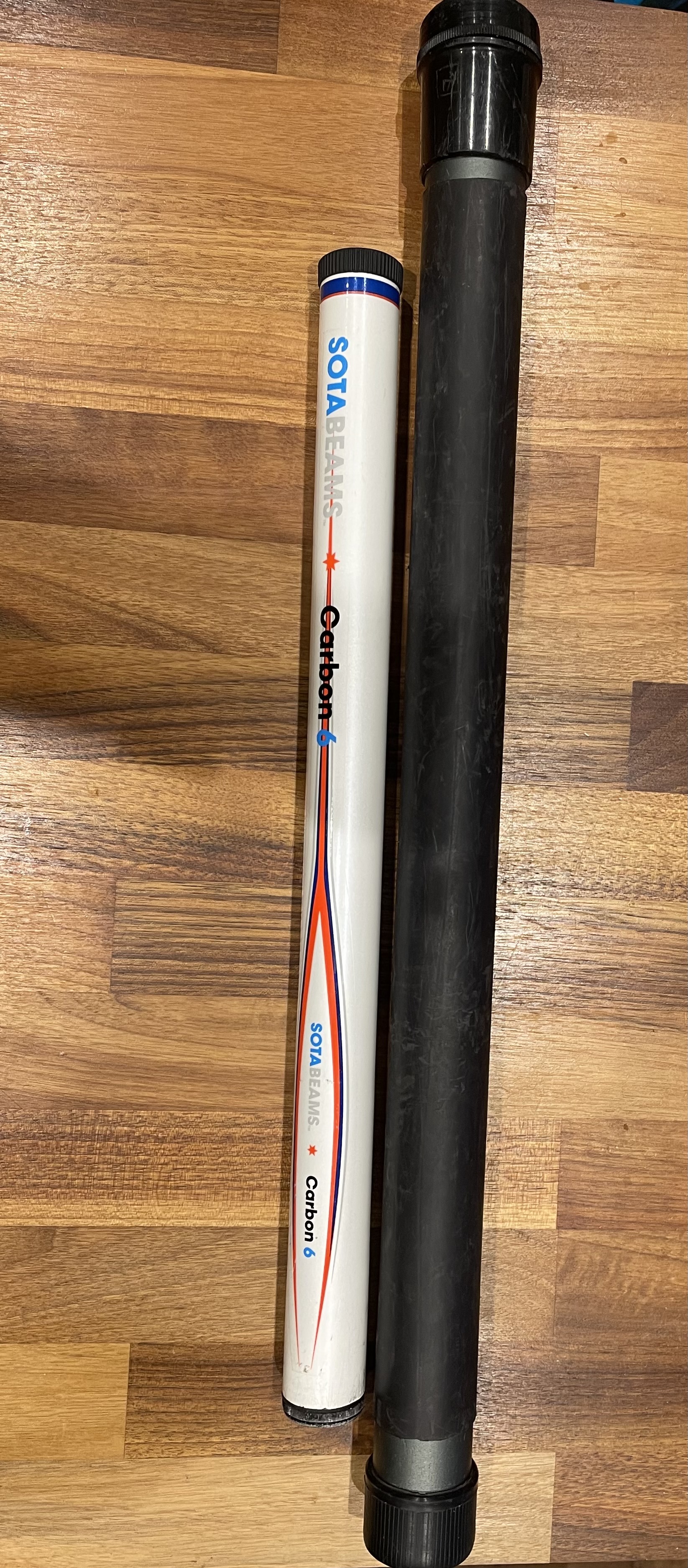

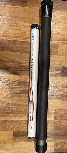

I have the Carbon 6 and the Decathlon “LAKESIDE TELESCOPIC TRAVEL ROD 100 6 M”
The Carbon 6 is my favourite because, as Fraser has said it’s lighter (200g lighter) and packs smaller than the Decathlon pole.
Just something to be aware of, I have 2 different EFHW wires tuned for each pole, as the Carbon pole does effect the SWR in an inverted L’ish configuration. The effect the Carbon pole has on SWR is much greater on my 2m flower pot aerial. I ended up making a bracket to space it 200mm from the pole which seems to work well.
I have photographed them side by side so you can see the difference in packed size.

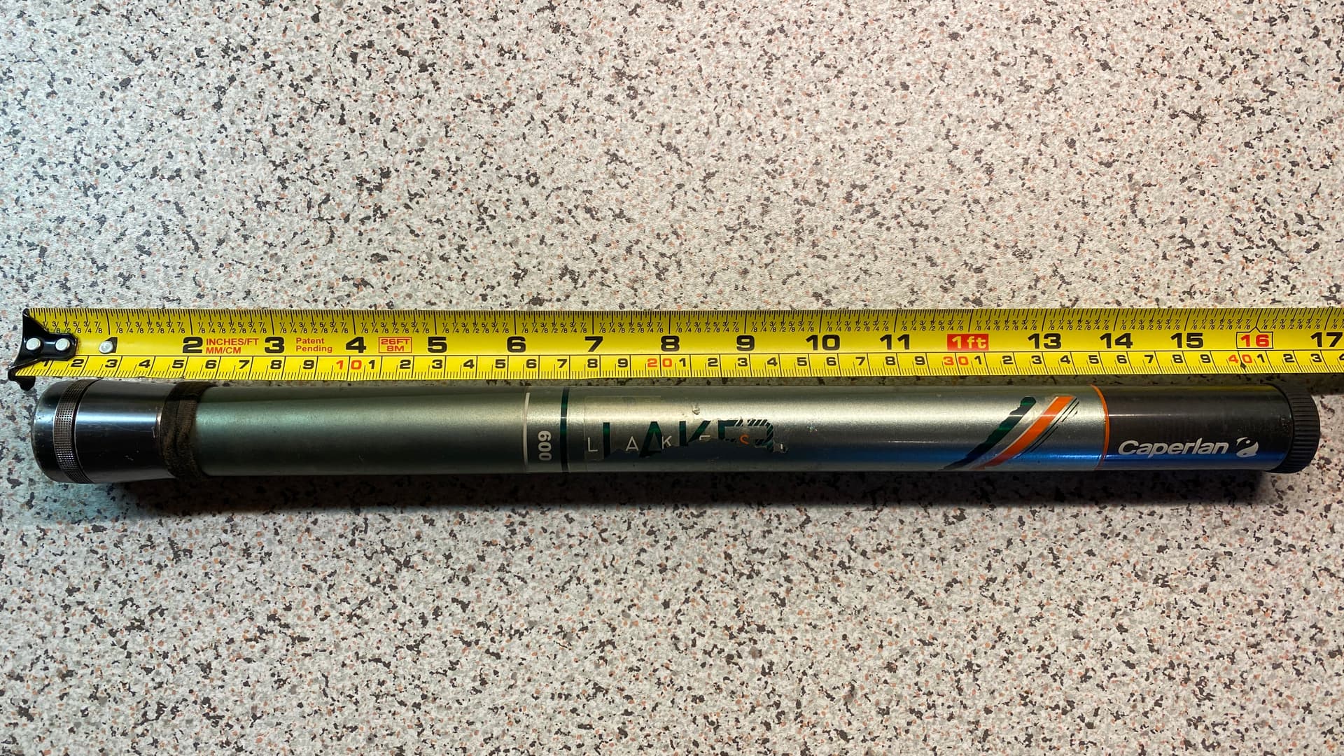

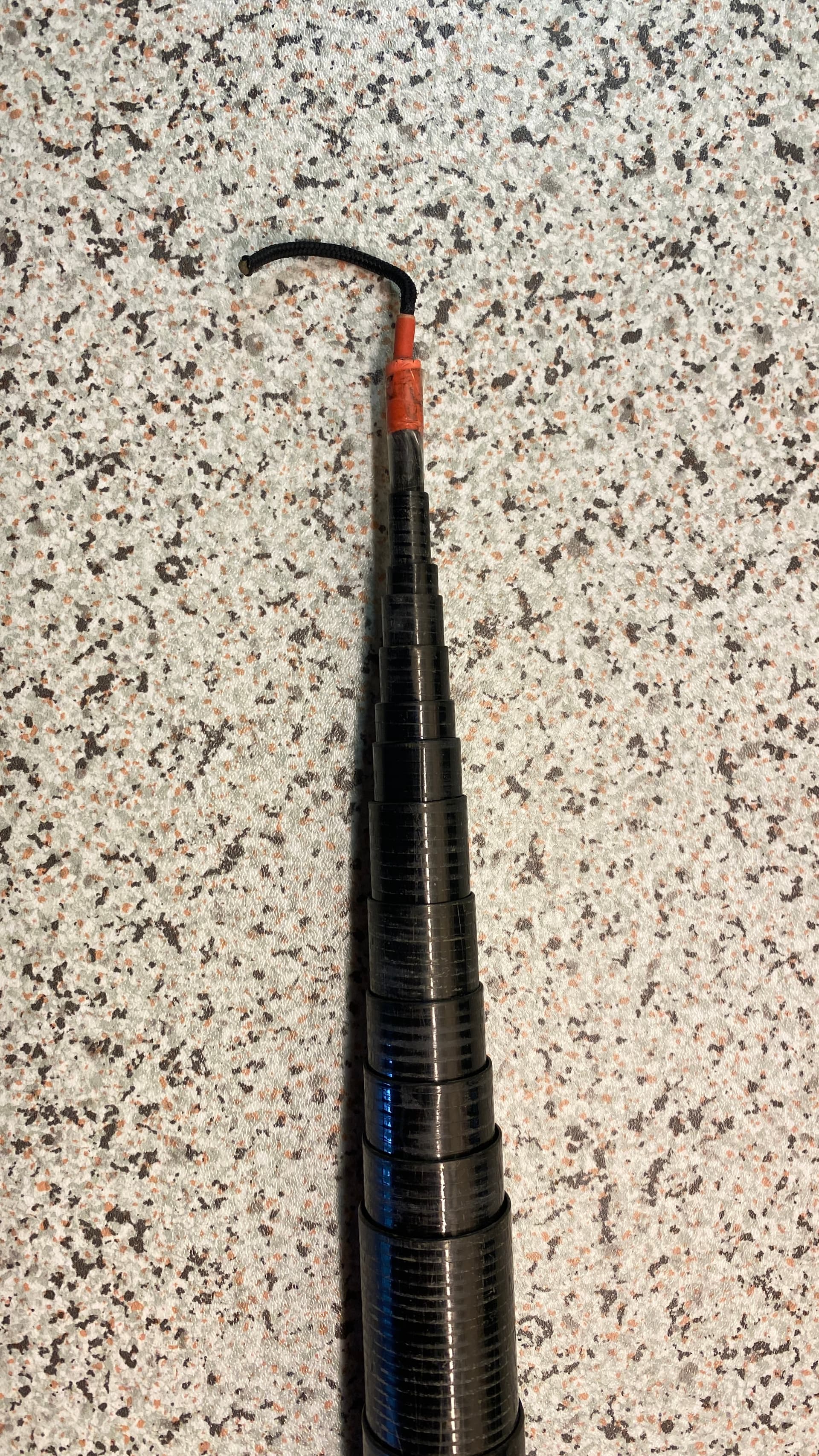

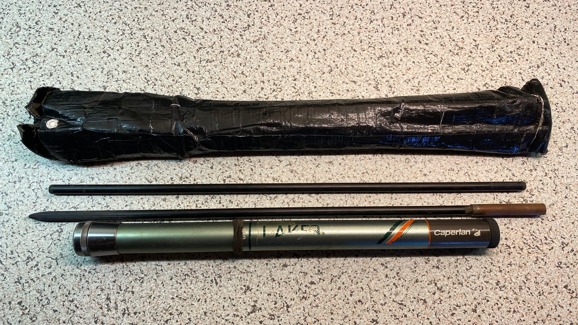

I have a Decathlon Lakeside 600 Carbon Travel pole. This collapses to 41cm and weighs 322g. As Peter says, you must remove the top 2/3 sections as they are very slender. But the remaining 5m mast is significantly more rigid than a similar Decathlon Caperlan 500 Travel. 5m fibreglass mast. The Caperlan 500 Travel weight 372g and collapses to 57cm.
If not, you’ll find out the hard way… I glued a bit of cord into the lower section and covered it with a bit of heat shrink.

I once did an unscientific comparison of the SOTABeams Carbon-6 with Neil @G0WPO on the summit of GW/MW-027 Moel y Golfa.
The only differences we could find was the print on the outside and that the Decathlon end screw cap was made out of metal instead of plastic. I once broke two sections of the Caperlan and replaced them with sections of the carbon-6.

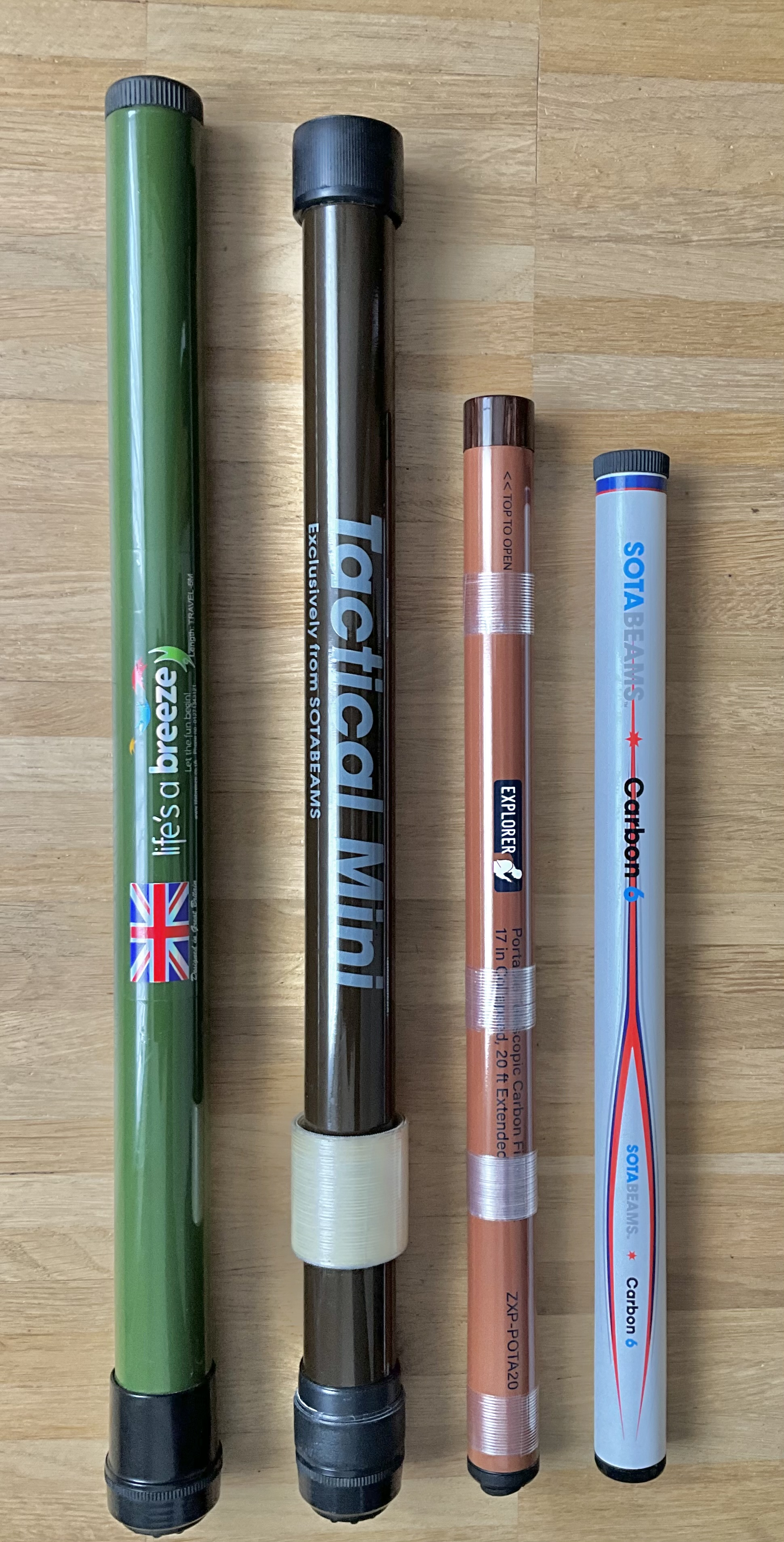

My favorite antenna mast for some time now has been the Explorer 20 (finally a real alternative to the green Life’s a Breeze …).
Weight / Max. usable length / Min. length / Top diameter / Product brand
670g / 5.90m / 57cm / 5mm / Life’s a Breeze
730g / 5.90m / 55cm / 4.6mm / SB Tactical Mini
318g / 6.08m / 45cm / 3.6mm / Explorer 20
306g / 5.10m / 43cm / 3.8mm / SB Carbon 6
Yeah, those old heavy duty fibreglass flagpoles weigh a bit, but every inch is usable to hold a dipole up. I took one on my Aussie trip earlier in the year.

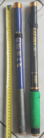

I am using the # 6m poles supplied by the chinese sites, around 20 eur. The characteristics are similar to the mentionned Explorer 20. I had many many activations with these poles. It is my “standard equipment”. My typical antenna is a home made shortened efhw 40/20/10, length around 13 m, made of sotabeam wire, attached at the botton of the last element, installed as a sloper, or as an inverted vee. I´m very satisfied with the quality and durability.
