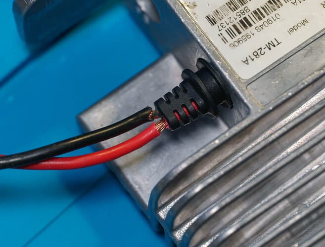

Yes, but it was a SLAB in the top pocket of my rucsac - insulation fracture on the output wires!
You get more time to deal with things with a lead acid; but it ruined a perfectly good backpack :unamused:

That is very unlucky, did the naked wires shorted ?

This happened to my TM-281 …
