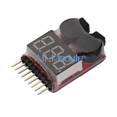

I have a small voltmeter that I will be fitting to the 3d printed case I am making for the LiPo…I don’t trust myself to keep checking the voltage from the 818s menu system while in use.
Use a battery alarm as designed for radio control use - it is connected to the charging/balancing connector. You can set the threshold voltage for each cell and the alarm would wake the dead (mine went off in the bedroom at 0300 - her indoors was less than amused
This is a lot more than I paid but that was years back. As Barry suggests, VERY loud.

The battery alarm is a great tip, I had not realised that such devices existed. I have just ordered one.
