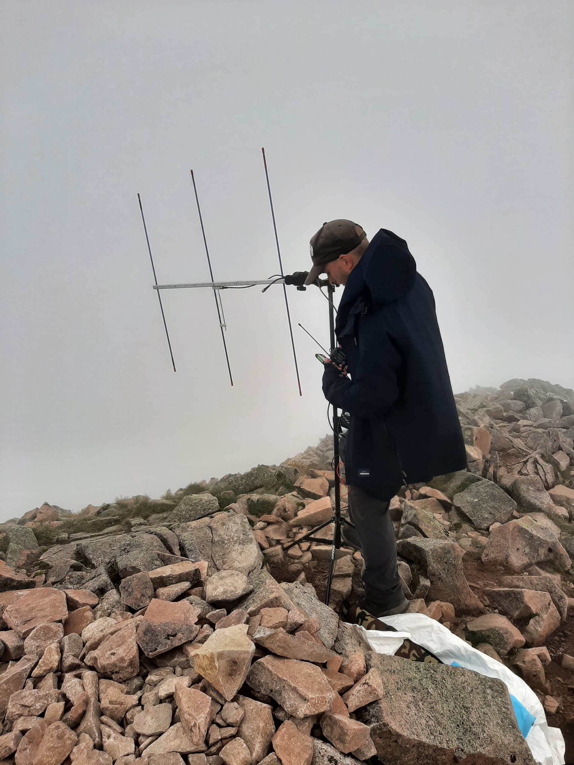

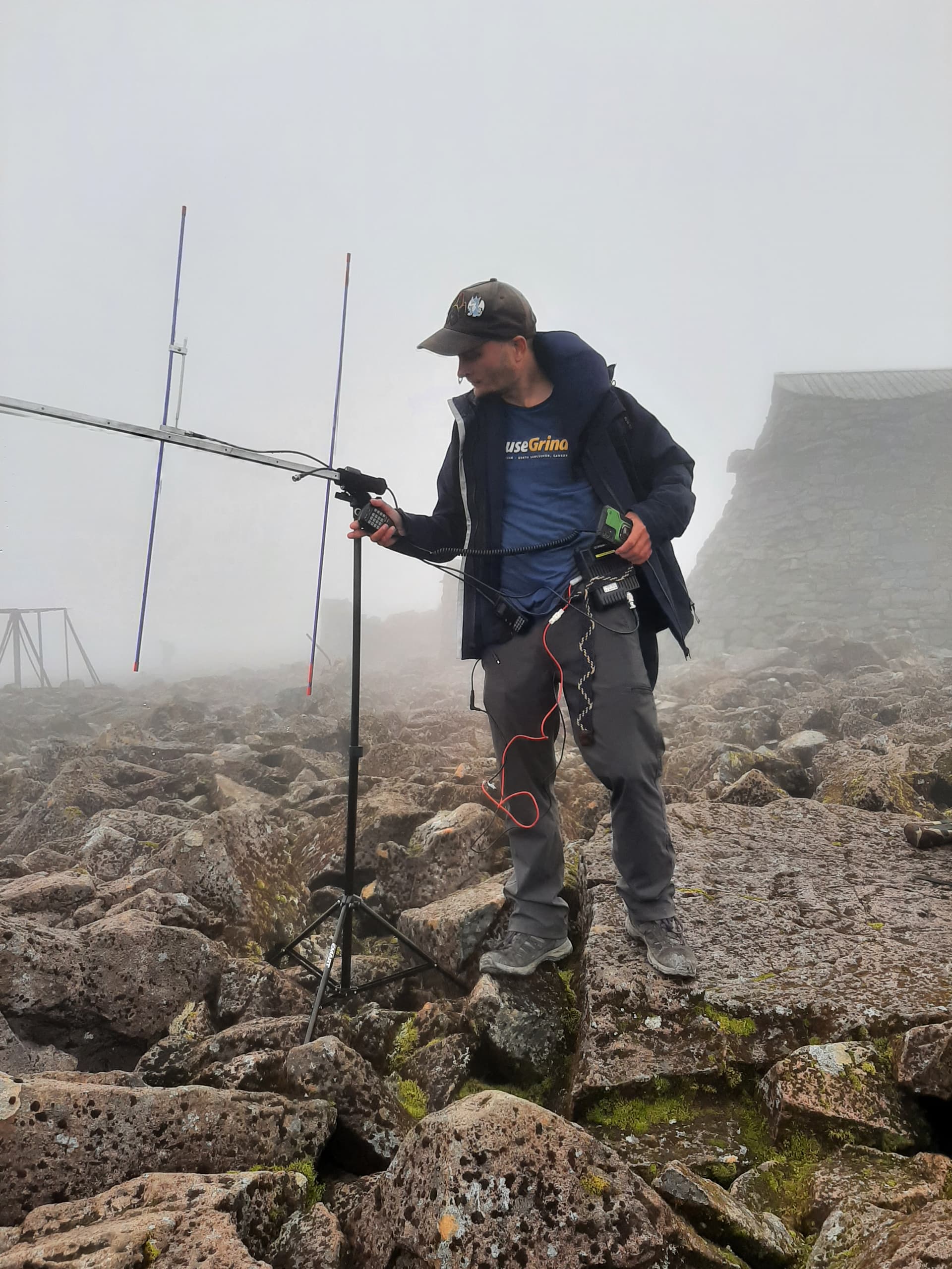

I routinely activate on 2m and I use a yagi for it. Most commonly I use a handheld into the yagi. The yagi I use is an Arrow 2 antenna I got for Christmas a few years back when I thought I’d get into satellites but never really did - but since found great purpose for it in SOTA.
I’ve reached ROI and NI from Wales and the Lake District with it from a handheld, over the Pennines from both with it, reached as far south as south of Bristol from Snowdonia, Lockerbie from Snowdon, and into the Central Belt of Scotland from Ben Nevis and Carn Mor Dearg (albeit the latter with a 25 watt mobile radio tucked into my belt rather than a handheld).
2m is a very fun band to activate on and if you’re going to make a habit of it, I strongly recommend a yagi antenna for maximum fun. One of the additional benefits is the keen chasers who are getting someone reaching them from a summit they rarely if ever hear activated on 2m from their distance. In my opinion it just makes the experience all the more fun as the activator.
I reckon 3-4 elements is the best balance. You get a good directional gain but a wide beam. Too narrow a beam and you’ll have to keep adjusting the antenna to do anything interesting and keep making CQ calls with each adjustment.

@2E0XPQ Ben, this is interesting, but the whole setup in your photos (3-element Yagi + tripod) looks quite large. Does it weigh a lot or take a lot of space when disassembled? Does assembly take a lot of time?
Is this is the Arrow II antenna you’re holding? If yes then it looks like it weighs ~400 grams and requires screwing when assembling. Just curious how this works in practice. Also, what tripod is that and how do you mount that antenna on it? That webpage has a mast mounting bracket for that antenna, but I don’t think that’s what you’re using.

If I’m working like I’m on a schedule the assembly is quite quick. I colour-code the elements with heat shrink so I’m not figuring out which is a director vs. reflector in the field, etc. The tripod and yagi are quite lightweight - in my view anyway. You’ll also need a clamp to attach the boom to the tripod like this. The tripod I use is one of these. The VHF/UHF part of my kit is still overall the lighter of the two between VHF/UHF and HF. It’s quite top heavy and prone to wind so you’ll either want to have the tripod legs anchored between rocks (as in the first photo), or use your foot on the base to keep it steady (as in the second photo).
I’m not the best metric overall for keeping the backpack lightweight for SOTA because nevermind a mountain goat, I’m more like a pack mule up in the mountains.
And yes - you’ve linked the correct antenna. Though the one I have is both 2m and 70cm version, but the photos I’ve posted have only the 2m elements attached.
