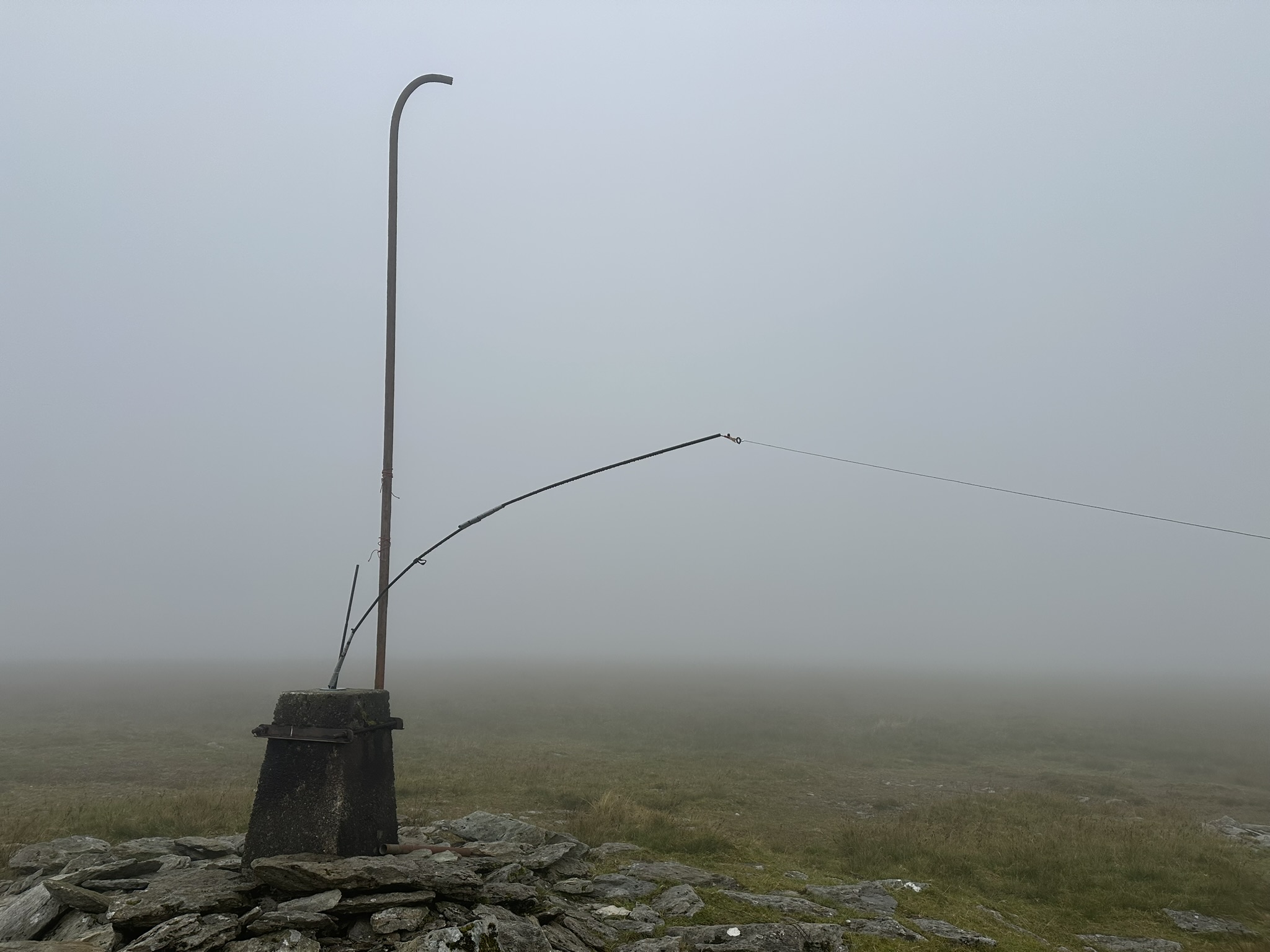

Is the big rusty pole (free antenna support) still stuck in the trig marker?
You should have beebn able to reach the Mullaganish repeater from there. Did you try that?
The rusty pole is still there! My plan was to loop a rope over the top of it and pull my EFHW up, but the wind was so strong I was unable to do that. Neither by throwing nor by trying to use the taped-together sticks from my now defunct Buddistick antenna. So ultimately I did not use the metal pole at all, and ended up with an ugly contraption of a mast stuck into the trig benchmark’s hole. It worked.

I’ve often though that a threaded antenna mount would be a very handy option to screw into the top of the trig point. Lots of them have supposedly unscrewable brass? covers that would provide a handy mount. You’d be adding some mad spanner and a can of wd40 to your pack though.
It’s a good summit for a kite lifted antenna !
