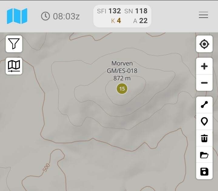

If you have enough internet connection worth checking spaceweather and dxheat when the bands seem odd when you are activating.
kp
(c) NOAA 2022
Current phone/cw activity map
dxheat
(c) DXHeat 2022
KP=5 yesterday is not good! DXheat map for today shows things may be better now.
What I said! sotl.as has sfi, K index etc helpfully at the top of the page now.

Is the SOTLAS SFI header using northern hemisphere data?
The K index for Canberra (VK1) at 0822 UTC is currently at 2.
Andrew VK1AD
Andrew, maybe it changes depending on your QTH when you log in? I think the NOAA one I posted will be for Boulder CO.
EDIT: Yes… it’s says Boulder on the clip I pasted. I should learn to read :blush:
