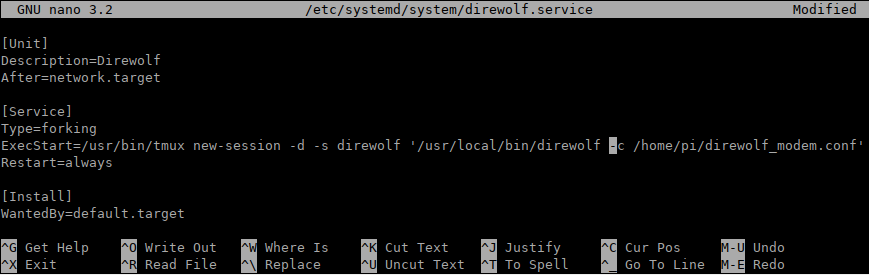

Stumbled upon an issue. It appears direwolf is not auto starting after a Pi reboot.
Also if I have a putty session to the Pi, manually run direwolf command this works, but when I drop the session it stops…
I think I will rebuild the Pi to remove the remains of other installs.
Add an & to the end of the command when starting manually and it should stay running in the background e.g.
direwolf &
Thanks.
Just as your reply landed, I had just finished with this bit of config
Which I think has worked ![]()
Systemd is like Brexit… the gift that keeps on giving ![]()
