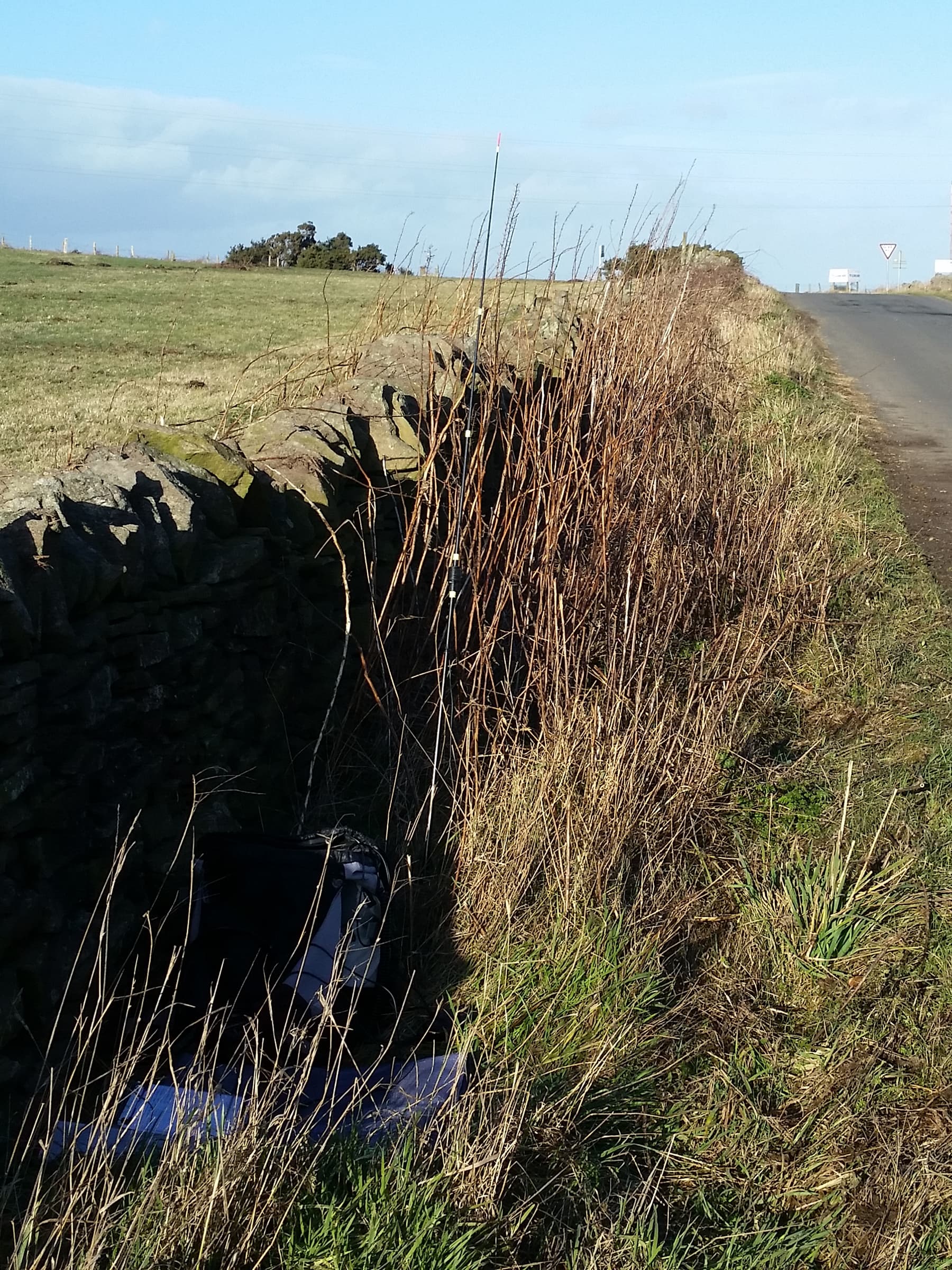

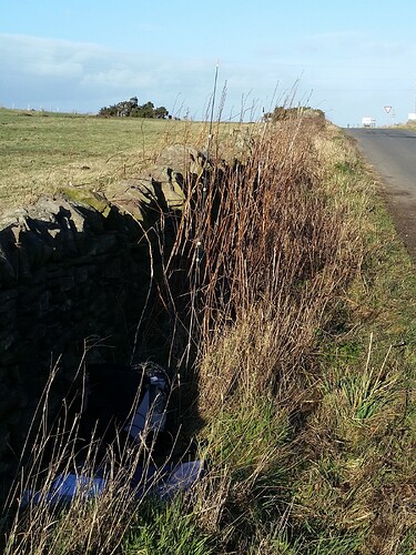

Gutter activation with C710, 10w linear and flowerpot (zoom in to see it) - okay it was a HEMA summit. :joy:
Oddly enough a 2 meter only flower pot works well and with a bit of messing I can do the basic dual band version which both work fairly well but a 70cm only version just didn’t work the match was fine but it was deaf as a post and outward signals suffered so badly that the short rubber duck on the handheld was far superior, I tried reducing choke length increasing it and it was just totally naff . On the dual band version I rapped the choke in insulation tape ( I have to admit cheap stuff) and the SWR went through the roof, much like your heat shrink Mr MM0FMF.
