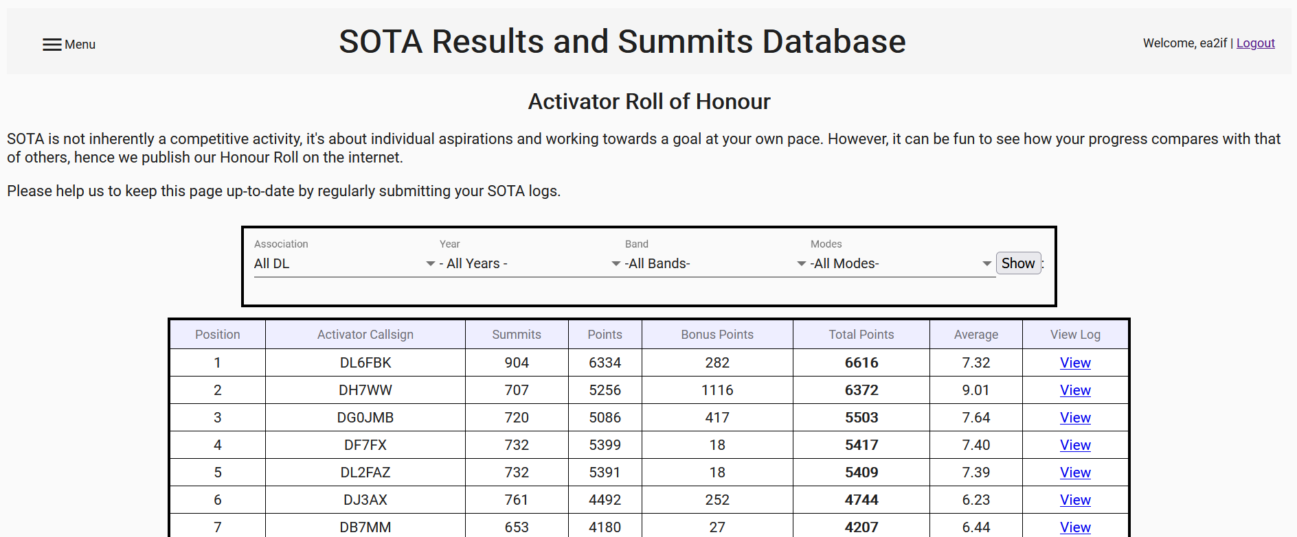

Regarding how to check the activator’s log, it’s very easy. Let me explain it to you:
You enter the SOTAdatabase and get logged on with your SSO credentials.
You go to View Results (3rd from the top of this first menu) and then Activator Roll of Honour (2nd from the top of the second menu):
Now you’ll have to select the association of the activator you are interested in. We don’t know whether Hans DL5RAZ is registered in DL or DM, so we better select ALL DL and click SHOW. This is what you will get:
You can now make a quick search by pushing the Ctrl+F keys and typing DL5RAZ in the text to be searched box. As you advance typing the callsigns matching what you are typing will be highlighted in a green background to you until you’ll get the full callsign you are looking for:
Now you clic on View at the rightmost column of that row and that will take you to the list of all activations logged by that activator, which, as far as I can see it’s only one in the last 12 months:
Now you click on Show log and you’ll be able to see the complete log:
If you now click on Show Who Chased Me, you’ll be able to see all the chaser QSOs logged for that callsign and for that summit that day:
Good luck Allen.
Don’t hesitate to ask me should you have any questions.

Ah Thanks very much both of you. With me just being a chaser I didn’t think I could look at the Activators…Hey it’s clever stuff…The folks who wrote this software have done an excellent job.
