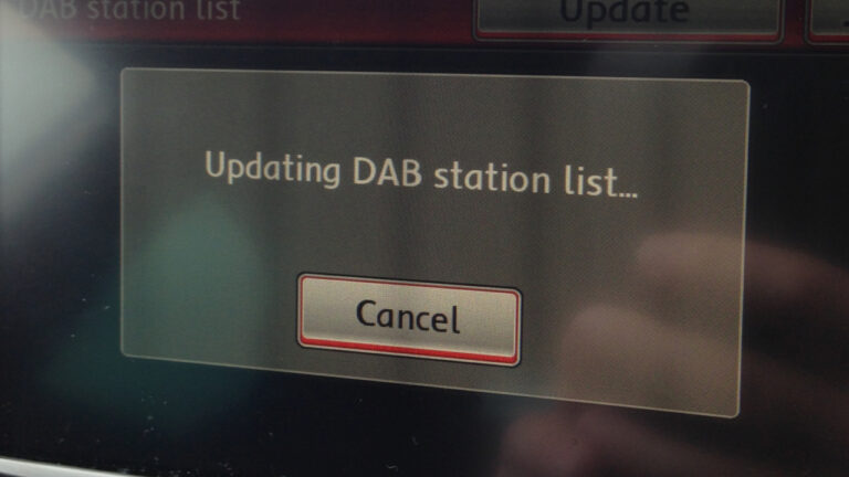

The problems I have with DAB was two things. Technically, you can radiate a lower power signal for the same effective SNR because of the clever modulation and error correction built in to the coding. This means most DAB is broadcast at significantly lower powers than FM. That saves the broadcasters money. But it doesn’t seem to be broadcast at a strong enough level and most DAB receivers seem to be deaf as a post. The downside is as I drive my car around Scotland the DAB signal is in and out but if I switch to FM, I get a usable signal when there is no DAB. Now I’m not talking there’s no DAB up at Cape Wrath but there are areas in and around Edinburgh and Glasgow where there’s no DAB. Flip to FM and I have a fabulous end-stop FM stereo signal. And we’re talking the same experience on a pair of cars described as “executive coupe” and “executive sedan” not entry level super-mini hatchbacks. The second problem is the total and complete greed of the broadcasters to fit as many stations as possible into the DAB channel bandwidth. This was done by reducing the bitrate and transmitting in mono. Couple low bitrate to MP2’s poor performance at low bitrates and you have something that sounds dire and significantly inferior to the FM signal it’s meant to replace. Time after time when people have complained that DAB sounds terrible, politicians and broadcasters have dismissed those complainst as coming from snobs and “hey never mind the quality look at the sheer choice”. Except there is no choice since Bauer Media bought up all the local commercial stations and have them all transmitting the same program and only the advert breaks are different.
To keep the cost down, many DAB receivers are hard coded. DAB is a software system but selling DAB receivers that can be OTA upgraded or capable for future enhancements is damnded pricey compared to a hardcoded solution. So We had a sub-standard CODEC (MP2) force on us and greedy broadcasters trying to cram a quart into a pint pot and then were told when we complained that it’s wonderful. DAB+ is a big improvement. But FM still sounds better.
Do a simple test, listen to The Archers on FM and then on DAB. On FM there is ambience and spatial sense of a soundstage with voices and sound FX placeable on a left to right basis. And on DAB it sounds dead and lifeless… because of mono and too low a bitrate.
