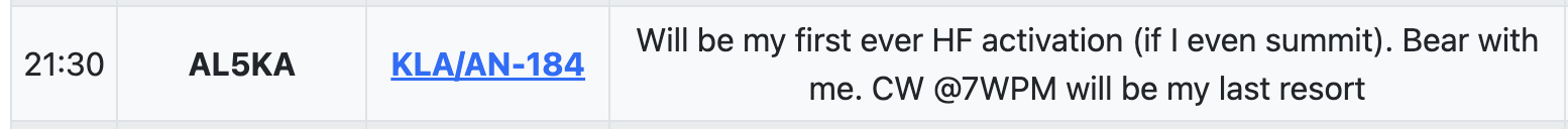

I was literally WAITING for you to get on summit so I could chase you. You never posted a spot!
SOTA 101: if you don’t post a spot, you won’t make QSOs.
Please post a spot next time.
P.S. I saw your alert. I don’t think taking a bear with you is wise. An Alaska thing? :joy:
Haha on the bear joke.
So I had no idea spotting was a thing. I posted the alert, then I’m supposed to post a spot when I’m actually on the summit?
Dang it Robert, I wish you lived closer so we could do some activations together and I could show you the ropes. The Internet is a lousy Elmer.
Yes, you need to spot yourself as soon as you are QRV. Did you have cell service on the summit? If not we can talk about other ways of getting you spotted.

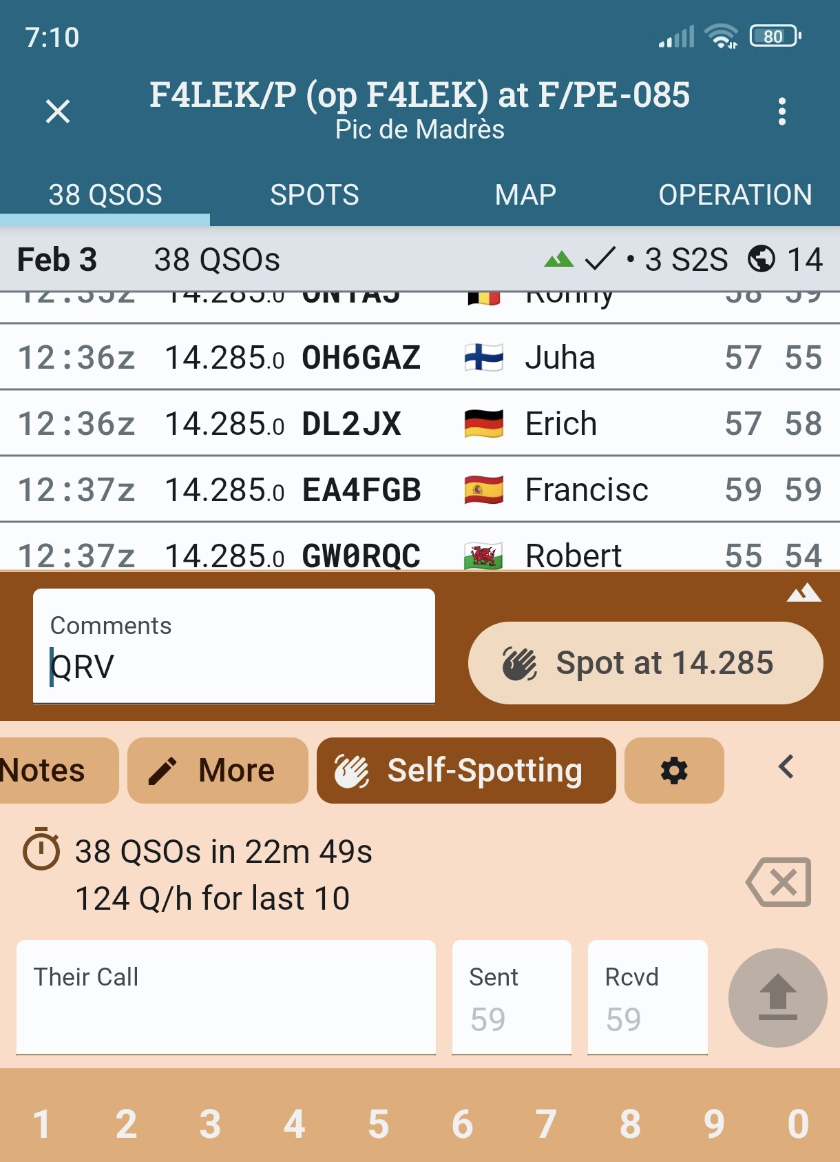

Download the app ham2k https://play.google.com/store/apps/details?id=com.ham2k.polo.beta&referrer=utm_source%3Dgoogle%26utm_medium%3Dorganic%26utm_term%3Dham2k+polo&pcampaignid=APPU_1_4NquZ96AO8mF7M8Plc-jsAg
Its a very nice app for logging contact, especially for sota. If you have cell service, you will also be able to link your sotawatch account and spot yourself directly from the app, in one click.
Once your sotawatch account is linked, you just have to start a “new sota operation”. Then on the logging page, you set your frequency and you scroll the toolbar on the right to access selfspot function:
In the “SPOTS” tab, above, you can check in the spot list if your spot has been received or not. You can also see other activators spots (again, only if you have 4g service).
