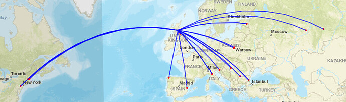

RBN 15m

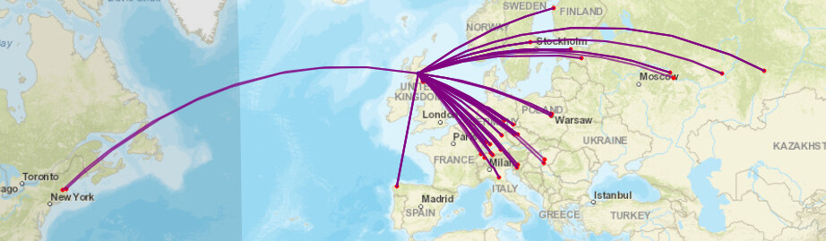

RBN 17m

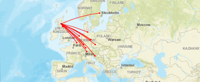

RBN 20m

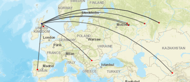

RBN 30m

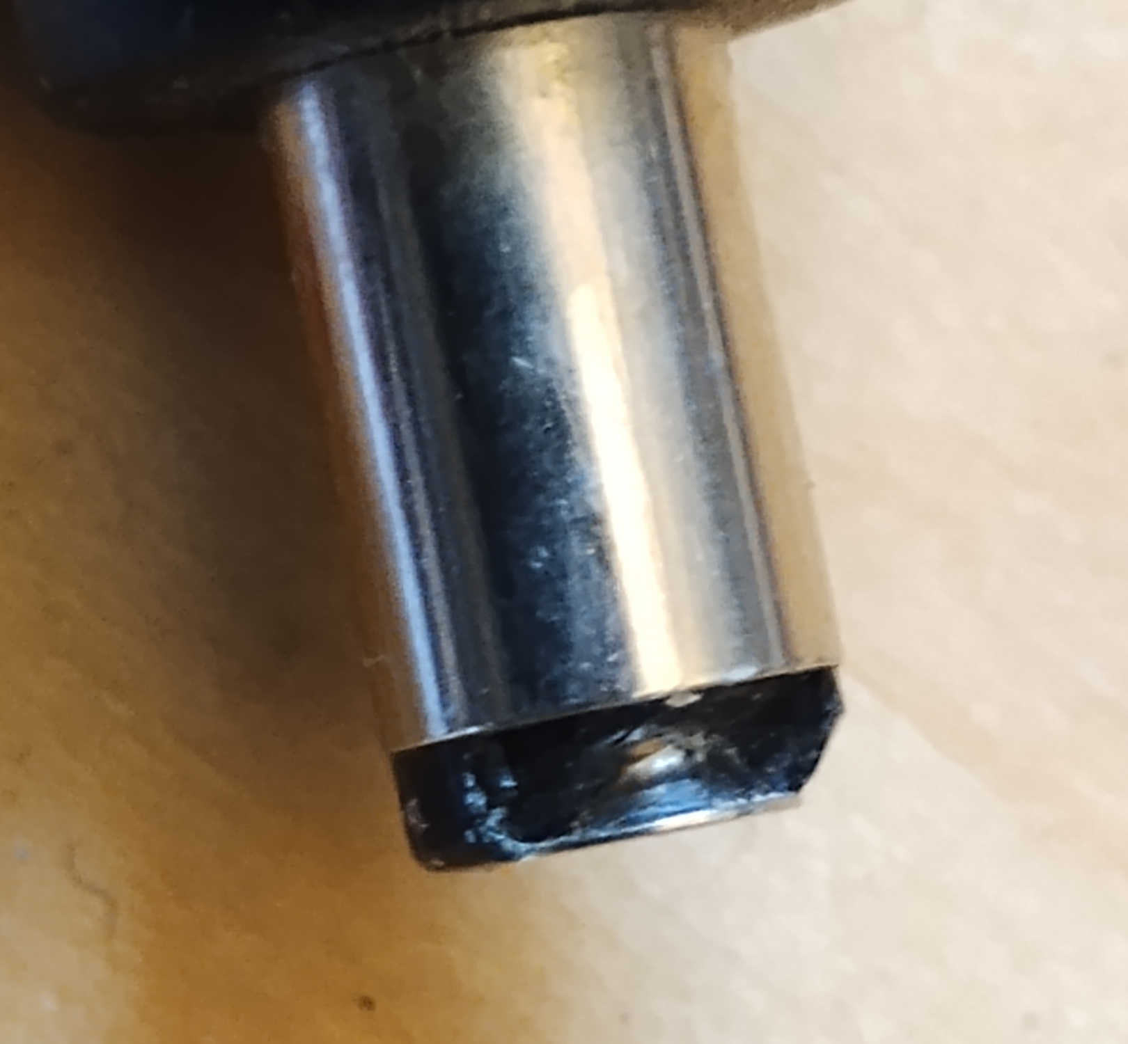

Here is the original emergency pack.
No fuse but it lives in a ziploc bag till needed. So all connections covered from external influence.
What I didn’t notice was the plug was damaged. Well being cheap I recovered it from a dead wall-wart.
If you look carefully, as I did after the smoke issue, you can see a tiny bit of plastic is missing so both centre positive and outer negative are exposed. We know what can happen next don’t we children? Yes the charged pack was disconnected from the charger and placed on the shack bench where junk on the bench shorted them out. I wouldn’t believe it could happen till the PVC wire got hot enough to start to melt and emit smoke and nasty smells. Pulled away and apart from missing insulation where it melted no damage, squeaky bottom issues excepted.
Hence BMS and some homebrew double-insulation work.
How me and Mrs. LLD laughed when I explained why there was a burning smell! :blush:
