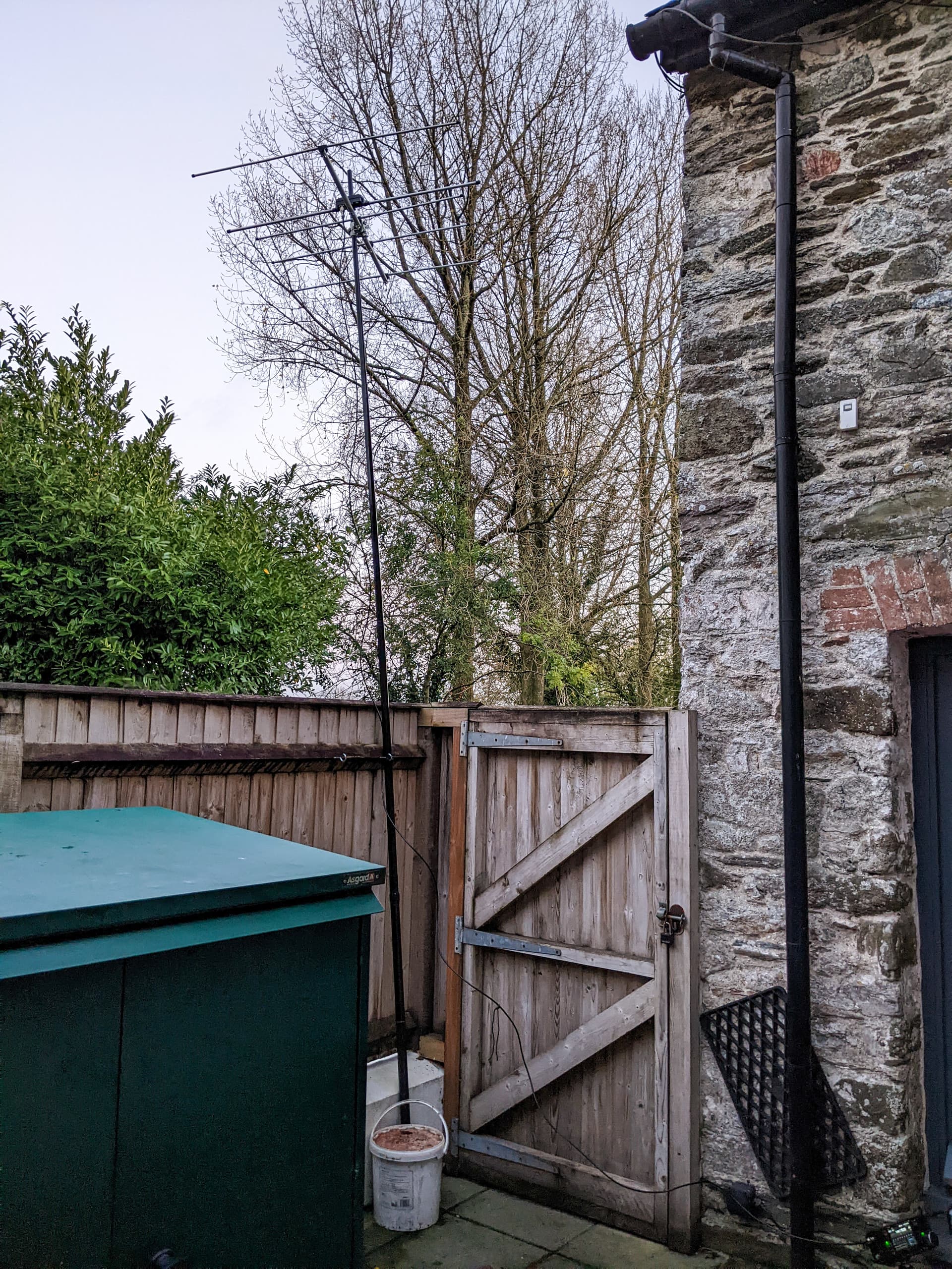

I’ve done a quick test this evening to check if I might be able to reach Guernsey. The problem is I can’t use my main mast as there is a large house on the other side of the road which is blocking the path. So I erected a pole at the back of the house with a 5 element Yagi about 4m up looking in the right direction.

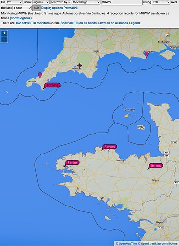

Using FT8 on 2m I managed a QSO with F0EYI who is in line with Guernsey on the French mainland. However, it was a bit of a struggle and each FT8 message was repeated 2 or 3 times before we could complete the QSO. From his QRZ page F0EYI has a long multi-element Yagi for 2m so assuming it was turned towards me suggests it wasn’t any weakness at his end. In the map below they are the station nearest Rennes.
I have a 10 element Yagi and will try that tomorrow. Fingers crossed!
