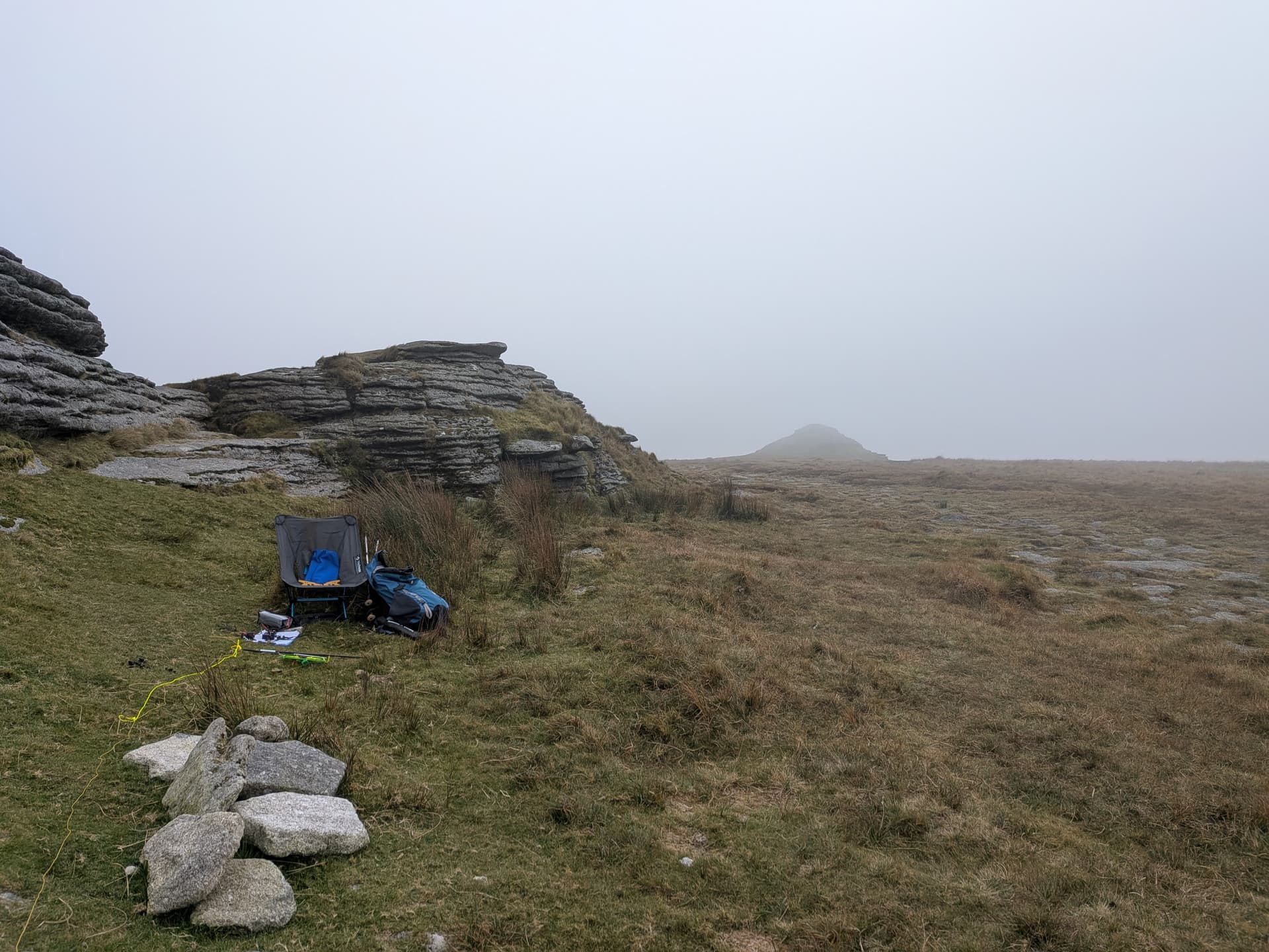

I normally set up on the east side of the summit but today the wind was coming from the east so I found a sheltered spot on the west side. There was a moderate breeze blowing but it did nothing to clear the air - I was in low cloud the whole time.

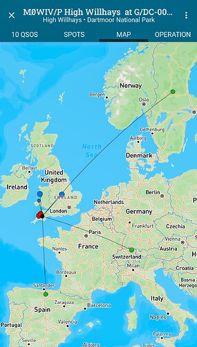

I than had two difficult QSOs with operators in West Wales who gave me reports like 32. This was followed by a much clearer QSO with Richard M1AOB.
A change to 20m brought 3 more QSOs with good reports and no comments about the audio. I can only assume there might have been some sort of propagation anomaly around the W stations.
