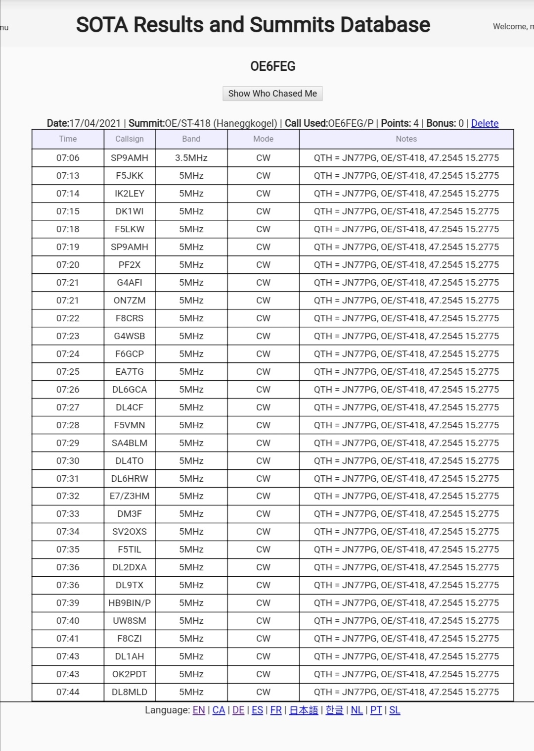

I’m finding that an antenna actually resonant on 60m makes a big difference. Mine is only 27.3m long, so not as much trouble as a 40m wire for 80m and above; although mine still tunes up on 80m (just). Here’s my log from a recent activation on the Haneggkogel:
They were mostly good reports with lots of 599s.
Whenever there is a fence (or similar supports) on the summit and plenty of room, I will happily take along my 60m antenna. I also take my 10m pole for a little bit extra elevation. It’s probably not necessary, but it’s all good exercise.
